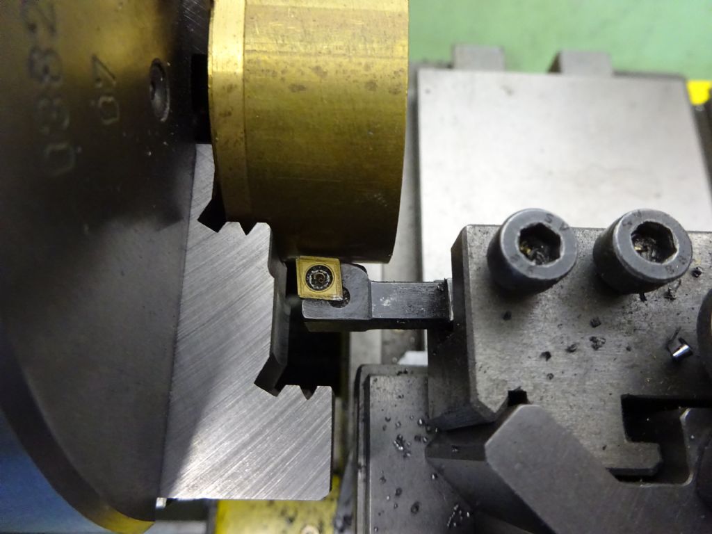

      I have a piece of work which I need to face both ends, then externally turn to various diameters and finally bore. Obviously all needs to be concentric etc.
      So far, using the 4-jaw chuck, I have faced one end and then turned the adjacent diameter at that end. I have then turned the work end for end and set it up using the middle step on the reversed chuck jaws, and then faced the other end. I can't hold it with the outer step because the jaws meet in the middle before they contact the work.
      Now, I need to turn down a length of 26mm from the right hand face without moving the work in the chuck, but the left hand edge of the 26mm section is about 3mm under the outer step of the chuck jaws. Later I will need to turn down a section about 5mm wide which will be entirely under the outer step. It seems to me that I need a bent tool capable of getting at the work under the jaws. Alternatively, I have wondered about using something like a SCLCL tool parallel to the lathe axis rather than at 90 deg to the axis and cutting towards the headstock rather like facing at 90 degrees to a normal face.

          How about producing the bore first and then using centres or making a mandrell to locate it for turning the ODs.
          #224433
            Run lathe backwards and use a boring bar on the rear edge.
            Do you have soft jaws? if so machine to hold by the first turned side ond only deep enough that they don't get in the way of the second cut
            Or just use a L/H facing tool like I did to turn the OD of this part, tool shank along axis of lathe
            SCLCL as you suggest
            sclcl

                Plus one for the left hand tool.

                  Left hand tool. I tried this with a high carbon steel home-made tool. It did work after a fashion, but the resultant surface was not very good which suggests that probably my angles & cutting point were wrong, yet it would seem that I was indeed on the right lines. As it happens, I don't have a SCLCL tool, or indeed any other suitable left hand knife type tool so couldn't try it, but it does seem from Jason & Chris to be a goer so I will shortly be looking for a suitable tool for future use.
