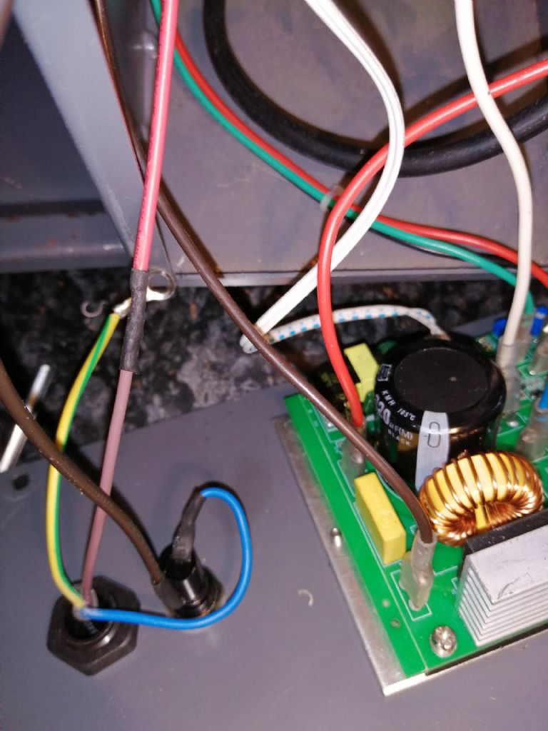

      The motor on my Chinese lathe has stopped working. All lights come on etc. but the motor fails to turn . I am assuming that either the motor or the control board is at fault. I have checked all wiring etc. for any loose connections and also the fuse.
      My electical knowledge is limited but my understanding is that the dc motor should run from a 12v battery. It is a normal brushed motor . Could anyone confirm, if this is the case and can i just connect the two wires from the motor to a suitable battery? i have 6V and 12 V motorcycle batteries available.
      I have tried to attach photograhs but not sure if that worked
      Thanks for any help

                  #494015
                  Gerard O’Toole
                    @gerardotoole60348
                    Another thing I noticed, the fuse is on the neutral wire rather than the live. Surely this is not correct?
                    Again a photograph is here:-
                    https://photos.app.goo.gl/L3EUa3MkUr8131hv5
                    gerard

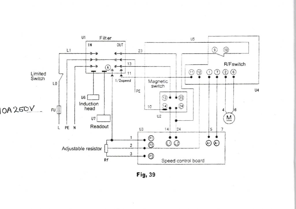

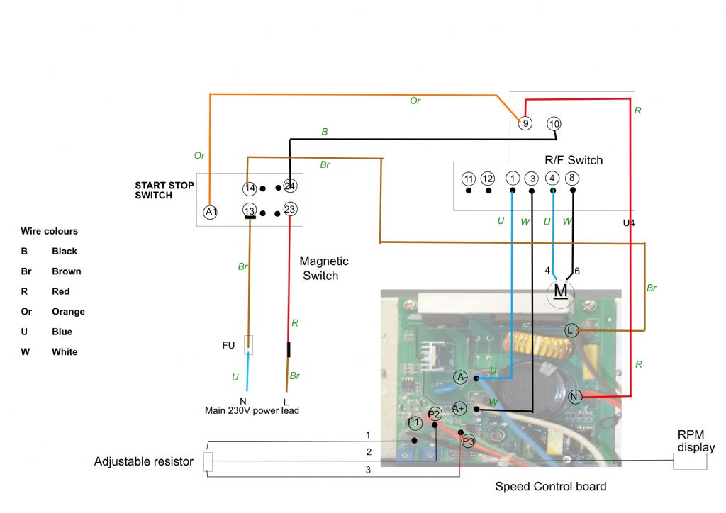

                            #495898
                            Gerard O’Toole
                              @gerardotoole60348
                              Sorry for reopening this thread,
                              I have a replacement board, identical to the old one, and i am about to fit it.
                              As I mentioned, the fuse is fitted to the neutral wire instead of the live wire and I know that needs to be changed..
                              But also, the live wire is going to the "N" pin on the board and the neutral wire is going to the "L" terminal. . I have traced the wiring and is shown in this diagramwiringdiagram_ actual.jpg
                              But the lathe worked okay with the Live and Neutral wire connected wrongly. Would that be possible that the board would work with the live and neutral wire reversed? And do i risk causing more damage 'correcting ' this?
                              The manual shows the wiring diagram as this
                              Thanks for any help.
                              Sorry for posting so many photographs
                              Gerard

                                #654666
                                Peter Jones
                                  @peterjones49190
                                  To let ypou know the Chinese milling and lathe of this type actually wire the L and N the other way round on the milling machine here is the same (L on N terminal and N on the L Terminal) which actually matches the wiring diagram. I though the wring diagram was wrong until I check what was really connected, it will work and is supplied by the factory that way round. I assume that some had printed the PCB's wrongly, but instead of throwing them away, they just altered the diagram to match.
                                  #654725
                                  Robert Atkinson 2
                                    @robertatkinson2
                                    Regardless of how the board is marked or wired, it is most important that the fuse and main switch are in the live of the incoming connection.
                                    This is because if they are in the neutral and the fuse blows or the switch is off the machine will appear dead but all the internal wiring up to the fuse or switch will be live and waiting to shock anyone working on the machine.
                                    Robert.
                                    #654738
                                      Posted by Peter Jones on 01/08/2023 10:04:07:
                                      It works either way round because the input is an alternating current. In terms of electrical function there is no difference between Live and Neutral, because they operate as a pair. But don't do it!
                                      The important difference is safety.
                                      Electricity suppliers make the system safer by ensuring that one wire is earthed, rendering it Neutral, that is at the same potential as anyone on the ground who touches it. No shock.
                                      The other wire remains 'Live' and is dangerous. It coming loose and touching the metal chassis would turn the equipment into a widow-maker, except all exterior metalwork should be connected to earth, which instantly blows the fuse.
                                      Fusing the neutral wire stops electrical fires, but it doesn't disconnect the live side, so the equipment is still a shock hazard. It fails dangerous. Then Mr Innocent opens the box and pokes around inside, wrongly assuming that the equipment has failed safe, and it isn't. To be safe the fuse must be fitted to the live wire, not the neutral.
                                      General rule is to always unplug electrical equipment before going inside. Don't trust fuses at all! If essential to debug a live circuit, assume the worst and take every precaution. A few electricians are killed every year despite their training. Even when you understand, it's easy to make a mistake.
