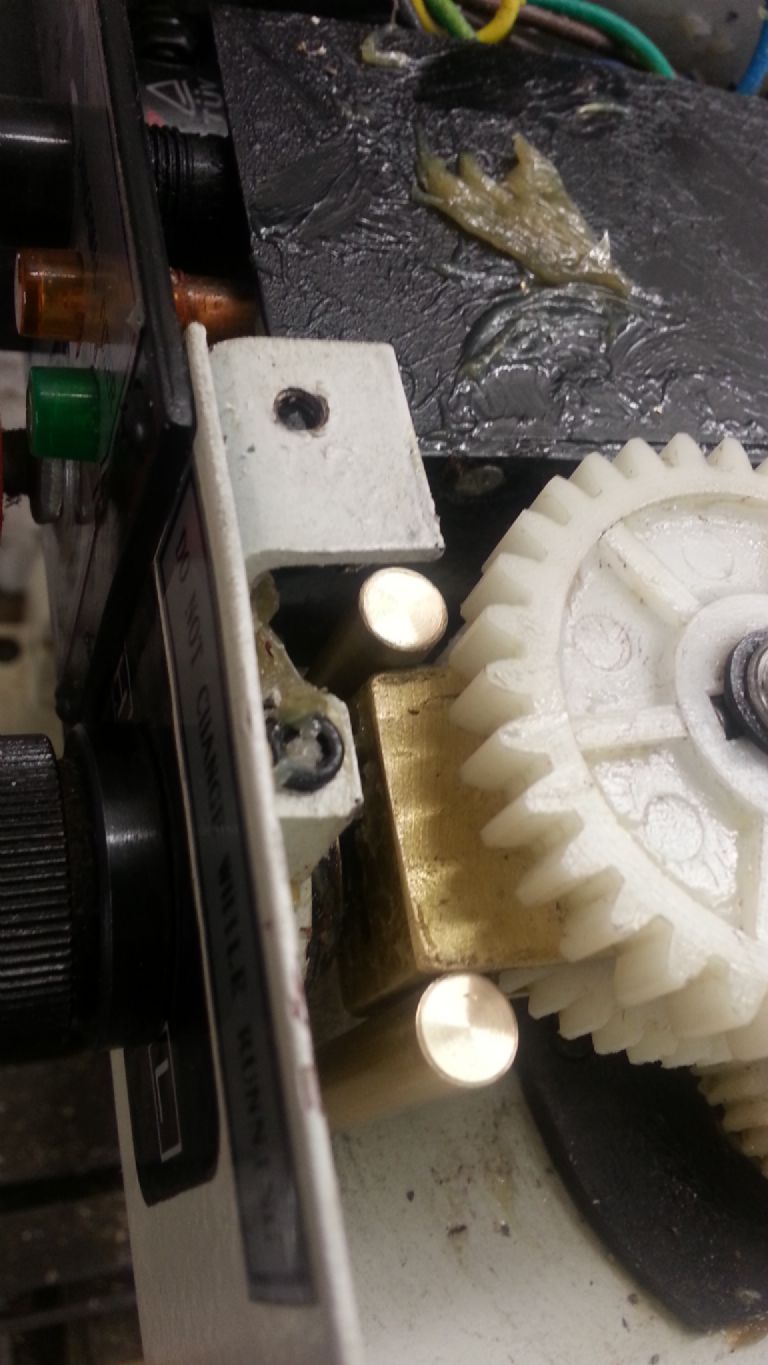

      The gear changer is now fixed!
      After putting in the cloned Brass gear fork I was some what horrified buy the amount of swing that was involved with this system…on closer inspection I believe this to be a major player in why my gears stripped.
      Instead of wanting to raise and lower the fork tries to pivot round the layshaft…so I added two brass guide pillars to stop it swinging and now the gear change is far more positive …so very happy about that. I Also got in some Ali blocks to make bearing ends for the X and Y axis …lets face it they are pretty horrid on the stock machine!
      Oh and for ref my X1 is an Axminster White series.

          Thanks Gray, Okay the photos loaded in the reverse order was hoping for but you get the idea!,
          Top photo shows the guide posts holding the gear change fork
          second photo shows the position of these posts minus the fork/gear cluster
          Third photo is the gear fork clone, there is a notch in the original that seems to serve no purpose on this machine so I left it off.. you can see the granular texture to the original broken fork.

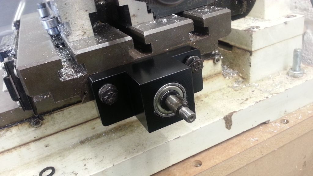

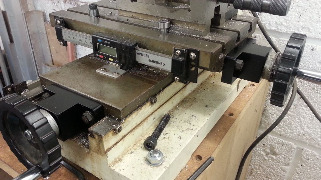

              20140413_191815.jpgHi All! Spent yesterday making ballraced bearing blocks for the X and Y axis, worked out really nicely , Id highly recommend this Mod for anyone who hasn't already attempted it
              Mine were made from 6082 T6 Ali and bored out to take 22mm skate bearings.20140413_121241.jpg

                I should point out these are based on the info found in the Mikes workshop link I posted earlier,
                I also have drawings if they would be any use to anyone.

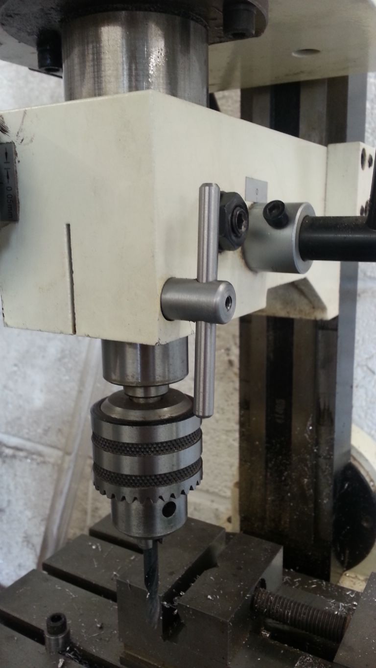

                Machined up a Quill lock T-bar today as well.

                  First thing I did with my CMD10 was fit 16x8x5 ballraces and like Gray I used the original blocks which I bored from each end (snug fit on a mandrel). I still used a tubular spacer but on the shaft between the races, I fine tuned the spacer length to get the right preload on the bearings.
                  Another big improvement I made was to relocate the Z axis feedscrew close to the RH front corner of the column because the standard 'L' shaped cast nut is an abomination! A pair of ballraces in a small housing sit on a small plate fixed to the top of the column. Z travel is now much more controllable.

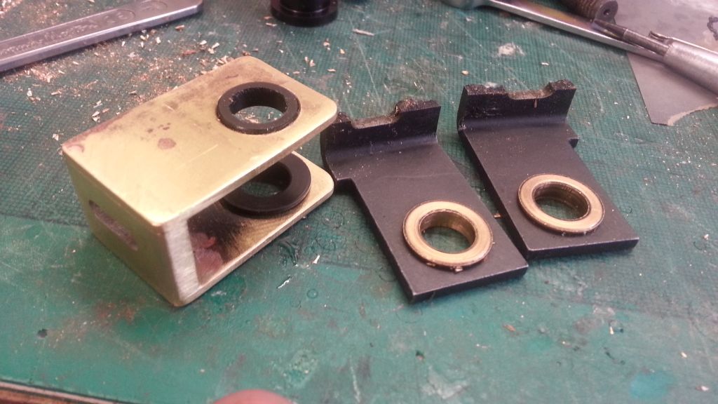

                                    Posted by Graham Meek on 13/04/2014 20:06:27:A sleeve was turned up to go between the two bearings and this is retained with Loctite 603. Just for added security I dowelled the sleeve with a 1.5 mm diameter pin.
                                    For the benefit of a novice, could someone take the trouble to explain why (and how) this was done?
