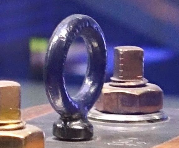

      I want to make a lifting eye, the diameter of the ring is about 1/4".
      I can't think where to get a ring of that sort of size that I could solder to a stem and I don't think I could bend a bar neatly enough to form the ring.
      Any suggestions, please?

          What is the weight of the object you are attempting to lift? is 1/4" the ID of the 'eye' or the thickness ? I personally wouldn't 'solder' it to a stem, far better to braze or weld it, better still have a look on eBay there's bound to be a supplier for that size for a very reasonable price.

            Hi Dave is the section of the ring 1/4 inch or the ring diameter of the ring 1/4 inch? if the section of the ring is 1/4 inch these are available for about £3 to £4 and they are called dynamo eye bolts. If it is the small type I would make it from a piece of flat steel turn the thread and collar then rough mill the ring on a rotary table and file and Dremmell to finish the ring.

              Never tried doing this, and I'm not sure which dimension is 1/4" but how about one link of a chain stretched from oval to round with a tapered punch?

                  Apologies for not being clearer with the dimensions.
                  I'm not worried about loading capability as it will be 'decorative'. Internal diameter of eye will be 1/4". Bar thickness commensurate with diameter to 'look the part'.
                  David, I tried using a screw eye and fitting a 'washer' to the bottom of the eye to hide the join, but didn't like the result. Your method is one that I originally thought about doing it and will probably end up doing it that way.
                  Good suggestion, George, but unfortunately they are too large.
                  The Emerald Isle
                  #399104
                    Assuming it's 1/4" diameter, presumably this is for a model, not a working lifting eye? If so, perhaps copper wire wrapped round a mandrel, cut to butt the ends, and then soldered to a brass bolt. Paint to disguise construction.
                    Not sure making a real lifting eye is a good idea in a home-workshop. As they have to be strong and are often safety critical, they're made out of suitably specified steel by drop forging a billet. No drilling, bending or welding and the steel is strengthened by the blow. Not a process many of us are equipped to do!

                      I'd just wrap some wire or rod around something suitable, snip off a "Ring" and solder to the "bolt"
                      Or just drill a hole in some flat bar and round over the edges, turn and thread the shank did these eye bolts that way but that is why you get me to make your modelswink 2

                          Why not make from 1/2" round bar, milled both sides flat equally to 1/8" thick on the centreline, drill a 1/4" crosshole and radius countersink both sides, then file or bench grind the ring profile? That's what I've done a few times.

                              In this video Joe shows how he makes decorative chain , you could use a similar approach to make the rings for your dummy lifting eye by ising a piece if 1/4 OD rOd as a mandrel – it’s just a close wound spring or coil as you will see .. Some suitably sized screws with the heads turned to the required profile are easy to do then soft solder together . A simple alignment jig would also be beneficial to hold the parts in the right position for soldering . If you don’t mind having the ring with a square or rectangle cross section you could use small spring washers after bending the offset out so the open ends lign up .

                                          A bit of wire from a wire coat hanger would be about right for an eye with a 1/4" hole, and it's easy to bend. I have some copper wire in 8 and 10 SWG, and 3/16", and that would be my choice, but I'm a little far away. I,v got a pair similar size on a model generator.
