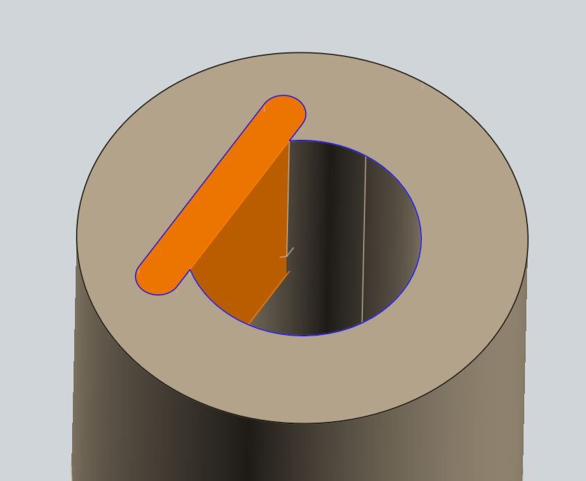

      Hello All,
      Pretty simple question (I hope) – how do I machine this kind of hole into the end of bar? I have a lathe with a vertical slide so I can do the odd bit of light milling but do not own a stand alone milling machine. It is to go on a motor shaft.
      Thanks

          Its not possible to machine the desired shape in a bar end. You could machine the hole and then make a round segment to fit in the portion thats left.
          Are you trying to make the shaft attach to the shaft, is so why not make it fully round and tap a hole through onto the shaft to stop rotation?

                    I would bore the hole to diameter (12.5mm) I would then mill a flat on the bar down to the level of the required flat. (5 mm from centre) I would then silver solder (Or possibly weld.) a flat plate across the milled flat. Then finaly re machine the outside of the bar to diameter. I used this method years ago to make a "D" shaped key to fit a water shut off valve that supplied our house. This did not need to be precise so I just cut the flat with a saw and welded the flat plate on.

                                        I've done it this way with motor pulleys a couple of times.
                                        Drill & ream the hole and mill a slot as shown in the pictures below.
                                        Insert the orange coloured piece of plate, making sure that it's a good tight fit in the slot. Secure with a grub screw if required.

                                          Hi Martin (blowlamp),
                                          That's a very nice solution to the problem and relativly easy to achive.

                                                I've had another (untested) thought on this that I think should work OK for some jobs and should be pretty straightforward to do on a vertical mill.
                                                You could tweak the arrangement shown by offsetting the D piece a bit further away from the bore than in the pictures, so that it's more fully held around the circumference and able to be held by friction fit.

                                                    Now, getting a bit more sophisticated, imagine that the extra part hole in the last picture is machined on a slight angle, and the orange key piece has its flat on the same angle. Now you have a tapered key which will wedge in.
                                                    I dunno how you would get it out….maybe a tapped hole on the outside face
