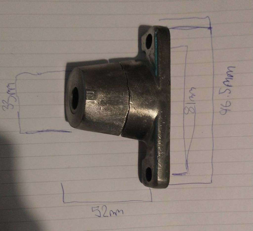

      I am trying to work out the material of a Myford super 7 cross slide endplate non power feed as it is broken and I was woundering if it is possible to weld it. Currently I carnt seem to find a replacement online as myford have sold out of the raw castings.
      The part I have is non magnetic, feels to heavy to be aluminium, is cast, and does not spark when touched with an angle grinder.

          My understanding is that all or most of the ‘silvery’ non-ferrous castings on the Myfords are Zinc-based alloy
          i.e. Mazak/Zamak or similar

            Michael is correct, I think it is Mazak.
            If you can give me the dimensions of the bits I can check against my PXF endplate. You could think of fabricating a beefier bracket from Aluminium plate and bar. I did this for my CNC conversion.

                There are numerous names for a low temp welding rod that will work on mazak and aluminium. I have used it with great success !
                It requires the casting to be very clean and gently heat overall. once near the melting temp the rod will suddenly flow and you then puddle the molten pool and move forward feeding the filler rod in. If you can weld or braze this is a REAL handycap. Read the instructions and stick to them. One trade name I have heard is LUMIWELD.

                  Here are the dimensions, they are not the most accurate as it is hard to mesure in 2 pieces. Thanks for the replies and advice Noel and Johnimg_20210303_222014407.jpg

                    I would strongly advise you make up some form of jig to hold the hole for the feedscrew in the right orientation in both axes before you go ahead with the joining method.
                    Having got that sorted out I would also make a simple weld preparation vee around the joint faces to help the new metal to flow into the joint

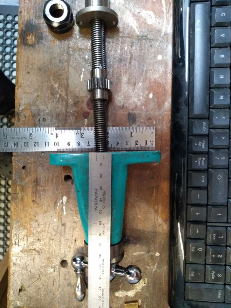

                        This a pxf bracket. Bolt hole spacing is ~80mm, LOA also ~80mm, base flange 100mm (probably actual nominal dimensions are inch). So the hole spacing is quite possibly 3.125 (three and an eighth). Length seems significantly greater, I'm not sure why. Critical dimension is that between the plane of the mounting hole s=centres and axis of the feedscrew, I'm pretty certain that would be the same between the lathes.

                          That's correct, the keyway only powers the pxf – the self-act Z feed rate is unchanged between pxf and non-pxf versions.
                          Personally I think the mazak castings look flimsy and let the lathe down, I'd just fabricate one from aluminium.
                          And to another ega point, it may well be that the non-pxf screw will be too short for the pxf type bracket.
