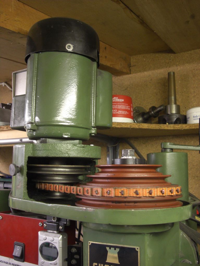

                Kevin Bennett
                  @kevinbennett25223
                  the plate on the motor is a bit scratched on mine
                  ty kevin

                    Jimillsortit
                      @jimillsortit
                      Thanks Kevin the pictures are helpful they let me see the proper setup.

                      John Coates
                        @johncoates48577
                        Mine is like Kevin's

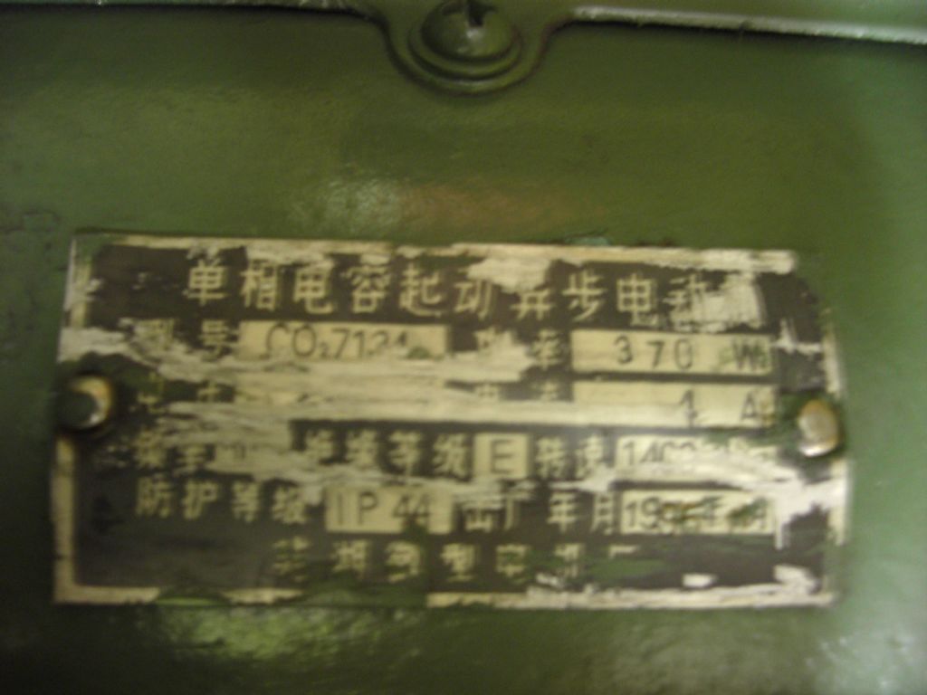

                            Nicholas Farr
                              @nicholasfarr14254
                              Hi Jim, as has been said it is a Chester Champion Mill/Drill, although the one in the picture below has a different colour scheme the specifications are the same.
                              The photo below shows the motor plate on my one and the only imformation in the parts list is that shown as in the type.
                              They discontinued them around 2007/8 ish.
                              Warco produced an almost identical one known as the ZX-15 and discontinued them a year or so after Chester.
                              Regards Nick.

                              Jimillsortit
                                @jimillsortit
                                Thanks Nick
                                This just confirms what others have advised above especially the picture of the motor plate.
