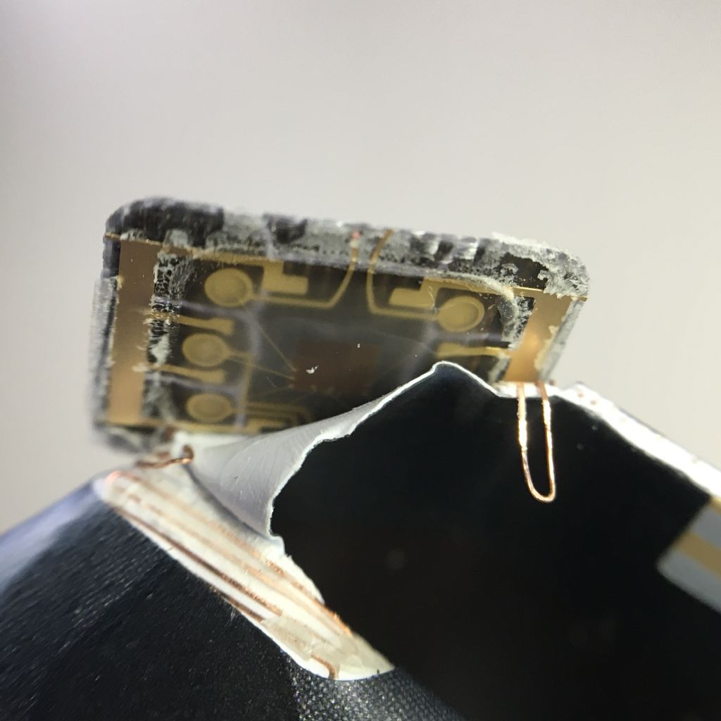

        No, I’m not trading as a ‘financial advisor’ … it’s a technical question.
        Years ago, when Chip & Pin cards appeared, curiosity led me to dissect a few.
        Yesterday, I realised that I had never checked inside a ‘contactless’ one … so my expired Capital One Visa card gave its body to science:
        The antenna loop is clearly visible, albeit damaged by my clumsy technique.

          Now leave it in acetone over a few hours – like they did on TV.

              On another thread I posted a link to the Hannah Fry documentaries – there was one on smartcards where she dissolved the card away just leaving the chip and "antenna" and she was still able to buy a coffee with it!

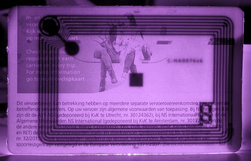

                        I viewed the internals of a credit card using NIR illumination but can't find any photos. Here is an image of the chip and antenna from a disposable Dutch NFC train ticket. Illumination was from an 850nm LED and imaging using a compact digital camera with the IR filter removed and a visible block filter installed.schiphol train ticket.jpg
