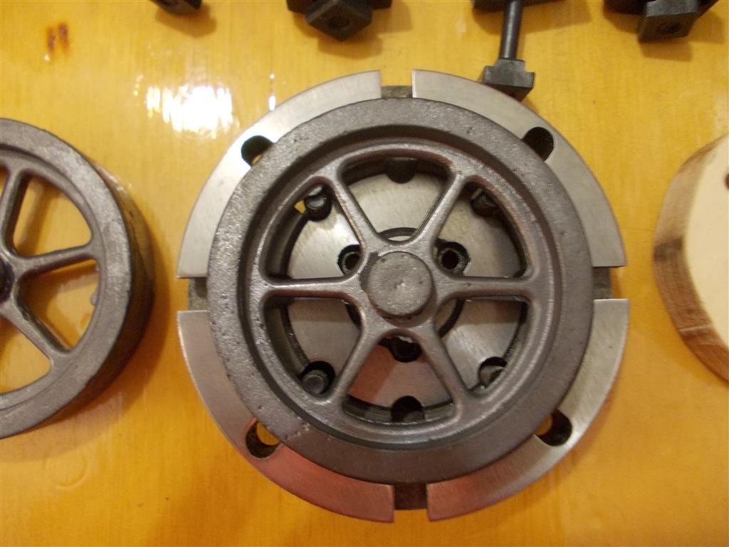

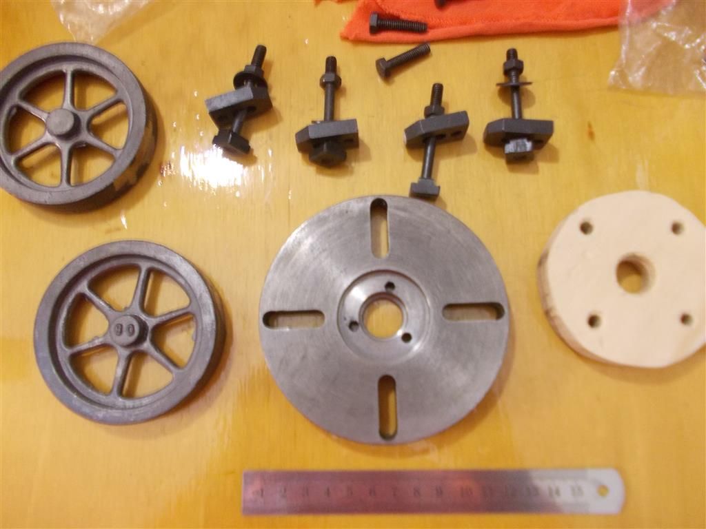

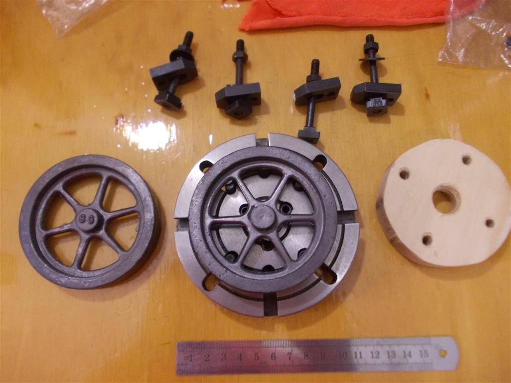

                                  I have cleaned up the cast iron flywheels with the angle grinder today (lots of casting flash) and I am trying to work out how to attach them to the face plate prior to being machined. I have never used the face plate before, having machined all my previous flywheels using a steel mandrel. I cannot work out how to bolt the flywheels to the face plate ; the flywheels do not seem quite big enough to get the bolts through any of the provided slots and holes.
                                  I may have to use the face plate to get the centre holes drilled and then switch over to a mandrel to finish machining the edges and outer surfaces. I am hoping not to have to do that : I have found cast iron  to be more difficult to machine with a mandrel then brass or aluminium as it vibrates a lot more causing chatter.
                                  Edited By Brian John on 16/05/2016 12:11:27
                                  #238925
                                  steamdave
                                    @steamdave
                                    One way of holding the flywheel would be to screw a piece of MDF which is larger than the flywheel diameter to the faceplate. Make a central hole to clear the boss if it protrudes beyond the height of the rim. Use 3 bridge clamps over pairs of spokes screwed into the MDF. Before the clamps are tight, juggle the casting so that the inside of the rim runs as true as possible then tighten up for machining.
                                    Now you will be able to machine the edge and one side of the rim, and clean up the boss and make the central hole. After that, you can hold the wheel on your mandrel or in the 4 jaw chuck to clean up the other side of the rim and finish off the boss.

                                      Another option would be to drill and tap some additional holes in the faceplate to suit your clamp threads. Then just span across two spokes with a clamping plate.

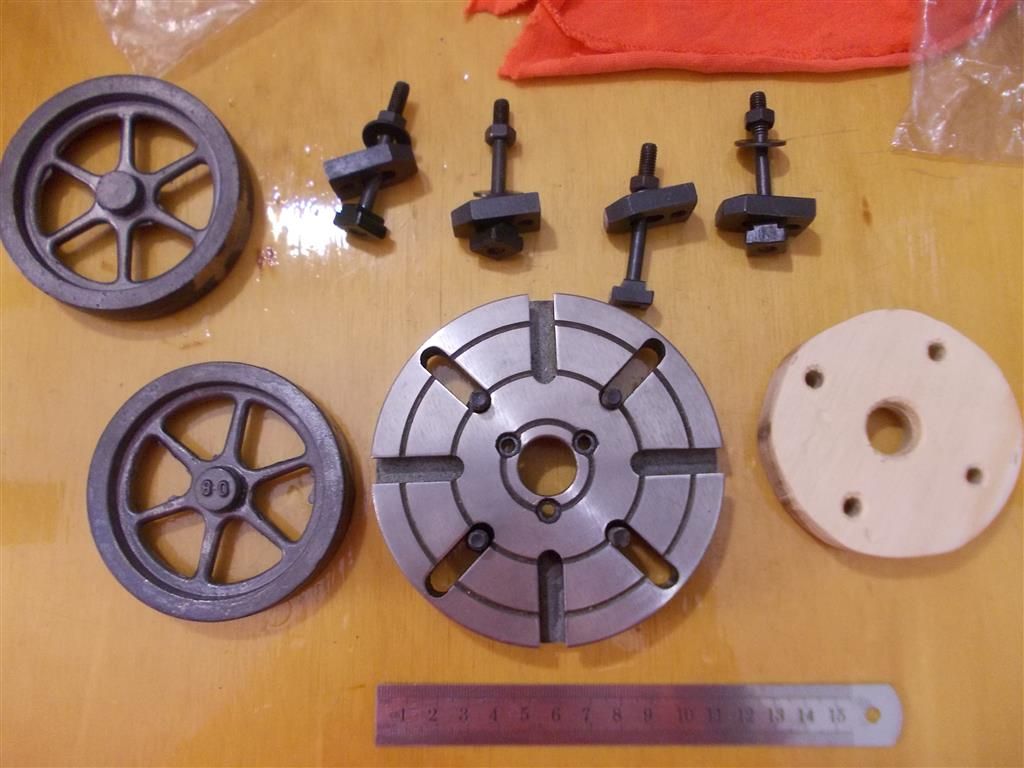

                                        1. Okay, I will drill and tap for M5 (tap drill = 4.2mm). What is the face plate likely to be made of and how difficult will it be to drill and tap ?
                                        2. How thick should the timber or MDF board be on which the face plate rests ie. how far from the face plate should the closest edge of the flywheel be ?

                                          1. probaly cast iron so shoud drill & tap OK, mine did.
                                          2. does not need to be much just something to let the tool run out into, 6mm would do.

                                            I,v got 8 full sheets of 3 mm MDF, so I use that, but cardboard, maybe more than 1 layer is quite ok between the FW and the faceplate.

                                              Be careful that you don't overtighten the clamps as to much will break the spokes.

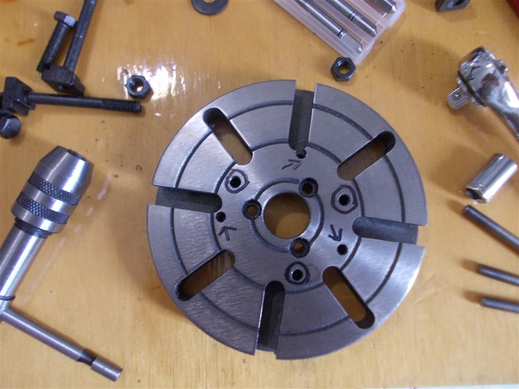

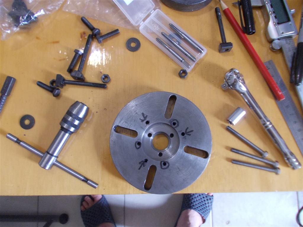

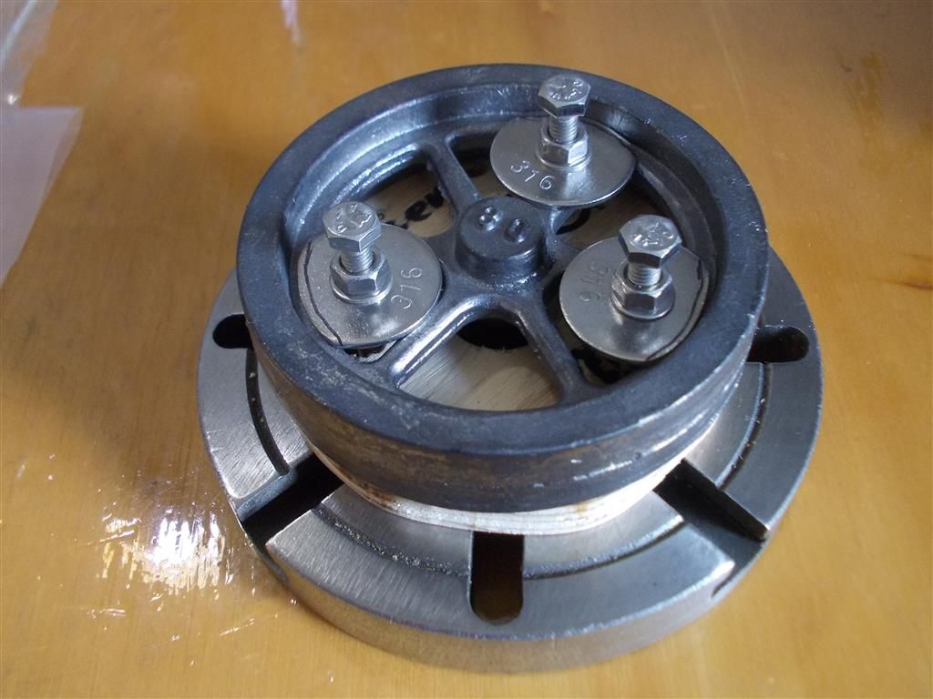

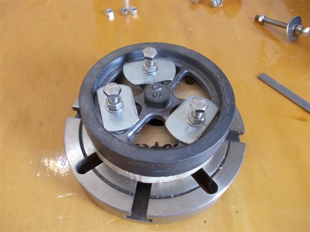

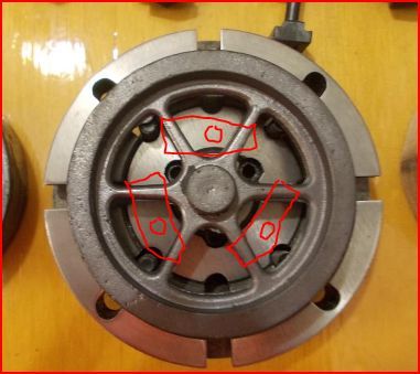

                                                I have drilled and tapped the face plate for M5. I made a mistake by drilling from the back in the first instance (holes with arrows). I was trying to avoid the recess on the back of the plate but I forgot about the recesses on the front. So I ended up drilling through the edges of some of those front recesses…not good for tapping. I drilled a second set of holes from the front ( holes with circles) and these were finally in the correct place for tapping. I used plenty of tap magic and there were no problems tapping into the cast iron face plate.
                                                I am still a bit confused how to go about this. There is not a lot of room once the clamping plates are added to the centres (photo 3) so I am not sure I can take a facing cut off the hub doing it this way. I may have to put the clamps on the outside (photo 4) and take a facing cut across the hub then drill/ream the centre hole that way. But having done that, I am not certain of maintaining concentricity when I remove the outer clamps. I may then have to use the mandrel to finish the outer surface and the rims.
                                                I think it is a case of not being able to see the forest for the trees !

                                                  With care you should just be able to face teh edge and stop the tool before it hits the clamp plates.
                                                  Alternative would be to make some smaller and/or thinner clamping plates, may even find that just those large washers will do without the plates.

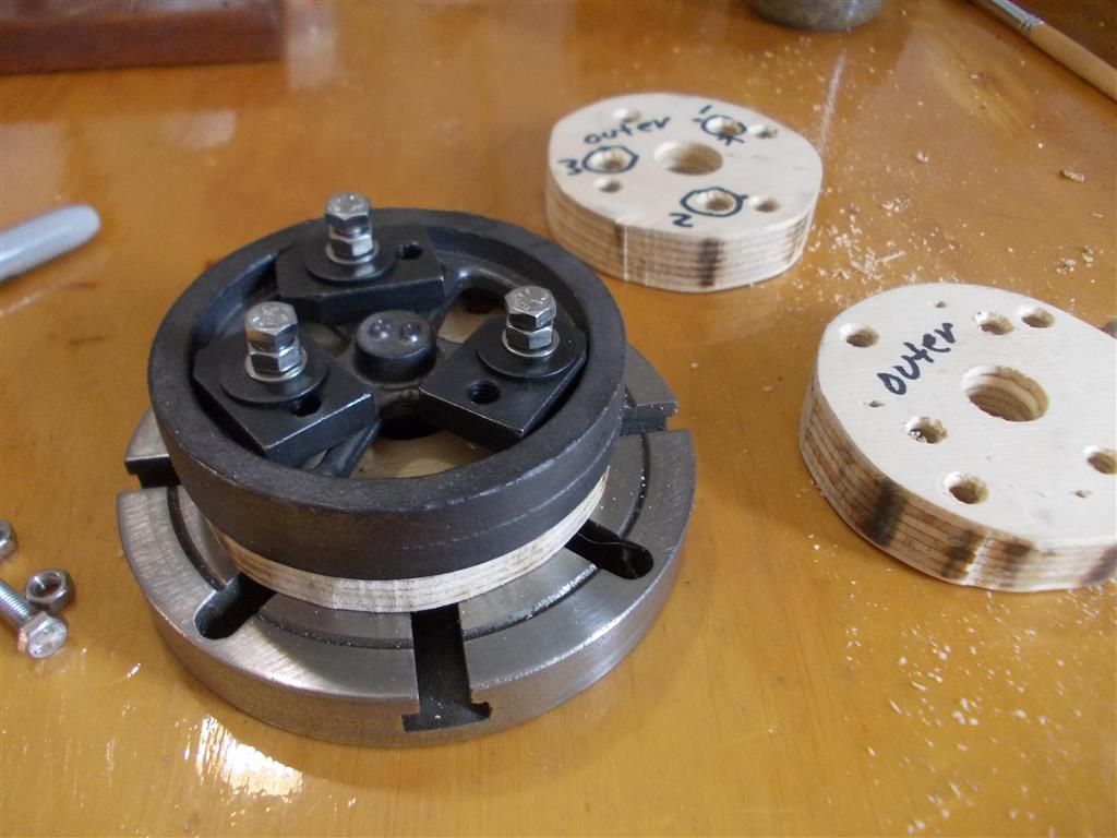

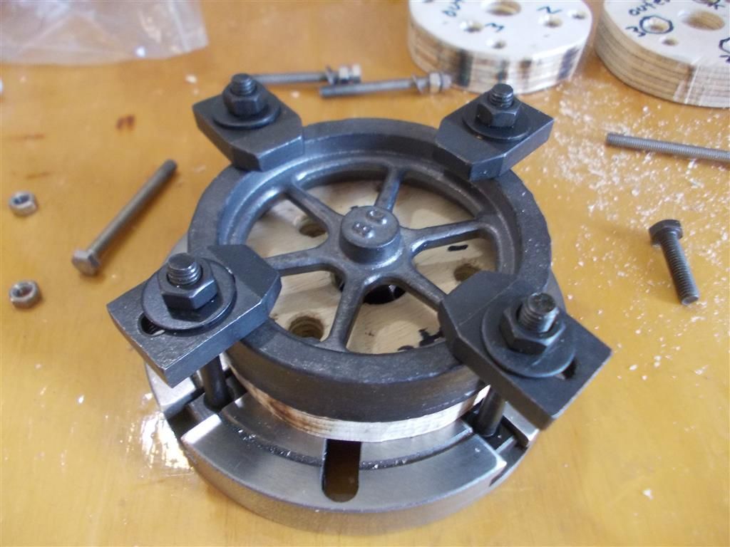

                                                    I made up some clamping plates from 25mm M5 washers today by shaping them on the bench grinder (photo 1). I did not think they quite covered the spokes enough so I used some 31mm washers and cut some tangents off them with the angle grinder ( photo 2). That seems to be a better fit and I hope to give the face plate a tryout on the lathe tomorrow.
                                                    #239332
                                                      That should do the job.
