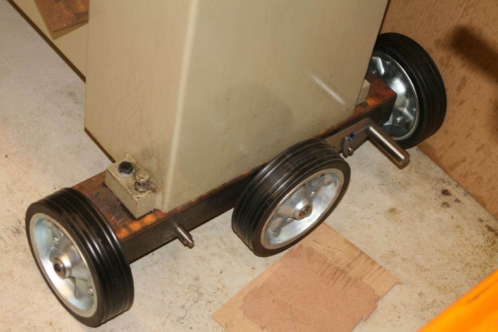

      Has anybody moved a Harrison 250 if so. Would removing the lathe from the makers stand be a problem to ease the lifting and moving. My workshop in my garden so lifting the entire lathe from the drive would be rather difficult.

          I understand that Harrison lathes were fitted to the stand and aligned at the factory. It would be regarded as an all round bad idea to split them.

            I would certainly leave the bed attached to the stand, but when I moved my old Boxford BUD I removed the headstock, motor, saddle and tailstock so it was easy to get into a Berlingo.
            Maybe worth looking into for the Harrison.

              Andrew's comment is correct regarding the factory alignment. My M250 was replaced by Harrisons when I bought it in 1986, because of a problem with the bed to stand joint.
              I would agree with Richard that you could remove such bits as the motor, tailstock, end cover and splashback, to make it a little lighter.

                Hi Peter, Have a look at Harrisonlathe.groups.io if you search there is lots of information. The manufacture process is the same for the M250 or M300.
                Single eyebolt through the bed is the correct method for lifting, I made a purpose built wheeled dolly to fit and made a path with shuttering ply as required.

                  You could always mount on 5 wheels, which makes single-handed movement a doddle.

                    ega
                      @ega
                      Spurry:
                      How is that third wheel lowered, please?
                      I can see what seems to be a short lever in your photo but presumably it needs to lift the considerable imposed load.

                        If you have a look in my album, there are several pictures of the mod. (It is not my original idea BTW.)
                        The actual raising and lowering action results from a cam action, so not much effort is required. The little odd-shaped piece is the auto lock.

                          Hi Spurry, I have an M250 and they are quite low, so can see 2 benefits with that set up, gaining height and flexibilty. I will definitely use that idea. Where did you source the stout looking wheels? I am sure some may think it would affect ultimate accuracy but I would be more than happy with the trade off.

                              Being 6'3", the increase in bed height does reduce the amount I have to bend. The ability to move the machine at will is a huge benefit too. I guess the wheels would probably have come from Ebay, paid by Paypal 16/6/2010, at cost of £42.50. Cannot recall the exact seller, sorry.

                                If you search ebay for 'pallet truck wheels' it will come up with wheels very similar with solid tyres and reletively high load ratiings at a reasonable price.
                                Example; https://www.ebay.co.uk/itm/162999377535?hash=item25f3851e7f:g:EPgAAOSwgoNeYh24
                                I bought a pair just for this very purpose, to make a dolly for moving a heavy lathe single handed.
