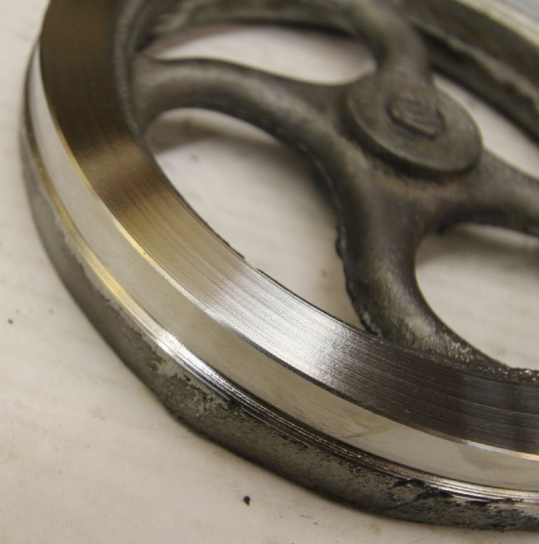

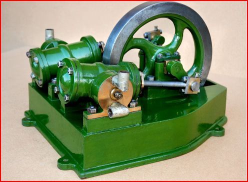

      A Canadian modeling buddy of mine showed me a couple of photos of a twin oscillating steam engine back in 2011, and I helped him with the 3D modeling work.
      We initially were going to make the engine from bar stock, but I decided that this engine really needed to be cast, so we 3D printed some of the patterns, including the flywheel pattern, and hand-made other patterns from wood and steel.
      After setting up a home foundry, and lots of trial and error, we were able to make to flywheels in gray iron, and the remaining parts in 356 aluminum.
      Most of the machining was completed during the holidays at the end of 2015, and my Canadian buddy was able to complete his engine and run it.
      I have been busy with work projects, and so I have only been able to complete and run one cylinder. I used temporary commercial fasteners to check the alignment and fit of the parts, but I am making custom "old-style" bolts and nuts for all the fasteners.
      The pistons and rings are gray iron. Connecting rods are steel. Bearings are bronze.
      It has been a very enjoyable build, albeit with a long and difficult learning curve.

          This is a video of my Canadian buddy's engine running for the first time.
          This engine is a 60% scale of the full size engine, and has a 6" diameter flywheel, and a 1.25" bore.

            Here is a comparison of the 3D model we created, compared with a photo of the original engine that was listed for sale at Preston's Services.comparison-09-16-15.jpg

              Here is the model engine I am constructing, with one cylinder fitted.rimg_3464.jpg

                                          I originally intended to cast the entire model in gray iron, but due to the difficulties of melting and pouring iron, I was only able to cast the flywheels in iron.
                                          If I can get my iron technique to be more reliable and consistent, I may revisit this engine and cast the cylinders and base in iron.
                                          That is the beauty of having patterns, if you don't like what you get, you can cast another one.

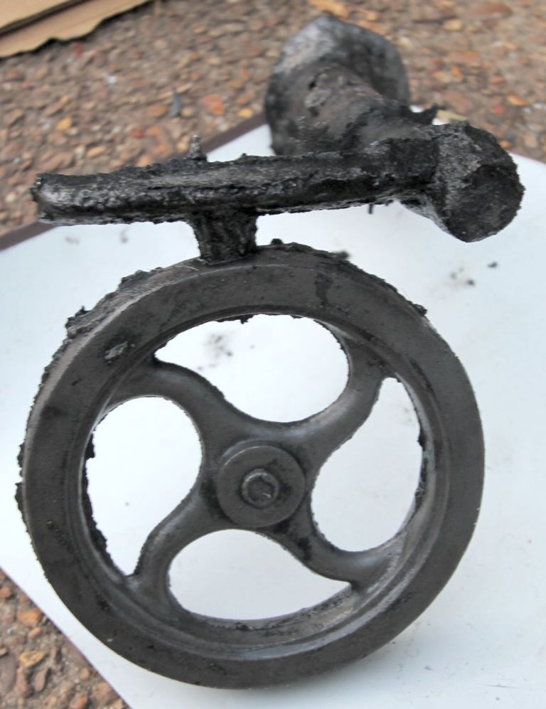

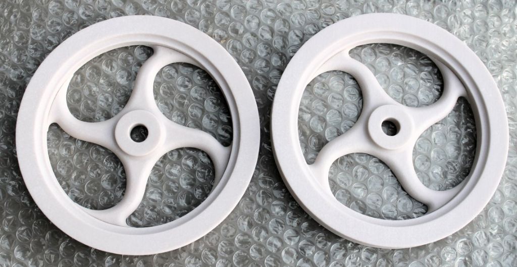

                                                When I first started working on the 3D model for the green twin, the plan was to build the engine using bar stock.
                                                We eventually decided the engine just had to be cast, and so I started tinkering around with melting aluminum.
                                                I had no clue about patterns or pattern making, and my Canadian buddy said "there is a guy on y-tube that shows how to make a flywheel pattern", and that guy turned out to be myfordboy (enginebuilder?).
                                                So the first pattern for the green twin was a wood flywheel pattern based on myfordboy's methods.
                                                My pattern making skills were extremely poor at the time, and so we went with a 3D printed pattern, but I have watched a large number of myfordboy's foundry videos, and credit him with much of the casting of this engine, since much of the pattern making and molding for this engine came from his shared knowledge, and inspiration from his beautiful engine builds.
                                                There is a lot of talent in the world, and in GB in particular, and thank goodness these folks are kind enough to share their information.

                                                    The first flywheel did use Petrobond, but I had a few sand inclusions where I think the iron overheated the sand and caused it to fail.
                                                    For the second flywheel and the remaining molds, I used a resin to bind the sand, and the sand was a very fine commercial grade round-grain foundry sand (OK-85 I think). The resin system is specifically designed to work well with cast iron temperatures, and I never had a sand failure after changing to resin-bound sand.
                                                    For non-iron castings, I have also used sodium silicate based binder for the same sand, and it also works well for metals with a lower casting temperature than iron.
