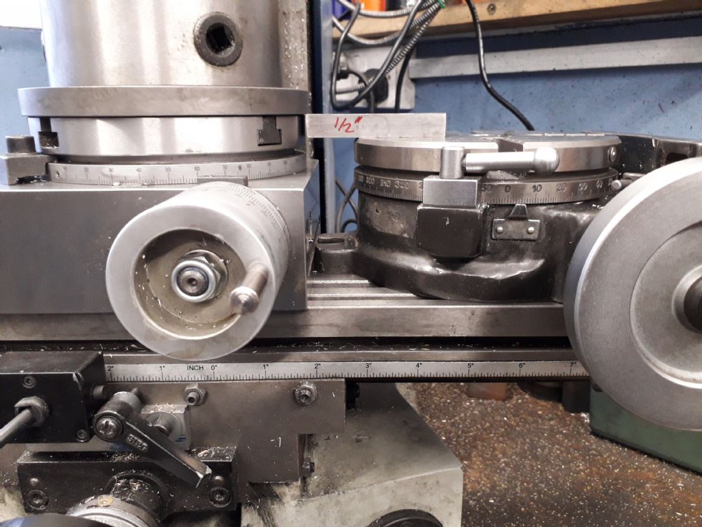

            The rotary table you have shown a few times on your mill, is that a 6" and from Arc ? It looks lower profile than the Vertex style devices. Did you obtain the dividing plates and tailstock at the same time and are they a necessity?

              My own is a 6" Soba which I have the plates and tailstock for and that would be in photos going back about 10 years. As part of what ARC sent me for the beginners series I got their 150mm rotart table complete with chuck, plates and tailstock and have used that quite a lot over the last 16months as the 72:1 works out well for a lot of what I have been doing and I like the ability to set the ring around the table to zero which you can't always do on others when the layout of the clamping slots means the work can't be set square when the table reads zero..
              The ARC one probably does look a little lower profile but I don't think there is much in it (will measure later) but it looks lower as their is no "foot" and is easily spotted as it has a bare metal finish to the body and no rings in the table.
              A lot will depend on what you are doing with the table, the plates do make it easier for getting divisions that are not easily divided into 360 though you can use the handwheel dial and set that to the angular measurement. For example if you just want say 24 divisions then it is not difficult to read off 15deg increments but if you wanted a 26T gear then you could work out each multiple of 13deg 50min 46sec.
              Same for the tailstock, obviously useful for long work but can also be an advantage for small items as you can put them on an arbor to get them well away from the table/chuck so you can get in close with a collet chuck and small cutter without the two clashing.

                  For Meunier, the ARC 150mm rotary table is 90mm high and the Soba 78mm
                  This is about a 70mm dia MOD1 steel gear on a stub arbor, one pass per tooth
                  I did cut the teeth while it was solid as I thought trying it after shaping would give trouble
                  And a before shot of the 20mm dia arbors
                  Edited By JasonB on 02/02/2019 13:11:51
