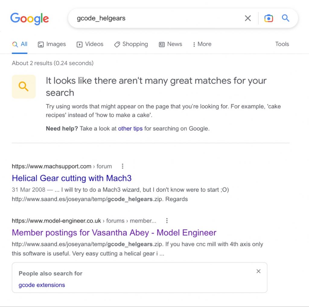

          Hi Vasantha, that sounds very interesting, thanks for sharing this. Google fails to find the software from the description, please could you post a direct link?
          #631437
            Curiouser, and Curiouser [said Alice]
            I have just done a little search, and Google found two hits … both of which appear to contain the same URL
            I will leave the Eat Me/Drink Me decision to you.
            But I think you might search for gcode_helgears.zip
