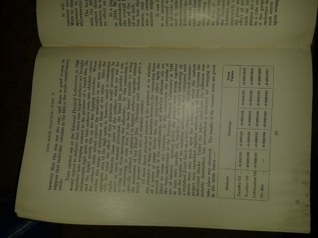

                          20150108_132952.jpgThis argument. Re oil film on slips seems at least 90 years old.
                          Npl tests in 1924 explored the effect of different oils of minimum thicknes
                          And looking at the difference in height of a given pair of blocks….
                          See attached
                          It seems the oilfilm may reach zero thickness on the high spots of the finish and more in the valleys. .how the high spots of one slip interact with the lows of another slip might also add to the "grip"..
                          The effect of air pressure on wringing was also explored…
                          And at 0.5 psi the force to pull apart tge slips exceeded 30 times that from the air pressure.
                          ..will attemp to post extract
                          Edited By jason udall on 08/01/2015 17:49:35

                            jason udall
                              @jasonudall57142
                              Sorry …***//PATIENCE EXCEEDED IN FORUM POST///**..
                              Cant get photo into message…just look at my album about slip guages…
