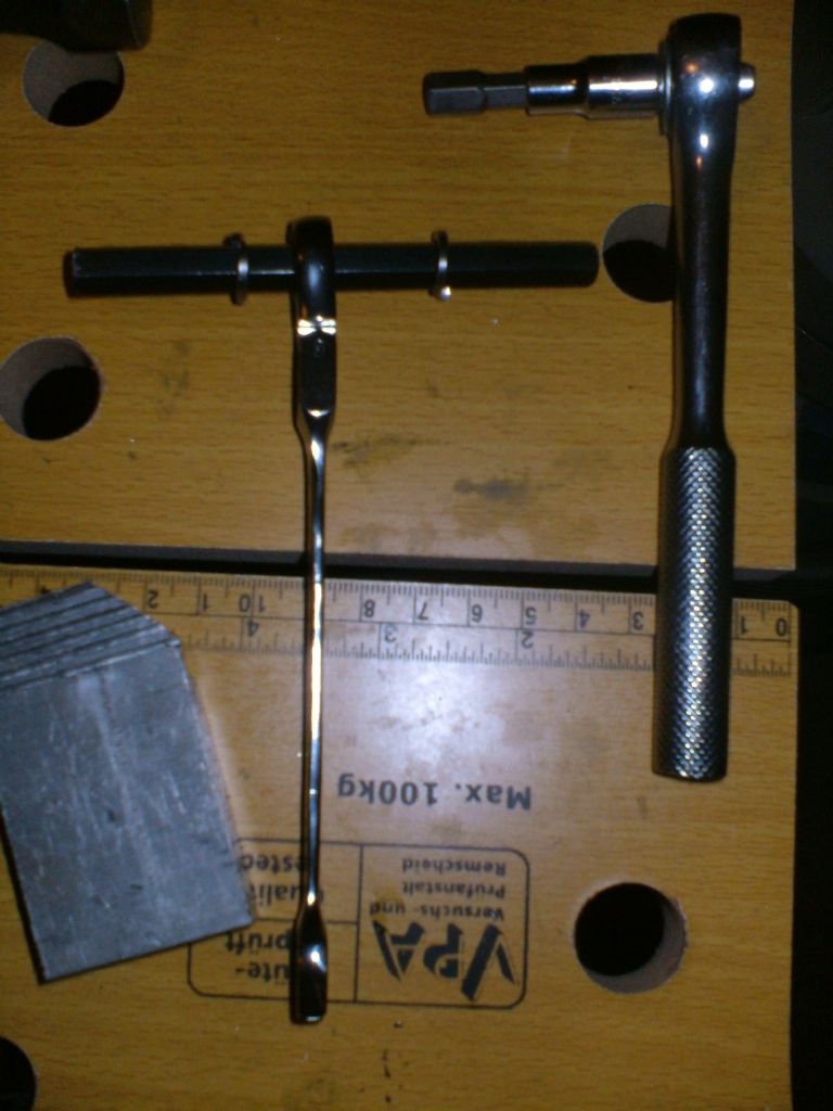

      Have used a Stanley socket ratchet for a couple of years now and it started getting a bit wobbly recently, nearly all my bolt-on bits, vices etc use 8mm hex cap sockets and it gets well used but it seems a bit silly to trash an entire 1/4 inch socket set for one-off jobs
      Sooo, I'm going ratchet spanner, with the flexible head types, plugging in a hex socket bar and holding it in place with a couple of split washers
      The old and new systems are pictured below, first away is a halfords advanced which seems to be a nice wee bit of kit
      I also have an 8mm Teng on order
      All competitors will be well used tightening and loosening bits and bobs over the years and losers/winners will be cruelly exposed if they give up the ghost
      All recommendations, preferably based upon previous experience, will be viewed with definite interest
      I am using flexible head ratchet spanners, not the fixed ones, and with small heads, so they fit into tight spaces
      cheers

          Ady1 Why not just get a new ratchet ? If you are after a recommendation then "Stahlwille ". Ratchets / spanners don't come any better, built to last.

            I can see the point as ratchet spanners are often smaller than flex ratchet handles but why make an adaptor? Halfords do a set of three for 11 quid **LINK** and a heavy-handed mechanic tells me they honour their lifetime guarantee.

                  I have both and they both have their uses, you can get the spanner into spaces which you couldn't get a ratchet and socket.

                          Cant agree with you there, at work we use Stahlwille aerospace series tooling, most of the ratchets 3/8" and 1/4" drive have to have their internals replaced yearly, they simply wear out and starts slipping, but at least you can replace the internals. Bahco is the same, true they get used and abused but never had any issues with Snap On ratchets we also have. My personal tools are Blackhawk, they are also very good.

                            Just buy a new ratchet from your preferred manufacturer. I have the swivelling ratchet ring spanners and they are great when you have a particularly difficult access proble, but for your use a new ratchet is the easiest and most cost effective solution frankly.

                                  There's a new (ish) ratcheting system out there which uses open end spanners, I've seen SATA and Britool stuff with it and got one by accident when I got the wrong bit of kit sent to me
                                  So you get the access of an open end spanner, most of it's "strength/power" (say 75%), and the convenience of a ratchet
                                  You can only turn it in one direction though, it must be flipped over to go the other way
                                  I was so impressed I grabbed a whole set
                                  This is the sort of thing I got (not this brand tho)
                                  Means I can now ratchet a hex socket or a nut in a silly place with ease (don't ask, will explain later)

                                    If it does what you want, Ady … that's good.
                                    Unfortunately the 'ratchet action' is only six-tooth [because it's dictated by the nut], which I find very restrictive. A conventional ratchet typically has a much finer action.
