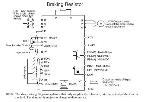

      I am in the process of fitting a VFD to a Colchester Student 1800 lathe. I would like to keep the apron forward/reverse lever functionality, as well as the brake function. (Push pedal to stop motor and don't start it again when pedal is released, even if forward/reverse lever is still engaged.)
      I am struggling to find a wiring diagram and programming setup of what seems like quite a common requirement. I have downloaded various Huanyang manuals, which refer to Start/Stop/Reset, but not to emergency stop, even though this is mentioned later on in the manual as an option.
      Could anyone show me a simple wiring diagram for this setup, and indicate what programming is required?
      Also is it essential to fit a braking resistor? I don't need instantaneous stopping. I was wondering of the mechanical brake fitted to the foot brake pedal would mean that I should fit a braking resistor.

              A manual is here:
              https://bulkman3d.com/wp-content/uploads/2019/01/HY01D523B-VFD-Manual.pdf
              On the bottom left of the diagram in the original post is the 'multi-input'. The bottom half of page 20 of the manual covers this. To make the multi-inputs accept commands, parameter 001 needs to be set to 'external terminal' (bottom of page 26).
              Each input pin has 32 possible settings that define its function. You program the pin to do what you want it to do and then connect an appropriate switch to the pin.
              Page 37 of the manual is a good start on the wiring diagram, using three of the six multi-inputs. Connect the E-stop to one of the unused three remaining ones.

                  The braking resistor is switched in when the voltage on the DC link of the VFD rises too high because the slow down ramp timer is set too short. Program a conservative ramp time and the resistor may not be necessary. A fault is usually generated if the DC link voltage goes too high. A big job with a four jaw chuck fitted can result in a mass that is beyond the VFD to control even with the resistor fitted in which case the ramp down time will need to be increased until the machine can be slowed without creating a DCLink fault.

                    Posted by Mike Poole on 03/06/2023 16:28:49:
                    Program a conservative ramp time AND use the mechanical brake on the machine and the two will fight each other.
                    Any input you make to this discussion concerning ramp times and braking resistors will be meaningless and could even be misleading without including the mechanical brake as part of that input (which could be a simple as saying 'do not use the mechanical brake at all&#39.

                            If you've got your hand in the mangle, stamp on the footbrake with all you've got. Too bad if the VFD doesn't make it.
                            But to give it a chance, have an E Stop relay which cuts power to the VFD as a result of pressing the footbrake. There's a micro switch fitted to fulfil just this purpose with the original control circuit. The issue over whether the VFD will ramp down or loose control of the spindle doesn't matter, the brake will do it's job. One would expect the VFD to survive a power outage at full speed, so this is no worse than that.
                            One could also devise a control scheme where this micro switch was the stop input to the VFD, but the VFD must not restart when you release the pedal.
                            Less savage happenings – having the work shift in the chuck for example – are dealt with in the same way. It would be nice if the VFD survived so telling it to stop asap is possibly the way to do this though it does depend on the features of this particular VFD.

                                If a mechanical spindle brake is combined with a spindle drive clutch as fitted to a Colchester Chipmaster then the VFD won't be overloaded. In this machine the motor is started using the forward/reverse switch and drive to the chuck engaged by a separate lever activating the clutch. Pushing the lever the other way disengages the drive clutch and gradually activated the spindle brake. The Student may use a similar arrangement but with two levers, one to engage the clutch and the other to drop the clutch out and gradually engage the spindle brake.
                                However in a more conventional electrical control arrangement the motor may be started and stopped by a buttons engaging and releasing a motor control contactor/s and when a mechanical brake is used it would normally activate a switch that releases the motor contactor to remove drive.
                                Machines can be fitted with either an Emergency Off or an Emergency Stop. The EMO just disconnects power whilst an EMS arrangement actively stops the machine in a controlled sequence.
                                If a VFD is used the VFD can be configured to "coast" to standstill when "Stop" is activated in which case there is no regenerative braking and no need for a braking resistor. In this case spindle braking would rely solely on mechanical losses. If a mechanical spindle brake is used this would need to be fitted with a switch to "Stop" the VFD when it is activate.
