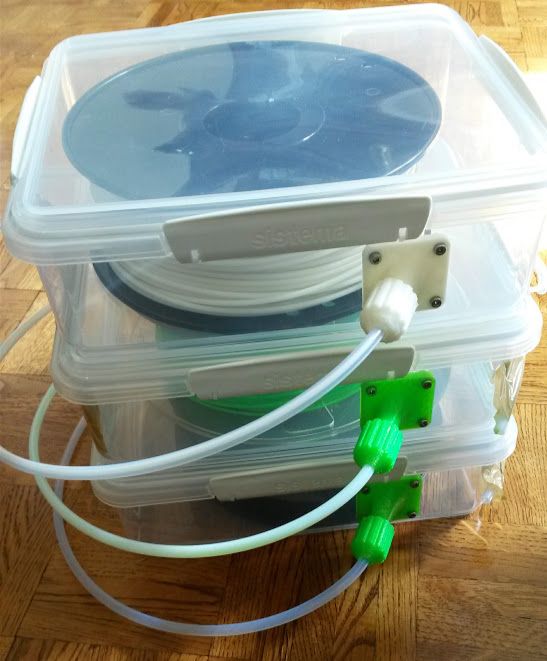

      For Nylon storage I have an air-tight cake box with an angled fitting (courtesy of Tinkerman's Filament Dryer on Thingiverse) and PTFE tube right to the extruder, after drying the filament and adding refreshed moisture absorbent packs in the box the relative humidity was reading around 2% after sealing for 5 minutes.
      What are you guys using?
      – Nick

              #309344
              Nick Hulme
                @nickhulme30114
                It seems to be getting me there with delivering dry Nylon to the printer.
                – Nick
