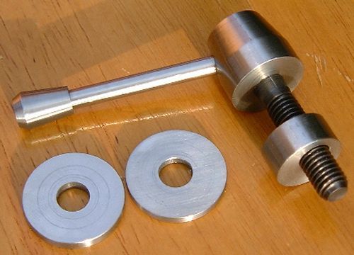

                  #68017
                  NJH
                    @njh
                    Hi
                    I use the carriage lock on facing cuts and
                    especially when parting off. However forget the Allen key approach if
                    possible ( you can never find the right one when you want it!) and make
                    yourself up a little lever like this :-
                    Edited By NJH on 05/05/2011 12:00:18

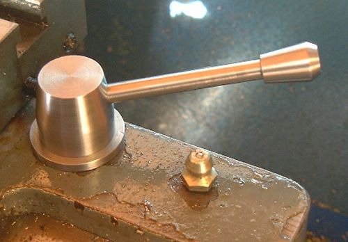

                      Norman, that’s what my Kerry has on the rear of the saddle as a standard fitting.

                                      NJH, I must make up a little leaver for my saddle lock, after twenty years the allen head cap screw is a bit tatty, and has always been hard to get at. Ian S C

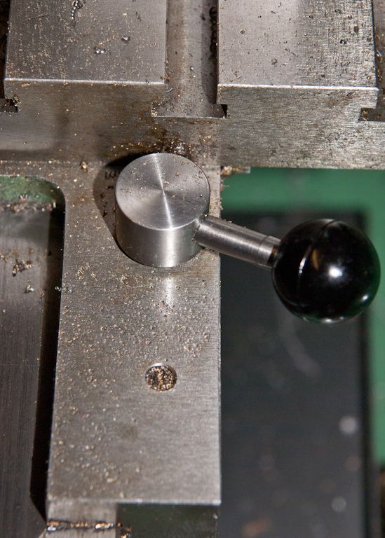

                                        Greetings All.
                                        On the subject of a carriage locking lever, if you are not confident enough (like me) to produce a neat little handle like NJH that will lock in just the right position; a small indexable handle from somewhere like Arceurotrade will probably be suitable.
                                        If the handle, when locked is in the way, it can be lifted and moved to a better position without releasing the lock.
                                        Gordon A

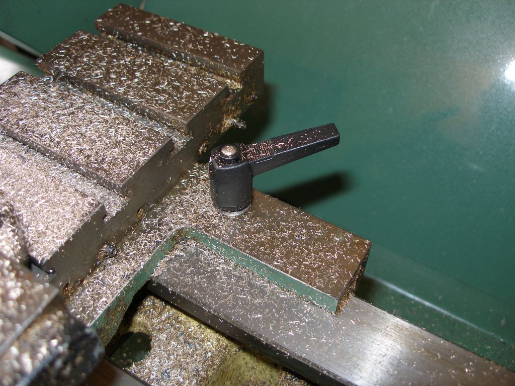

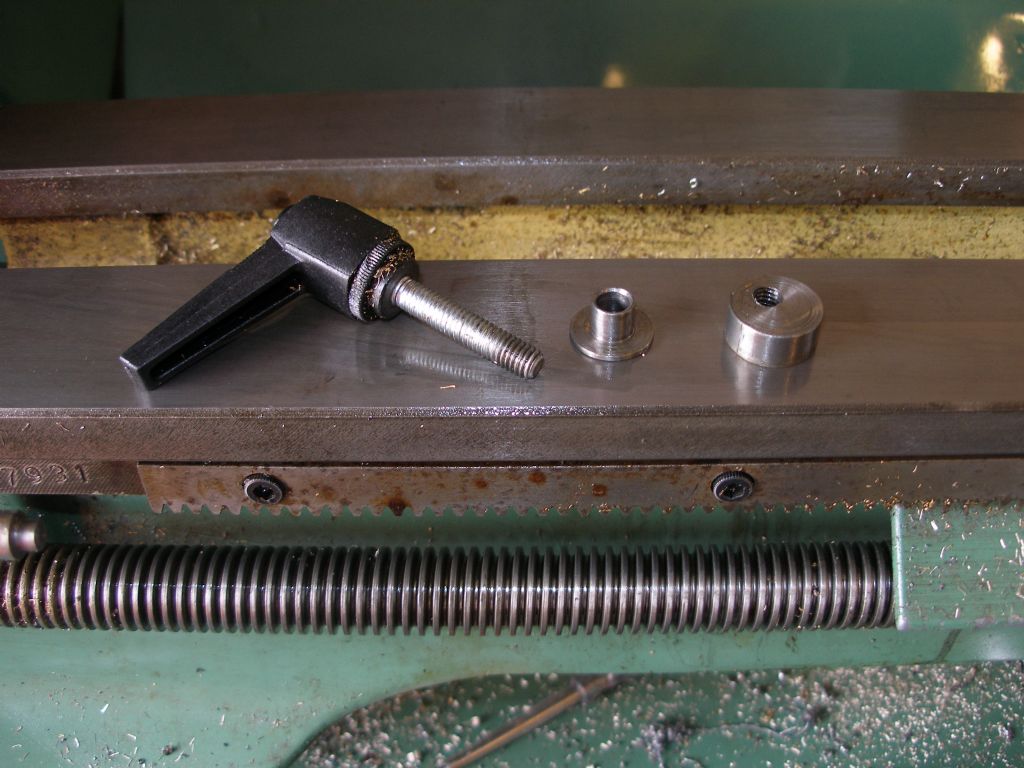

                                              David Clark 13
                                                @davidclark13
                                                Hi There
                                                I have always used the carriage lock unless I am holding the carriage against a bed stop.
                                                This is a home made metal one.
                                                The photo below shows it fitted.
                                                I have since changed to a plastic one.
                                                Here it is again, fitted.
                                                I use it all the time, it is now a habit.
                                                The plastic handle came from J&L Industrial, it is the longer thread version of the 6mm threaded one.
                                                You need a bush at the top to convert the 5/16in. clearance hole in the top of the carriage to 6mm clearance for the handle.
                                                You also need to make a new eccentric nut but that is not a major job.
                                                To position the metal one, I just skimmed the washer thickness until it was positioned correctly.
                                                regards David
                                                Edited By David Clark 1 on 05/05/2011 16:56:13

                                                mgj
                                                  @mgj
                                                  I made a lever lock for the Myford years ago especialy for interrupted cuts. (Obviously Myford believe a carriage lock is necessary?)
                                                  I used not to have to use it for continuous cuts, and then on KWILS recomendation I started using Ultraglide – and now I do get some movement. So I lock the carriage.
                                                  The 6″ chinaman is slightly different. Its very very smooth in action, but the carriage is a lot heavier and more massive than the Myfords. So it tends not to move.
                                                  Pretty is as pretty does I suspect, and I have not the slightest intention of fiddling with the gibs or setup of a lathe that turns so absolutely straight!
