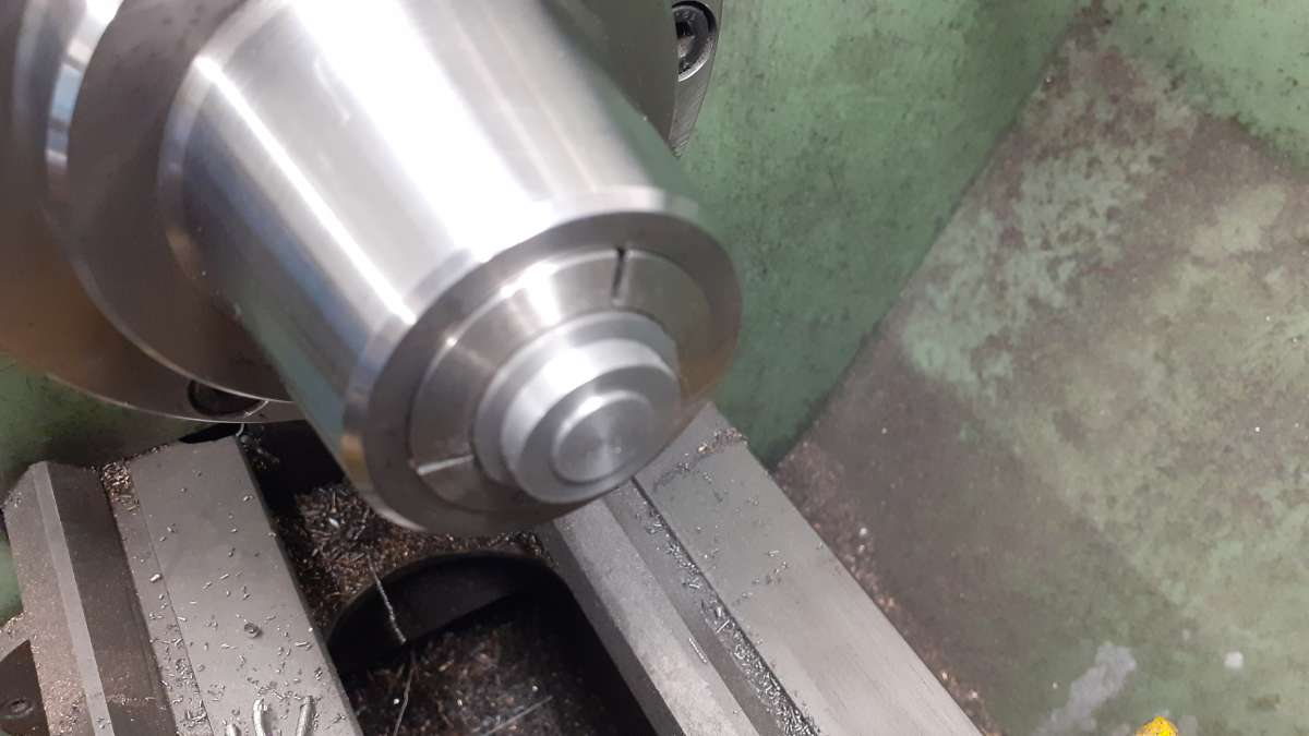

                                #762621
                                mark smith 20
                                  @marksmith20
                                  Well almost finished the collet chuck ,just need to mill two flats for a spanner . Very negligable run out and a massive improvement on the 3 jaw chuck i was using. Its an er 20 size.
                                  Bought a nice selection of 24 er 20 collets off ebay for £35 , several unused and many are good quality regofix.Had a straight shank regofix er 20 holder but not really much use for me..though i’ll think of a use for it.
                                  20241102_155358
                                  20241102_162813
