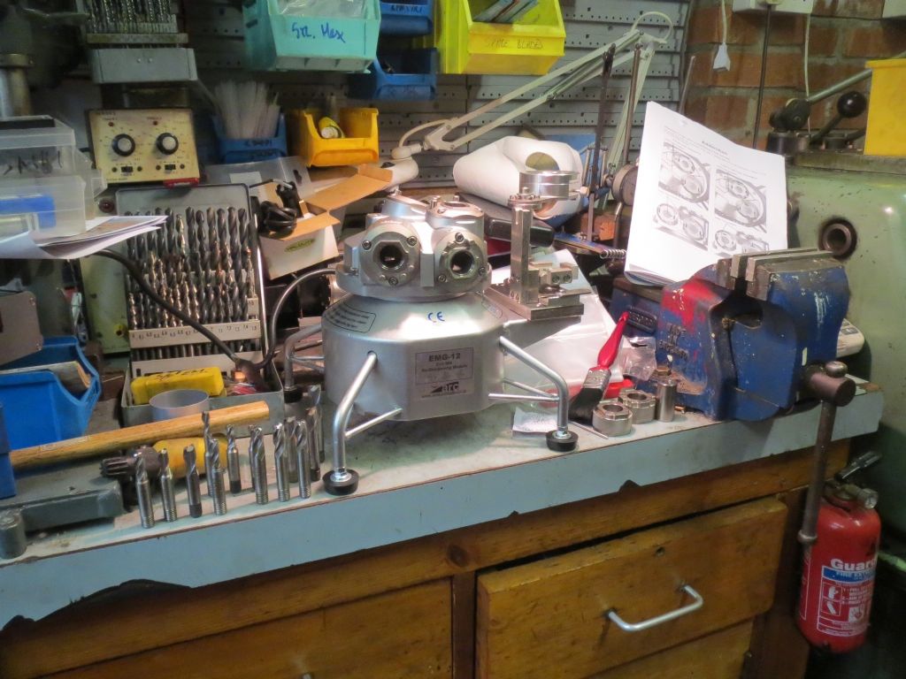

                #191399
                Owain Samuel
                  @owainsamuel55325
                  Firstly, the beast following it's arrival and placing on the clearer of the two benches. The cutters sat alongside were all sharpened in the space of less than 30 min once I'd got my head around working the beasty

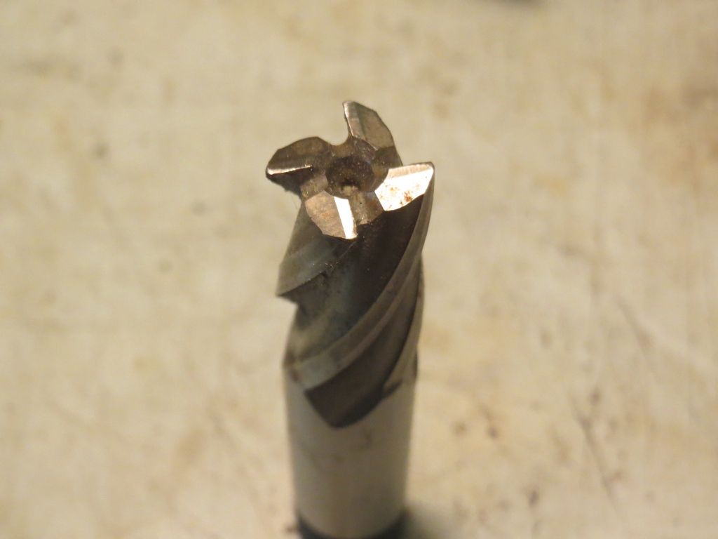

                  #191400
                  Owain Samuel
                    @owainsamuel55325
                    A closeup of a 2 and a 4 flute 10mm cutters, both fresh from sharpening, time about 3min each.

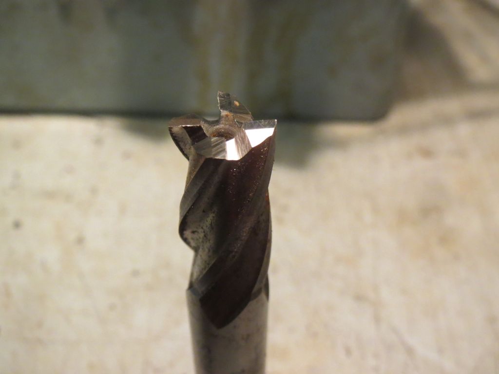

                    #191401
                    Owain Samuel
                      @owainsamuel55325
                      4 flute beforeThe cutter before sharpening. Spot the rounded corners.
                      And the very same 12mm cutter after sharpening. Again, time taken 3min or less.

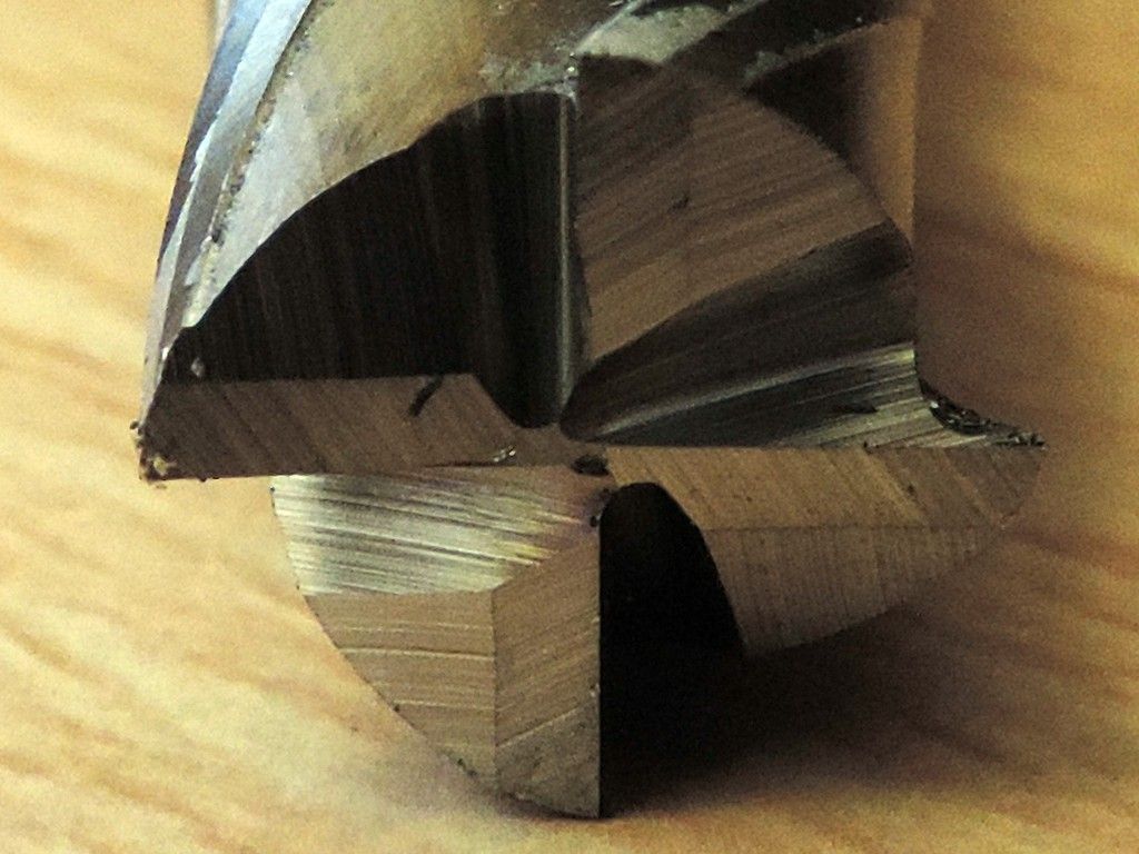

                      #191402
                      Douglas Johnston
                        @douglasjohnston98463
                        Is it just me or does the grinding look a bit rough. The picture on the right shows the cutting edge with quite a serated look.

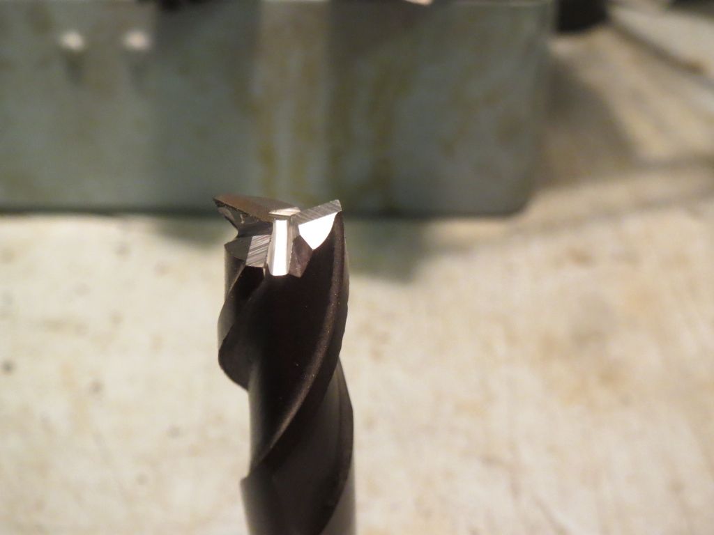

                        #191403
                        Owain Samuel
                          @owainsamuel55325
                          3elute carbide 2And finally, a 3 flute carbide cutter that was (to put it politely) knackered. I ended up removing 1/8" off the end with a bench grinder before sharpening. The cutter had been in a CNC when the job moved, badly chipping all three teeth.
                          #191421
                            I think it's an artefact created by the pattern left on the ground face, to get a true idea and avoid exaggerating the grinding pattern you need to avoid reflected light.
                            Here's a 1/2" 4-flute John ground for me when i first saw the beast – edges look dead sharp to me. It took about a minute, but he's had more practice

                              #191433
                              Douglas Johnston
                                The magnification of the image probably makes it look rougher than it really is. It would be interesting to know what the specification of the grinding stone /diamond is and whether there is a choice of grit size.

                                      winkwink
                                      As regards the striations brought up by various people it is of no consequence to the finish as milling cutters are not ground flat across the face but a very shallow inverted vee with the outside corner being the lowest so in effect although the whole of the cutter is removing material the corner is doing the finishing just like a fly cutter.
