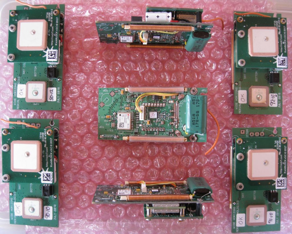

                      I build Wildlife tracking collars ( Lions..) which are powered from a 3.6v lithium cell – a D cell, 17AH type which is tailored for long life at typical max 150mA draw, due to a non-trivial internal resistance.. The Iridium Sat modem in the collar draws tween 300 and 400mA intermittently during a 30 second period in which it transmits the collar position via satellite to our server. A 5Farad supercap in parallel with the battery makes this possible – it supplies the large currents thanks to its very low internal resistance, and is replenished slowly by the battery. 4 hours later, when its time for another position transmission, the supercap is long fully charged again.
                      It also allows wringing the last bit of energy from the battery as well.
                      A neat device!
                      The green device to the right of the PCB's top center through bottom center – a 5F supercap

                          My physics teacher insisted that you'd never see a 1F capacitor that was small enough to be of practical use!
                          So it's YOUR satellites ruining all my astrophotos, Joe!
                          #457861
                          Joseph Noci 1
                            @josephnoci1
                            Posted by Neil Wyatt on 17/03/2020 20:16:45:
                            Sorry….
                            Send you some Lionphotos instead?..
