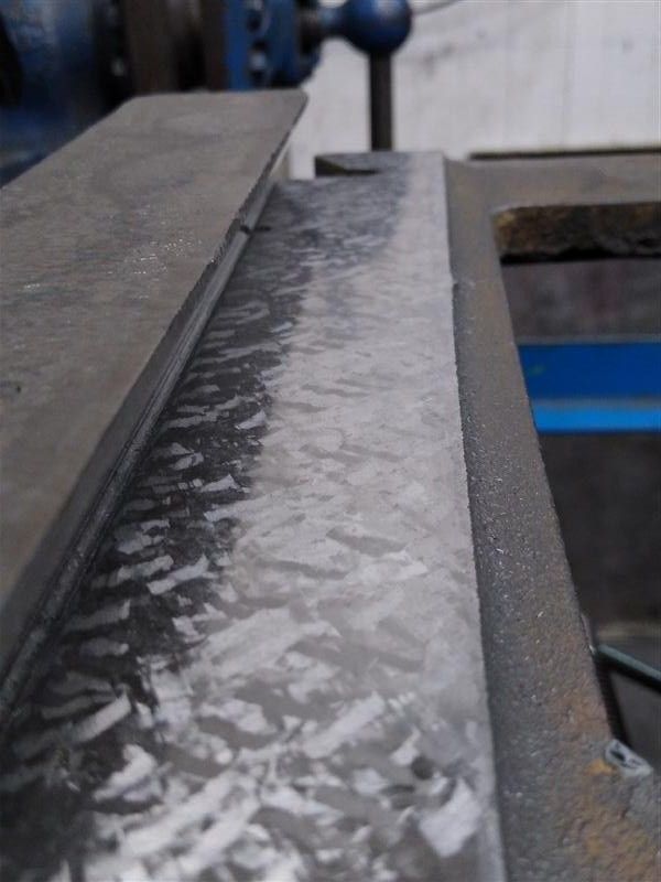

      I'm currently rebuilding a Eagle Mk3 grinder and I know there are at least a few members that have one. I have a question for you – what oil do you use to lube the ways and how do you apply it?
      The machine plate on mine says use Castrol Magna ZA. I contacted Castrol tech support and one of their specialists said that ZA is (was) a ISO10 oil, which I feel is very thin for a machine way.
      I'm finding it hard to reconcile using a 10 weight oil usually used on spindles as a total-loss way lube so I'm thinking of using ISO 32 way oil instead. Just wondering what other people use and if it works OK? I'm wondering if the thicker oil might cause stick-slip or even table lift on a fast traverse?

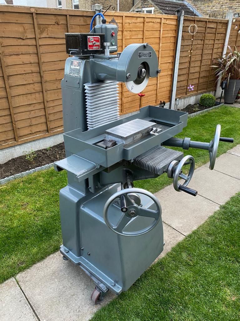

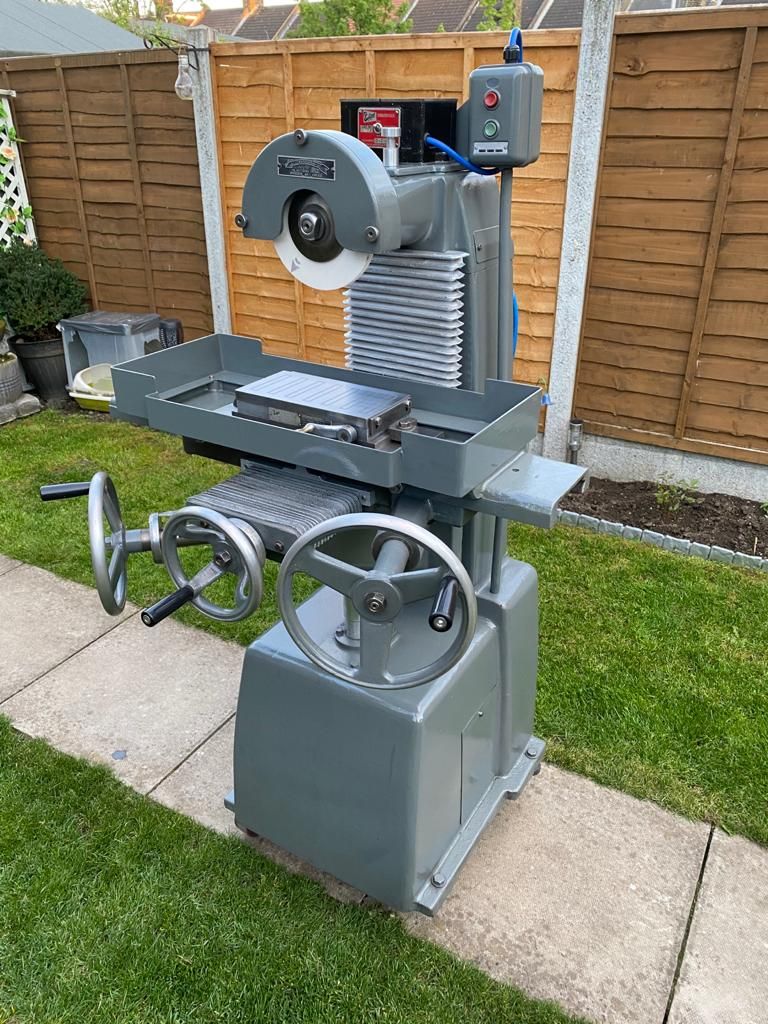

          Quick follow-up here. I found that regular slideway oil wouldn't flow properly along the delivery channel to feed the ways. I put some in both ends of the table and although some made it along, most was still sitting in the feed channel weeks later. So I've taken to using 10 weight oil (the equivalent of the specified Magna ZA) and it keeps the slideways nicely oiled.

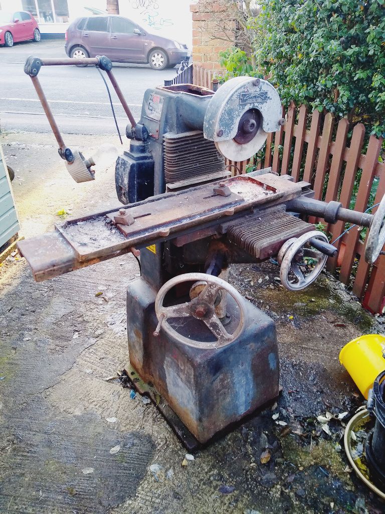

          Anyway, I finished rebuilding it this weekend so here's a couple of before and after pics. A lot of work went into this machine – not just a clean and paint. All of the ways are scraped, new poly vee belt with new pulleys made. New metric spindle bearings and of course a good clean and paint.
          Before, part-stripped for transport:
          And now in it's finished state:
          #468736
          Steviegtr
            @steviegtr
            Do you know what. It is like putting a nice set of wheels on a car. Complete transformation. Well done looks ace. Mnn ebay how much can I get for it. Too nice to sell.
            Steve.
            #468737
            Jeff Dayman
              @jeffdayman43397

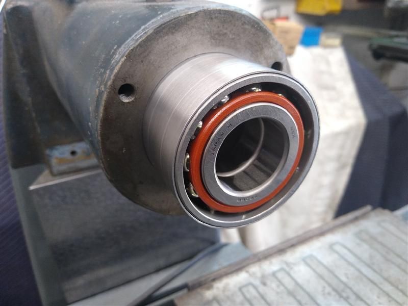

              Top notch restoration Pete! Well done. Did you have to do much to the spindle or was it OK?

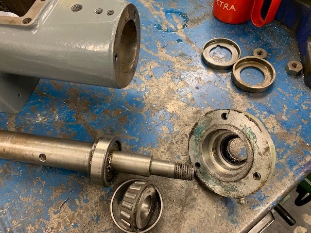

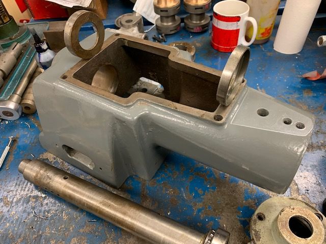

              #468765
              Pete Rimmer
                @peterimmer30576
                Thanks Steve and Jeff
                Jeff the spindle itself was fine, they are hardened. The bearings were shot though and the only exact-size angular contacts I could find were wheel bearings for old British cars so I turned a couple of sleeves and fitted modern metric angular contacts. The floating bearing on the rear was a standard 1"x2.5"x0.75" ball bearing and I did find replacements for that. The spindle also had a through-hole near the front so I made a spring-loaded plunger to act as a spindle lock for putting a spanner on the wheel nut.

                        Thanks for your notes re the spindle and bearings Pete. Re the angular contact ones you put in – did you order any special high precision type, and how did they compare cost wise with say a common grade 6203 ball bearing? Just wondering as any sort of angular contact bearings I have had priced here recently have been about 100 x the price of a 6203 type ball bearing. Just curious.

                          Looks like a resurrection, not just a restoration🙂. But looks can be deceptive I suppose. A neat and tidy job. How much does it weigh (if not on the net)?

                            Jeff: I was torn between Buying standard or super-precision bearings . In the end I bought 7206B angular contacts but instead of loose ones I bought a 3-piece set of matched same-direction pre-load bearings and used two of them back to back. I figured that since they were matched to be loaded through each other they must have a far better than average inherent pre-load clearance. The new size meant that I had to make a 30thou sleeve for the OD and another sleeve for the spindle. Here is the bearing pair fitted in the sleeve.
                            Its doubtless that super-precision spindle bearings would give a better result but at a couple of hundred quid versus less than £30 for a 3-bearing set of abec5 from ebay I doubt they would be 8 times better. Certainly the resultant finish is adequate for me needs.
                            Dave: Looks are deceptive. The machine stood under a tarpaulin for 10 years so all the rot was external. I was very fortunate that the way covers although very grubby were intact and so the ways had only minimal surface rust. It was still a couple of hundred hours work though I would guess. Every sliding surface has been scraped and that's quite a lot of work.
                            As for the weight? I would guess at 150kg or thereabouts though I haven't weighed it. If I get a change I shall.

                                Hello . First of all I am new to the forum and interested in the posts about the Eagle / Dronsfield Surface Grinder as I have just purchase one .
                                Mine is a very nice clean machine and I don`t think it has had much use in its former life .
                                I have only just got it home and it is dismantled into 5 major parts so I could get it into my Audi estate car. I tried to find a weight for it on the net but no luck – doesn`t seem as though a User Manual was produced for it .
                                If anyone knows different , I`d be pleased to hear.
                                As I re-assemble the machine I will weigh the 5 components and report back . I`m pretty sure it is not as heavy as the Qualters & Smith power hacksaw I bought from the same workshop – that was well over 300 kilos and made the car look seriously overloaded ! – but I got it home without any mishap .

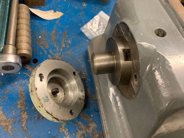

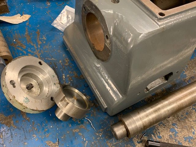

                                            Hi Pete,
                                            Just found this thread and read with interest. I must say, you have made a lovely job of your grinder, really nice. I picked up a Mk3 Eagle grinder a few years ago, overall in good condition without excessive wear. I rebuilt the base and knee, ways looked OK, made new leadscrew and nut for the Y feed, but I didn't get any further at the time – I searched but couldn't find much detail on Eagle grinders – but this thread had inspired me to get going again!
                                            I am very interested in the spindle arrangement on yours – I'm sure mine is not the original setup. On mine, the spindle has one deep groove ball bearing at the rear, and two taper roller bearings at the front. There is an endcap on both ends of the spindle housing, and two collars that are a press fir into the housing bores. The rear cap has a screw that acts on a blind plug to apply preload to the taper rollers at the front, by applying pressure to the rear bearing. Some pictures below.
                                            At the time, I bought 2 imperial angular contact bearings for the front, and a deep groove ball bearing for the rear, but I couldn't decide on a suitable method for applying preload – but I hadn't thought of using the spindle nut. Do you have a sleeve on the spindle to act on the front bearings? I would be interested if you had some more details on your setup, or a sketch would be really useful?

                                                  Pete Rimmer
                                                    @peterimmer30576
                                                    Posted by James Burden on 30/01/2021 23:00:04:
                                                    Hi Pete,
                                                    James
                                                    James,
                                                    On my machine the outer races are held tight in the housing by the front cover. The inner races are clamped against the shoulder on the spindle by the spindle nut and wheel hub. Pre-load is whatever is inherent to the bearing set. It's not perfect, but it's 'okay'.
                                                    If I get a chance I'll pull it out and take some pics for you.
