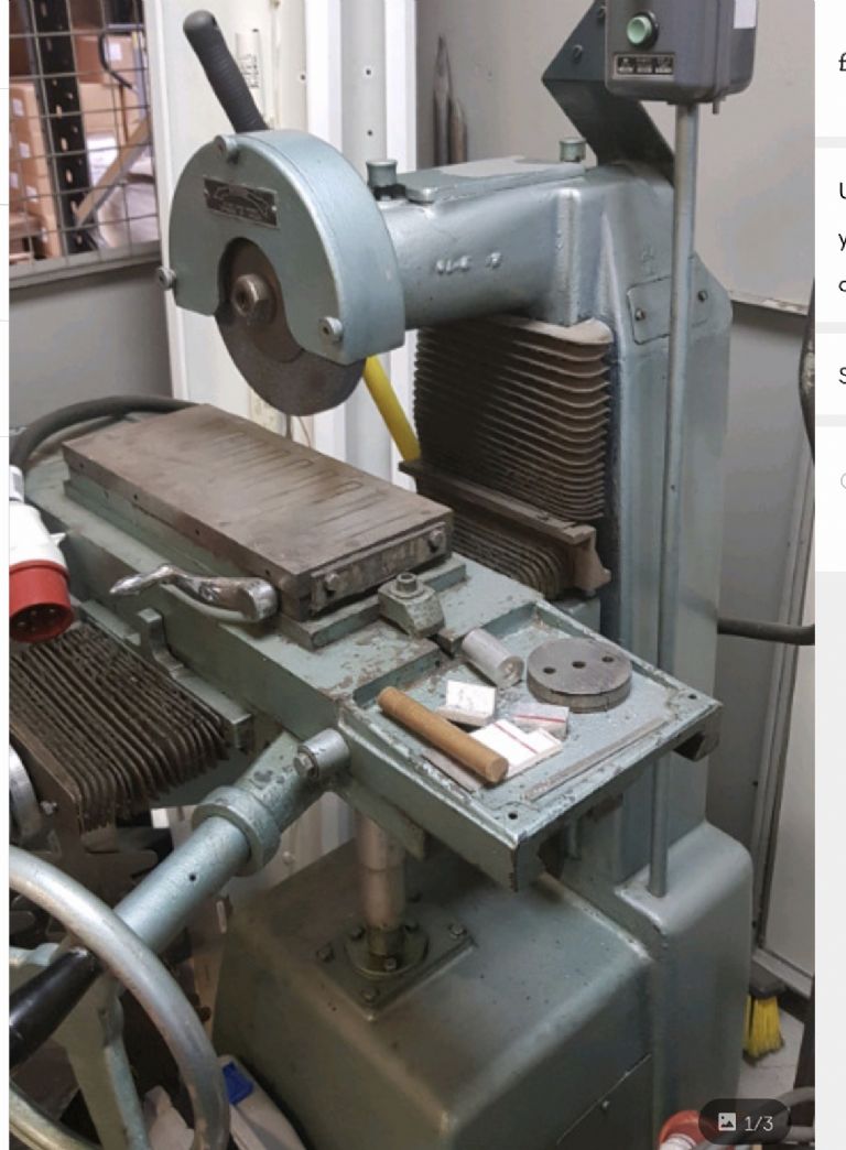

      Hi all,
      I have hopefully sealed the deal on a Mk3 Eagle Surface Grinder, pending inspection of the machine. Not having seen one of these in the flesh could someone tell what they weigh? Would it be feasible to strip the machine down and transport it in a normal hatch back car, or will I need to hire a van and a engine hoist or similar?

        Baz
          @baz89810
          Bit of both really, lift the table off and perhaps split column from base, and it will then go in a Transit or similar size van, don’t know if under new site rules if I am allowed to mention that site with all the machine tool info on but if you know the one I mean they will give an approx weight. My machine is not a mark 3 but I know for a fact it won’t go in the back of a hatchback.
          #495309
          Pete Rimmer
            @peterimmer30576
            You can split the head-column-base then 2 strong men can load it into a car but I think a hatchback might need 2 trips. I'm fairly strong and the bare column/base casting is about all I could manage.
            As for inspection – a couple of things to watch out for is the z-axis ways tend to get neglected for lube. The cast iron picks up on the opposing way and you can get a gouge in the middle of the way. There's no lubrication points that I could find and I had to add some. The y-axis (up and down) screw wears heavily in one spot. The spindle bearings are rare as a dodo that's been crapped on by a rocking horse, so take a part along and grind it. If you get a fish-scale finish your bearings are probably shot. Dress the wheel and grind again. If no improvement then figure on new bearings. You can probably hear them clattering if they are worn.

                Hi Mark,
                Unfortunately it seemed as though you were offered it after I had spoken with him, for it, much earlier and already agreed about collection and payment. Sorry about that but you were second in the queue of two, or maybe three.
                Vinay proved to be a fair sort of guy, but knew nowt much about the machine.
                It was tucked away in a corner and very inaccessible, but after about 3/4 of an hour I was able to set about dismantling it sufficiently to pack most bits on a pallet and the base and column separate.
                Started out at 06:05h and arrived back home at a couple minutes after 15:00h – although I dropped off a loom, for a friend of my wife, in Bristol.
                Chuck was stuck on (with paint, I think), table was slid off in two minutes, they didn’t believe the head and column separated until I unbolted them. Knee with cross slIde and bed slide were lifted off with a hoist and placed on the pallet. Whole lot loaded by fork truck in a ford 230L.
                I now intend unloading the bed, chuck, head and column at home on my own and a friend will unload the base and pallet with a teleporter later this evening. He will drop the base off at home when he is passing and I will fully dismantle the knee, etc and bring it home in my hatchback. The base may even come home in my car – we will see.
                It looks in fair – perhaps even good – condition for the price. I really wanted a Superior or an EXE but I am sure this will do as an introduction to surface grinding.

                  not done it yet
                    @notdoneityet
                    It’s been brush painted all over (including the table and the mag chuck), with a whitewash brush by the looks of it, but looks in fair order, as far as I can see. Certainly not in as poor condition as yours was.🙂 It is now in pieces, of course.

                    Pete Rimmer
                      @peterimmer30576
                      Looks fair enough on the surface. The spindle nut sets the bearing pre-load on these so don't ever run it without the nut done up.
