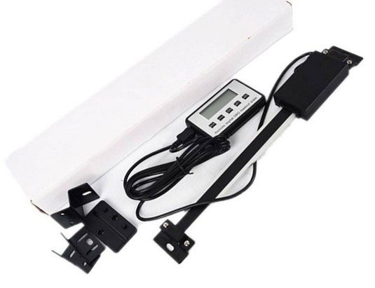

      I use several of these types of DRO in my workshop.
      screenshot 2023-04-14 at 10-43-04 accurate digital readout scale for milling lathe linear led dro 0-300mm ebay.jpg
      Powered by a either one or two 3volt button cells (CR2032). These batteries never seem to last long so was wondering if anyone has made them work from a suitable 240 volt to 3 volt mains adaptor.
      Anyone got any ideas for doing this?

            The ones that need 2 cells, are they in series or parallel?

              I suspect they would handle 5V just fine, making USB power a viable option. 3D printing a replacement battery lid shouldn't be too hard.
              #641268
              John Haine
                @johnhaine32865
                Modern 3v logic families tend to smoke if supplied with 5v…

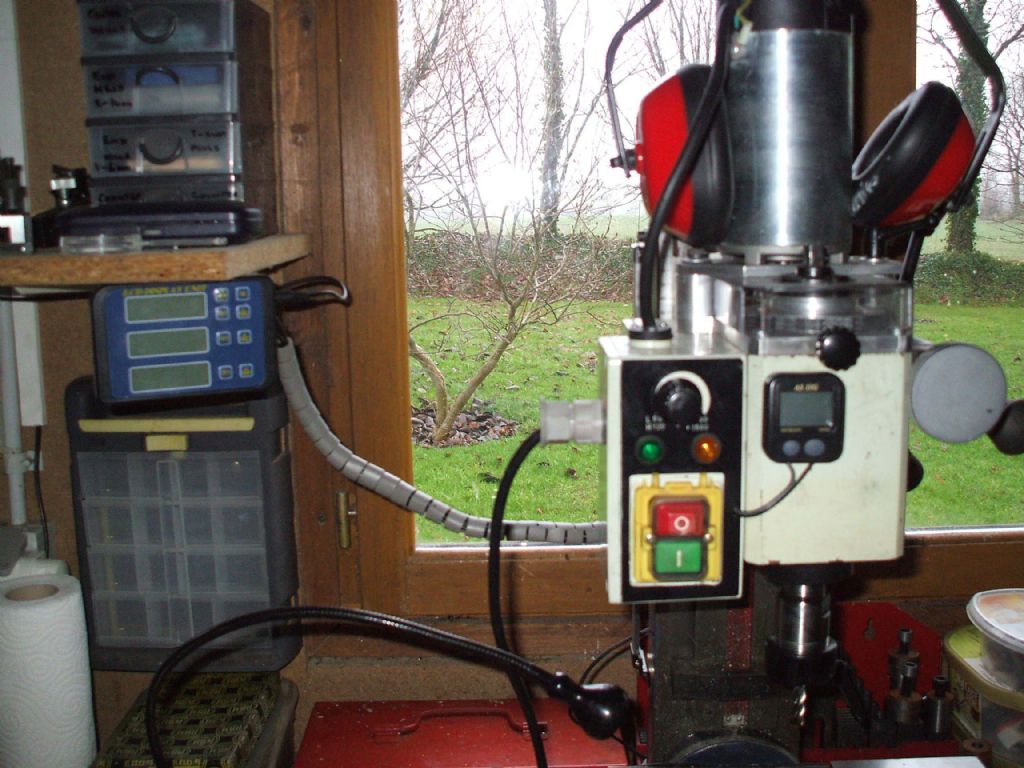

                  It is a good few years since I fitted my mini mill with 3-axis scales, obtained from ArcEuroTrade. Like you I found that the batteries didn't last long and I quickly replaced the supplied individual read out displays with a mains powered one similar to, if not identical to the one in the link above. I cannot say whether the voltage supplied to the read head is3V, 5V or 6V. The fact that it is supplied via a usb cable would suggest, to me, that it's 5V. An email to ARC would undoubtedly elicit a definitive answer. Not a cheap solution, but the saving in battery costs should be recouped within 8 to 10 years or so.
                  Remote readout
                  Not a brilliant photo, but it worked well enough within the limitations of the mill (and its operator). When we moved back to the UK in 2015, I sold the mill and scales etc to a friend nearby, to be replaced with a Warco VMC with glass scales soon after arrival in England.
                  Another alternative, I suppose is a Touchdro system from YurisToys of which I have read but have no experience I believe others on the forum have used this system however and if you happen to have an unused Android tablet lying around the place, could be a cost-effective solution.
                    I believe parallel, so 5V is over the top.

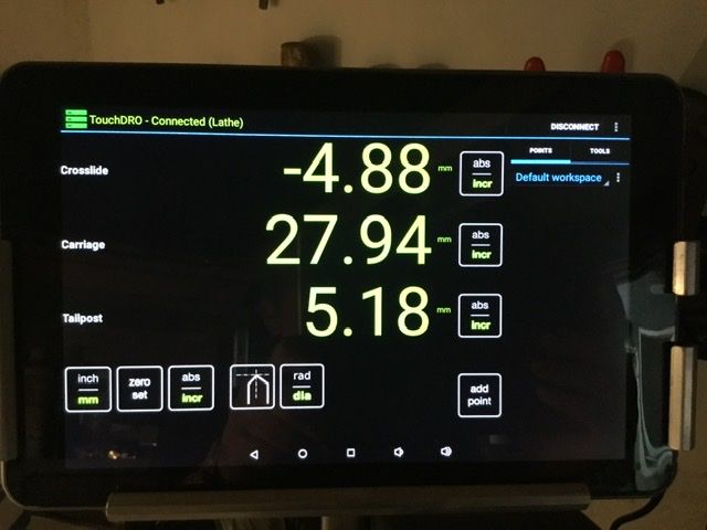

                        I have 3 of these fitted to my mill and found the display a bit small, so I made an interface box to use the scales with the TouchDRO app on a cheap android tablet. It uses an Arduino nano and a Bluetooth module.
                        The interface is powered by a 5v plug in psu via the micro usb socket on the Arduino nano.
                        This then provides power to the scales using the 3v output from the Arduino. Even though the connectors on the scales are micro usb types they are not 5v.
                        TouchDRO screen
                        This is picture of the TouchDRO app. This one is on my mini lathe.
                        Stuart

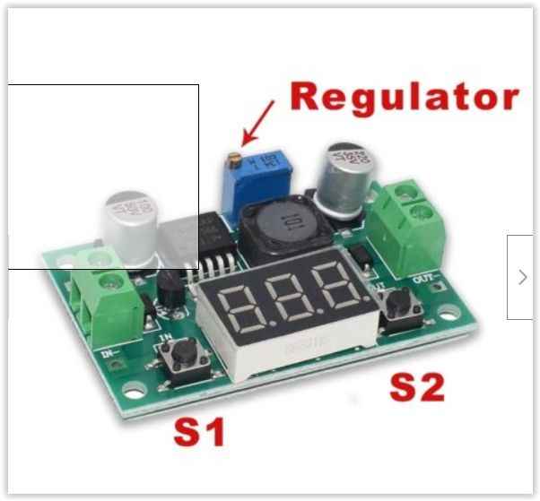

                                If your DRO only has a 3 volt supply, use a voltage converter (buck converter) to reduce the voltage.
                                Like this one that sells on ebay for £4.20 . Power supply can be any old DC phone/computer adaptor.
                                **LINK**

                                  Many thanks for the replies. I was hoping that I could use a 3 volt power supply, the sort that looks like a fat 13 amp plug. As has been suggested, the electrical output is noisy, the device won't like it. Also, my understanding of these PSU's is that they need to be made to "work". That is to say, the very low power demand of the DRO may not be controlled very well by the PSU.
                                  I wonder if using one of these powering a voltage controller may still have problems with electrical noise?

                                    Those buck converters are excellent for dimming LEDs and such, but they work by Pulse Width Modulation, so there is certainly some risk of introducing noise.
                                    You may, or may not, have problems

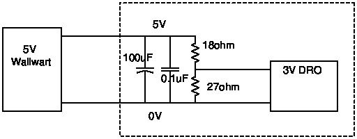

                                      Posted by John MC on 15/04/2023 15:48:42:…
                                      My last thought would be to use a mains USB adaptor connected to a voltage control device, (as in the previous post). Would this be electrically clean enough?
                                      Probably, except for the electrical noise picked up between the wall-wart and the DRO. The DRO expects a few clean DC microamps but what it gets is DC with a strong whiff of mains-hum, high frequency switch-mode spikes, and transients from motor brushes, VFDs, and other electrical clatter. Microamp level noise on the line is usually harmless because it's tiny compared with the hundreds of milliamps normally delivered into the load by the wall-wart, plus the load is decoupled to remove it.
                                      A DRO of this type is unlikely to have any decoupling because there's no long power lead acting as an antenna, and batteries don't add electrical noise.
                                      I suggest a circuit that replaces the missing decoupling and reduces the relative level of unwanted noise by loading the wall-wart more heavily. Should also improve it's regulation.
                                      All the components inside the dashed box must be as close to the DRO terminals as possible. The wall-wart cable can be as long as is needed. Works thus:
                                      1. The 18 ohm and 27 ohm resistors together draw about 67mA from the wall-wart, giving it something to chew on.
                                      2. The resistors help limit any voltage spikes on the line
                                      3. The resistors are arranged as a potential divider, making 3V available to the DRO, which taps off the few microamps it needs. As its current requirement is small compared with what the resistors are guzzling, the supply should be 'stiff' – not changing when the DRO is operated.
                                      4. A 100uF capacitor is strapped across the line to short low frequency noise like 50Hz mains hum to ground.
                                      5. A 0.1uF capacitor is connected in parallel with the 100uF to short high frequency noise like switch-mode spikes to ground. It's needed because big capacitors react too slowly to short out fast changing voltages.
                                      Comment: 100uF and 0.1uF are typical values. I'd expect them to work, but de-noising can be a fiddly job. The optimum depends on whatever noise is actually present, so it may be necessary to experiment, or do the maths necessary to design a proper filter.
                                      Keeping it simple, if the DRO misbehaves, start by adding a 0.01uF capacitor directly across the battery terminals. If that doesn't tame the beast, try various substitutes for the 0.1uF between, say, 0.47uF and 0.047uF. Easier to do with an oscilloscope, but not every workshop has one!
