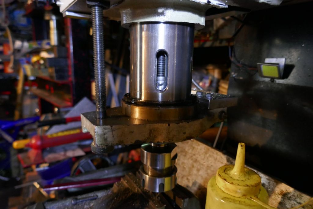

                        #465238
                        Paul Lousick
                          @paullousick59116
                          I use MT3, split type collets with a drawbar in my RF-45 mill to hold cutters.
                          Very handy for a bit more head room under the cutter. Also a bit more rigid as they do not protrude as much from the end of the spindle.
                          No problem removing them.  If a light tap on the drawbar does not work, there is a slot in the side of the spindle and a tapered wedge can be inserted to remove the collet. (photo shows an ER collet holder but the split type are ejected the same way).
                          Paul.
