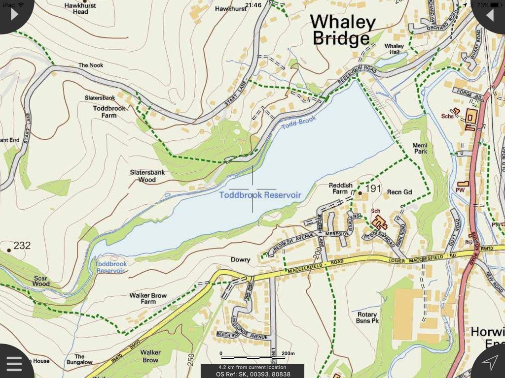

                                                    Posted by duncan webster on 05/08/2019 19:53:41:
                                                    Ah but, if you just have a syphon, once it empties the dam down to the level of the intake it will suck air and stop working, so you either need an air pump to re-prime the system, or a valve to stop the flow before it gets too low.
                                                    Also, the dam is 24m deep (to the water level, never mind the extra height of the wall), so you can't empty it with a syphon anyway
                                                    I'm not suggesting it would be a practical idea, Duncan … but I'm struggling to understand your assertion.
                                                    Please look at the elevation profile that I linked on the 'What did you do today …' thread when it all started.
                                                    [quote]
                                                    See the Google Earth & Elevation composite on this BBC page:
                                                    **LINK**
                                                    [/quote]
                                                    Edit: or check the contours on the OS Map surprise
                                                    Edited By Michael Gilligan on 06/08/2019 21:57:02
