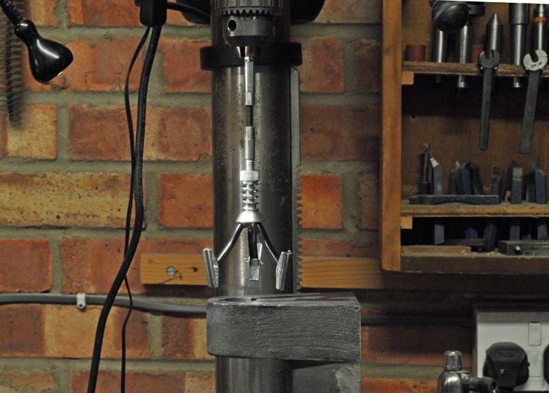

              Yes I used one of Polly's hones and it worked well. You need to keep it lubricated, keep it moving and keep from spraying oil all round the workshop!
              My solution was to do it on the drill press where the constant in / out action is easier. The oil was contained by " modifying" a tub of peaches ( I added the peaches to my breakfast cereal ..yum yum) It took a while but worked well.
              Regards
              Norman
              Honing on Drill Press
