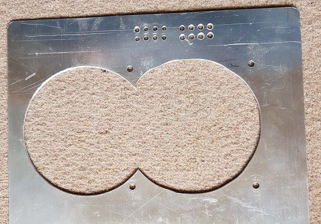

        Got the hole cutter and done a test

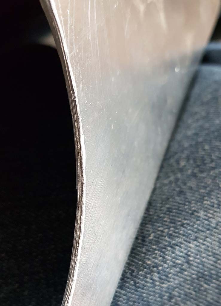

        Left hand hole is hole cutter and right hand hole was jigsaw. The left hand hole is much neater
        This is the finish which can be flapp wheel cleaned up

          Quite respectable Petrolhead, i would have expected much worse.
          Maybe the grade of aluminium, i always get the cutter deflecting to one side.
          Those that intend buying new hole saws the Bosch quick release and arbor are the best, last longer and cut a bit quicker than Starret etc. Have and use both types of Bosch White and Blue for drilling through to 18mm thick in 6082.
          I just the hole saw to cut a hole then bore out which brings i back on centre, 18 yesterday and close on 14k holes so far, cant go wrong or i would have changed 25 years ago they work within reason.
