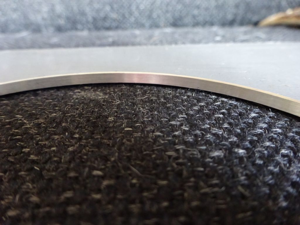

                              #381736
                                You don't need a big head, just a tool out the side, this quick video was done for Ron in his boring head thread but I just used scraps of 2.5mm ali as an example.
                                Not a bad finish
                                Edited By JasonB on 21/11/2018 20:31:52
                                Edited By JasonB on 21/11/2018 20:46:06

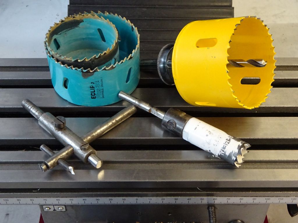

                                  #381739
                                    If you don't know what a treppaning tool looks like it's the one bottom left. That would do the job too.
                                    #381741
                                    Emgee
                                      @emgee
                                      The tool Jason refers to as a trepanning tool is probably what John and I call a tank cutter, originally used in an old fashioned brace, or very low speed power drill.
