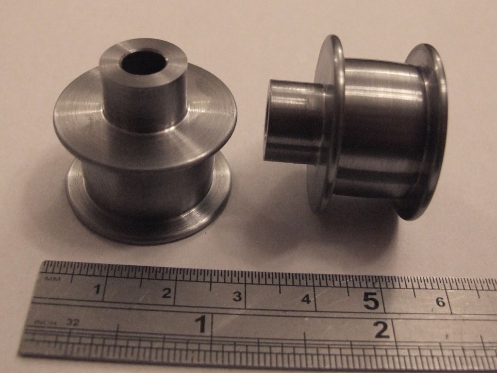

      Just as well I'm not a model engineer. For the crankshaft governor pulley I used a hydraulic copy unit with a hand filed pattern:
      To keep the traditionalists happy the governor end pulleys were done with files:
      The pictures of full size engines that I have show that both ends of the governor belt have crowned pulleys.
      Andrew

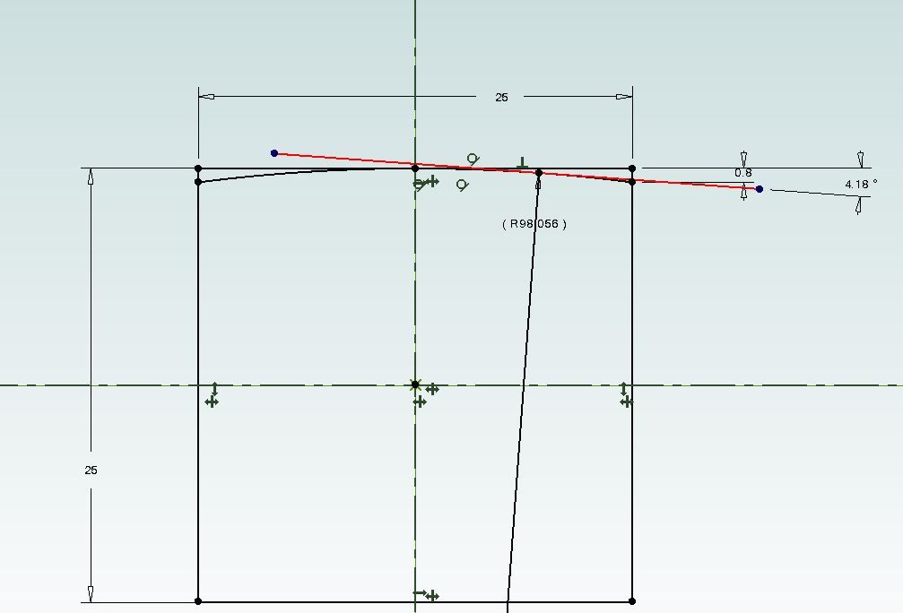

          Out of interest for a 25 x 25 pulley using the table you linked to the radius that a ball turner would need to swing would be 98mm and the tangent angle in the region of 4deg, quite different to the 1.5deg that looks right.

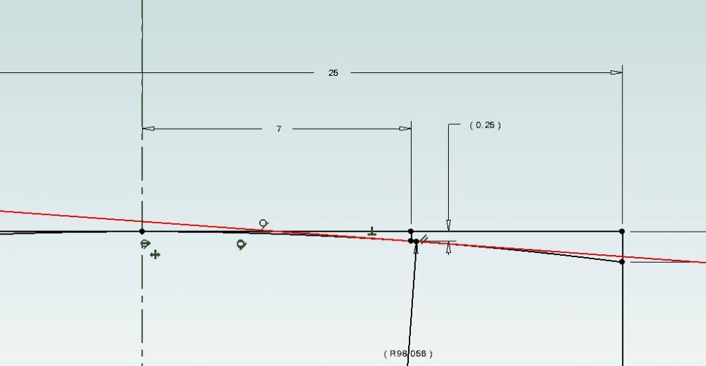

            Just to try it out with the formula that made sense to me for a stepover at 7mm from ctr line
