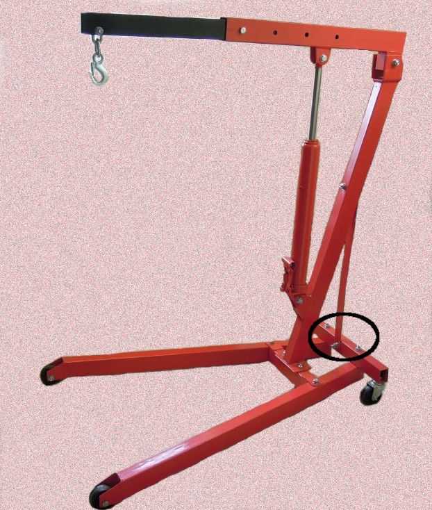

                                Looking at the crane I think it's designed to fail close to the ground at the rear.
                                The side struts and front wheels are suspended from the rear cross-bar and wheels by two bolts, circled in black. This construction is much weaker than resting the struts on top of the cross-bar because this way round the bolts can pull through the holes.
                                I think the weakness is deliberate: if the crane is overloaded the bolts break through the top of the cross-bar and the whole rear of the crane drops an inch on to the ground, where it rests safely. At this point it's very obvious the crane has broken and most people would proceed with caution!
                                I guess the rest of the crane is designed to the same common safety factor. To take more weight the hook, chain, beam dimensions, pin joints, welds, axles and ram would all need to be upgraded. That is rebuilt as a bigger crane.
                                Anyone care to try breaking one to see if I'm right? (Please don't!)
                                #525998
                                Sam Longley 1
                                  @samlongley1
                                  If it were to fail I would expect the rear castors first. That would put side strain onto the jib & cause rapid twisting & rotation causing miss alignment of the ram. the jib section would no longer be square to the load & twist further allowing further rotation & then bending failure & tipping as the load swung outside the limit of the feet
                                  So i would look at better wheels then a couple of side stays to support sideways movement & twisting of the vertical jib section.
                                  Possibly bolt a cross stay to the feet to increase width to prevent undue tilting sideways & fit the supporting stays to that
                                  However, if one has only a single job & one does not even know what it is going to be, then the exercise seems pointless. Hire a more suitable tool

                                    When the crane is loaded, the short cross bar between the legs will be subject to torsion, while the bolts retaining it to the legs, and those at the top and bottom of the the tie (Between the rear cross bar and the back of the semi vertical beam ) and the pivot for the jib will all be in shear.
                                    The only beam that will be most weakened by the drillings for the bolts will be the cross beam at the rear. This is the only part where a hole is through the vertical face, which is the more important part of the box section beams.
                                    The flat upper and lower faces of the beams contribute far less to the vertical strength than the vertical faces
                                    The upper and lower faces prevent flexing in the horizontal plane, and so should be less highly loaded in a device intended for lifting..
                                    BD^3 / 12 and all that.

                                            If any of the three bolts inside SOD's circle fail the sloping upright is no longer tied down, all the load will go into torsion of the other cross member which will probably fail, and the load will fall to the floor, hopefully not on the OP's foot.
                                            I used to design lifting equipment as part of the day job. As others have said if you want a bigger lift, buy a bigger hoist, or even better hire one unless you want to use it a lot

                                              Engine cranes are and should be designed to fail around the arm ram joint or locking pin for the arm extended. The load should fall within the crane footprint, no bolts either side should fail first as it will have a tendency to throw the load out to one side and topple the crane. The reason a crane can have such a low lift weight is with the arm fully extended, all crane advertised load is with the arm fully retracted. NEVER modify lifting equipment, or substitute parts unless that is your day job in which case you won't be asking on here.
                                              If the load is so heavy and you are just moving it, chock up the load and get skates under it. The original post never said much about the load, how heavy, or much heavier than the crane rating, or how high the lift needs to be.
                                              After a heavy lift or buying secondhand, always inspect the crane for paint for cracking or flaking, any deformation around pins and fasteners. The truth is we mostly estimate the weight we are lifting and I suspect a few of us, my self included have gone into our reserve margin on occasions. Be safe and have a plan for things going wrong.

                                                Castors on the rear are a necessary evil but if you have castors on the front it will become VERY dangerous and difficult to control. I would hope that the hydraulic cylinder has an overload valve that would prevent more than the design load being lifted, – though I doubt it !
                                                It's JUST fit for the load it was designed for and NO MORE. If you need to lift a heavyer load get a bigger machine. As others have said, do not try to alter this machine, it will be unsafe. Noel
                                                #526070
                                                  As Noel says I would have though they should be designed to" fail" at the ram long before structural failure, simply by the rating of the ram only being able to lift the quoted SWL plus a bit of give and preventing an overload. Hence why I mentioned the ram early n in the thread.
                                                  Anyone got one to see what is written on the ram?
