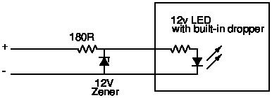

                              Suggests a cure as per Robert's Zener, just in front of the Tim's 12v LED, eg.
                              The circuit is a simple voltage stabiliser, with the Zener shorting out anything over 12v. Self criticism, the zener and 180 ohm resistor powering the oil-pressure gauge lamp will soaking up whatever excess the dynamo happens to be chucking out. Might need to be generously rated. An oscilloscope would reveal all.
                              A better solution would be to put a modern stabilised power supply across the dynamo and use it to provide clean power to anything remotely modern on the car. I think the box I recommended earlier has a good chance of fixing Tim's problem.

                                #490787

                                  And the voltage regulator is not a pair of relays under brass lid – it is a bunch of electronic gismos sealed in an aluminium slab – from: Dynamo Regulators in Fareham, Hants UK. I will enquire of them about the likelihood that their box of tricks will cause my problem. It is 100% better than the original system, charging the just-started battery at about 8 amps for about a mile, and dropping back to about 14V at anything above a slow tickover. But remember that the dynamo is charging all the time, and I can use the car without turning the LED on, and turned off back in the garage the LED still works OK. Looking at the failed LED, there is no difference, no melted plastic, no gaps where wires used to be. I do not have a microscope to peer at the actual source of the light. Neither have I tested the bulge in the LED wiring which I guess is a resistor – another job for next time in the garage.
                                  The problem I anticipate with your 12v Zener is that it is connected across the battery and dynamo. The battery sits at 12.7v when 'off' but on charge is at least 13.8V, so perhaps I need something more like a 16V Zener ?
                                  And the car is not ideal for posh TV shows – it is a two-seater with mother-in-law seat in the back. And the hood, when up, only covers the front seats.
                                  Cheers, Tim
                                  Hi Tim,
                                  No you don't need a higher voltage zener. the additional 2 or 3 volts is dropped across the 180R resistor This "wastes" about 0.05 W (50 milliwatts) of power.
                                  I think your problem is the LEDs are running at maximum at 12 V and the 13.8-14.2 V of a modern regulator plus any spikes from other loads is the last straw. The 180 ohm / 12V zenner circuit ensures the LED and resistor nver sees more than 12V (you could even go down to 10 or 11 V which will further protect the LED and reduce any flicker from voltage variation. One advantage of this simple ciricut is it protects itself. If you use a voltage regulator IC you really have to add diodes and capacitors to protect the IC.
                                  SOD,
                                  Thanks for doing the circuit (and credit). I looked again at the unit you linked to. It seems to be specfically for German cars and reversing cameras powered from the reversing light. It appears some models use some kind of PWM to the light. I'm guessing here, but it's probably a series diode and a electrolytic capacitior to give smooth DC at low current.
                                  Robert G8RPI.

                                        Posted by SillyOldDuffer on 15/08/2020 17:15:31:
                                        Whatever you do; don't give up the day job!
                                        The LED is the wrong way round. Even with the LED the correct way round the Zener won't do anything against positive spikes. If there's 12V across the Zener there will also be 12V across the LED and since current in a diode is an exponential function with voltage that's a lot of current. In practise the resistor or LED will most likely fail long before the Zener breaks down.
                                        Against a negative spike the Zener will protect the LED as it acts as a normal diode with a forward voltage characteristic much lower that the reverse breakdown voltage of the LED.

                                                I really, really, hesitate to second-guess Andrew but I think SOD's circuit, though flawed, could indicate a simple solution.
                                                The LED symbol in SOD's circuit is the wrong way round, as Andrew says, but it's also a simplified version of reality. The LED that Tim is using has a series resistor or other circutry built in, as supplied, to render it suitable to run off a 12 v supply. The zener circuit (once corrected) supplies 12 v whatever the input voltage, as long as it's > 12v and within reason ,Then the LED should light happily?

                                                    Posted by Rod Renshaw on 16/08/2020 11:18:58:
                                                    If that's the case then I agree that the Zener might do something, albeit not necessarily that useful. The problem with Zeners is that they're not overly precise, the knee is quite soft at low breakdown voltages and they have a temperature coefficient.
                                                      Too late for the day job, I'm retired. That gets me Bert Ashton's tee-shirt: I'm entitled to strong opinions, even if they are wrong…
                                                      The LED being the wrong way round is a fair cop, I forgot to rotate it.
                                                      sad
                                                      However, the circuit works because although I showed Tim's LED as a single device, he's using a 12v LED, ie with a built in dropper resistor.
                                                      The full circuit, polarity corrected is
                                                      I don't see any way the boxed LED can get more than 12V because a conducting Zener will pull the LED-side voltage down through the 180R dropper. A half watt Zener and resistor would safely drop a continuous 20V overload to 12V, so should deal OK with spikes. I agree an oscilloscope is really needed to confirm what's going on, but the Zener circuit has a good chance of fixing it.
                                                      Interesting point about Zener Diodes really being Avalanche Diodes, but it's in the same class as the Tomato being a fruit, not a vegetable. Was an OCP71 really an OC71 with the paint scraped off? How I miss the good old days!
