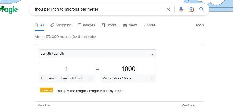

                Does it really need a calculator, as DC31K says you should be able to multiply by 1000 in your head but first hit on google gives a calculator where you can fill in the first box and get result in the second

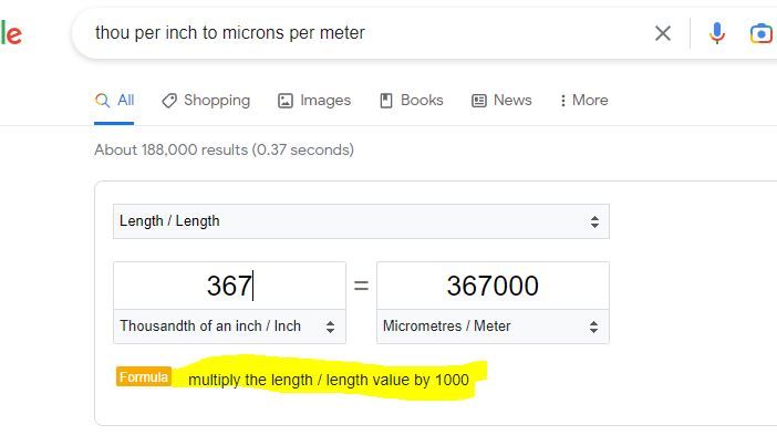

                              "The sites I have discovered appear to be limited to straight forward unit to unit conversions as opposed to a unit/unit to unit/unit conversion."
                              Here it is entered into that online calculator I posted yesterday as you can see just multiply the imperial by 1000 which should be possible in your head
                              Or if you want to do it long hand you can see that the answer is 1000 times larger than the original imperial value
                              So as a practical example if the OP has a Taper as Bazyle suggests of say 367thou / inch (0.367/1) then in metric that would be 367,000microns  / meter or 367mm / meter. or 0.367m / m which sounds rather like the imperial length/length we started with. Plot it on CAD if you need proof that the angle is the same.
