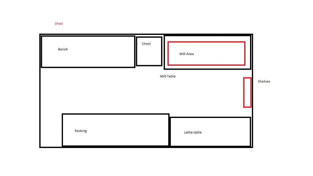

        Thanks for all the advice. I did take some pictures to show locations, but I've left the phone upstairs during the just past yoga groaning session.
        In place here is a terrible drawing
        Yes. Someone who still uses paint! Shed is around 8 foot by 16 foot.
        The pre-collapse shelves were on a spur uprights on 38x22mm batons. Most were 5 inch wide with the bottom two or three being 8 inches. Even with the mill table fully to the right I can easily get to the wheel. I've emulated some racks with some bits of across the shed where a rack would be timber (the offending batons!) and I simply wouldn't be able to get my hands on the wheel (without the yoga being a lot more successful than I expect, anyway!).

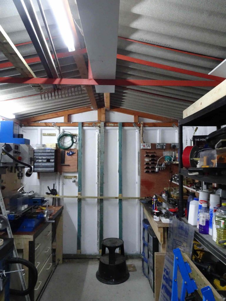

            So here is the result of my deliberations and your help.
            The end wall with batons reaching the horizontal supports for the roof. This time I put batons across at the bottom and middle to apply pressure to the glue. Batons at the top fixed with a shortish screw.

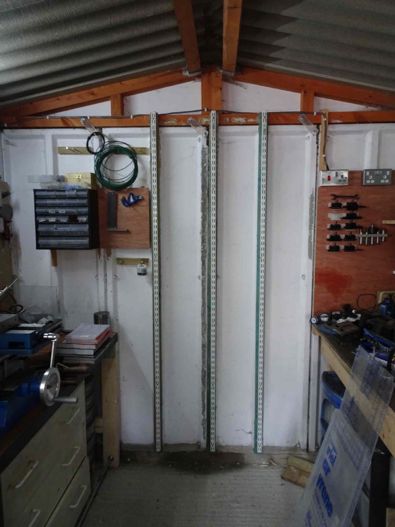

            Shortish screws removed and spur uprights screwed in

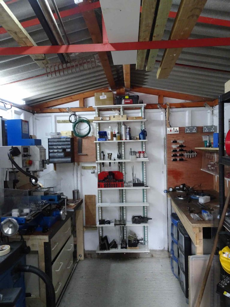

            And after a couple of days to make sure it sets, the shelves added and filled.
            This led to an uncharacteristic organising spree. But we all have failings.
