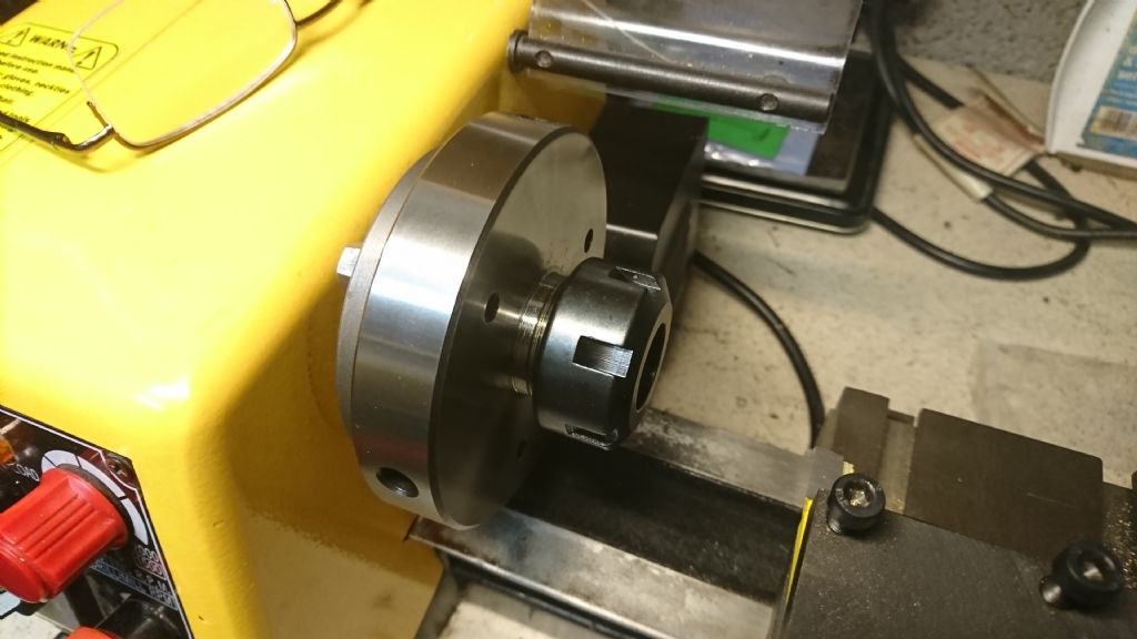

        Well, bit the bullet this morning and placed an order with ARC for the ER25 collet chuck along with a few other bits and bobs to make the order up to £75. Two of which will allow me to fabricate a 10mm bore 36 tooth change wheel to make the switching between 1 and 1.25mm pitch on the leadscrew easier

          Delivery from ARC today, will hopefully fit the chuck to my lathe this evening, just got the m6 studs to fabricate and loctite in place

                Ian Mellors
                  @ianmellors72388
                  Fits like a glove
