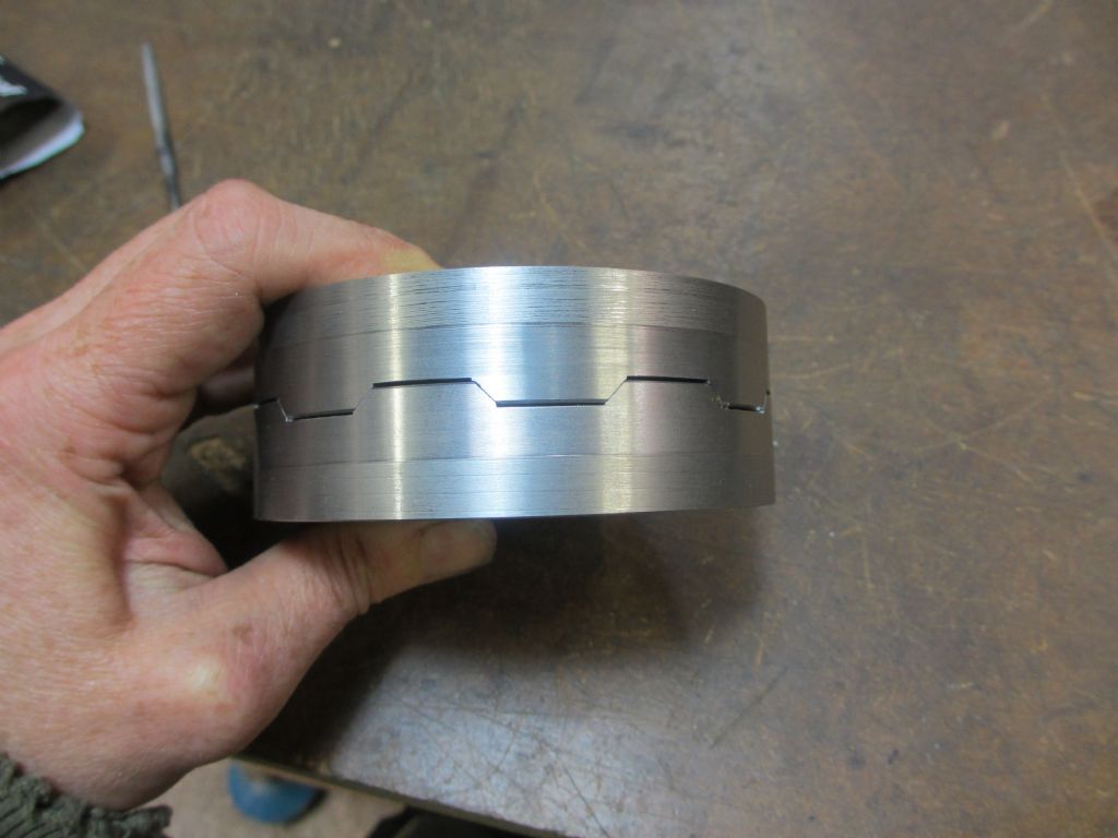

Are you using any wavy bearing springs in your spindle pack at all? Or any spacers between the bearings?
A very nice project. Be interesting to watch the progress. Thanks for sharing what you are doing.
Neil, no springs, etc in the pack, I am not sure what you mean by tween' spacers – If you peruse the (many..!!) photos the assembly may make sense – the bearing cups fit snugly into the rebated bore of the headstock, and are separated by the rebate ( the boring of which in the mill can be seen in some of the photos). The bearing cones , on the spindle, then fit into opposite cups in the conventional manner, with the combined sheave pulley/pre-load nut holding the assembly together. All running in oil. There are oil spinner/flingers at each outer end, with O-ring seals in the outer headstock flanges, also seen in the photos..
I hope I have not missed something obvious in my 'design' here!
Joe
The idea of the wavy springs is to put a preloaded amount of tension onto the bearings, but does leave a small amount of movement with a large load. This is to allow for expansion if something gets hot or cold, the assembly does not jam up. The inner sleeve idea is that the pre tension load is determined by the sleeve length. So you can do up the rear nut holding the pully etc, but are not effecting the bearing preloaded state. Quite often the spindle bearings will come with information on the amount of preload that they should be, and the amount not to exceed. I can't remember what the N value of the springs are, but they use them in a lot of electric motor bearing installations.
Ok, I understand – I have basically followed the same construction as in the headstock on my Emco V10P lathe – and as is, I suppose, in most minilathes with taper roller bearings. The headstock body is a large chunk of aluminium and should help conduct heat away reasonably fast – in any case, the lathe won't be production standard..!
Joe

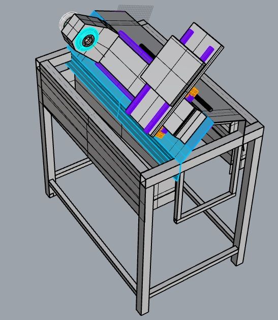

The Base frame as proto'ed in CAD

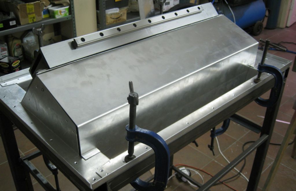

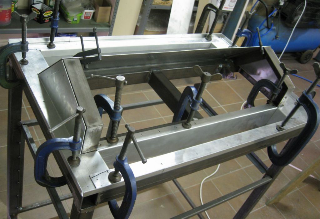

Fair progress made on the base frame and its cladding – base frame became a priority so that I can have it painted and then mount the lathe bed and start on the X and Y axis structures. The lathe bed needs to be in-situ to begin fitting Axis drive motors, etc.
The base frame is made such that fore and aft of the lathe bed are two sluice cavities down which swarf and suds can spill, into a full frame sized tray under the lathe. The tray has a belly pan, leading the suds to an outlet pipe, into the suds tank – all that still to follow in coming months!
The render shows two trays, but that has changed to one big one.

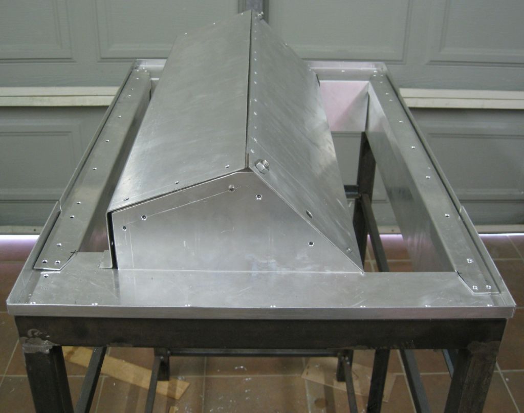

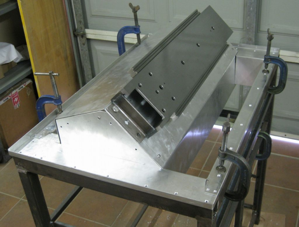

The top aluminium cladding fitment:
Cladding in place – Sluice cavities can be seen below.
Lathe bed trial placement:
rear View of Bed and base frame.
The frame sides cladding is also complete. Will be fitting and drill all the pop-rivet holes on the weekend. Then a clean up, de-burr and off to the powder coaters..

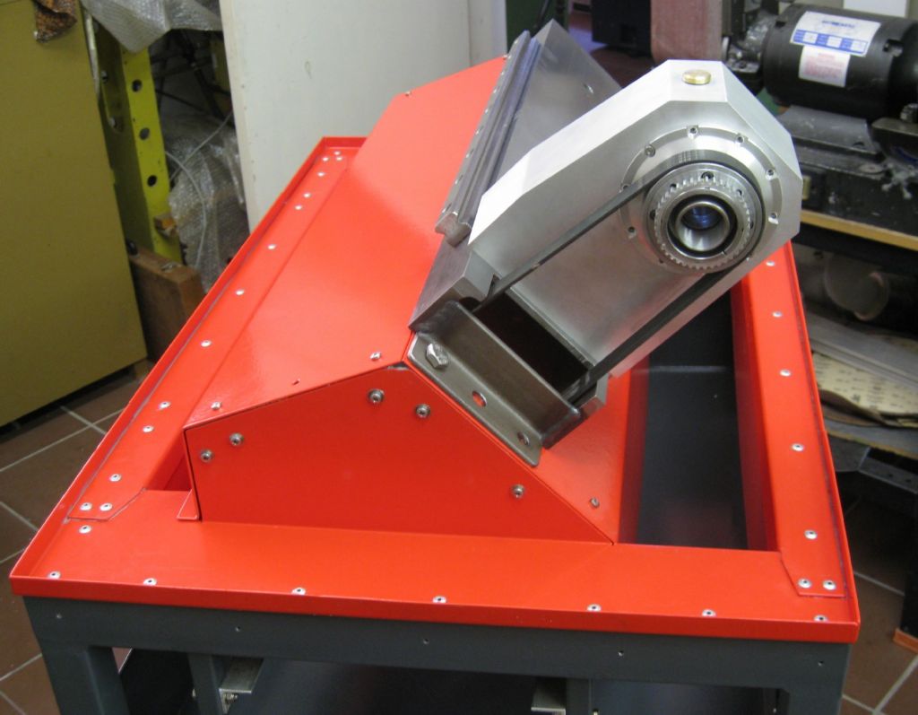

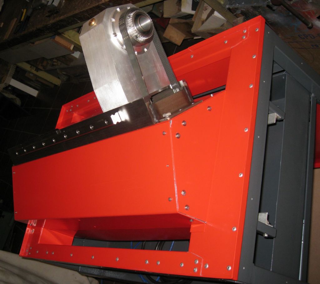

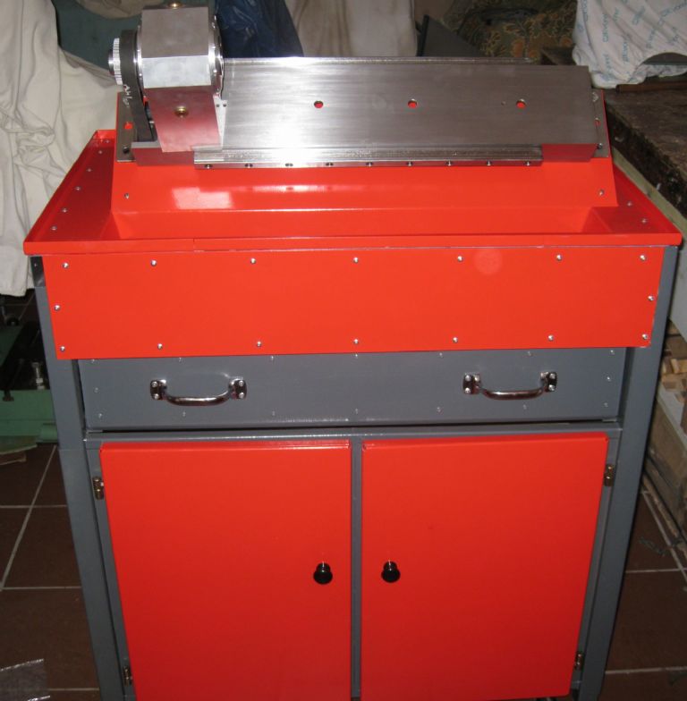

Lathe Frame and cladding back from powder coating, and part assembled.
Front View:
Lathe bed and headstock fitted.
The Grey horizontal part with the two horizontal handles is the Swarf drawer / coolant drain . The Swarf would be persuaded to go down the forward and rear swarf slots, seen in photos below as does eventual full flood coolant. The drawer has a shaped base to lead coolant to a drain hole, back to the reservoir and pump.
Left side view shows the front swarf slot – about 150mm at the mouth.
The Rear swarf slot, 80mm at the mouth.

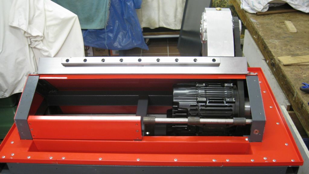

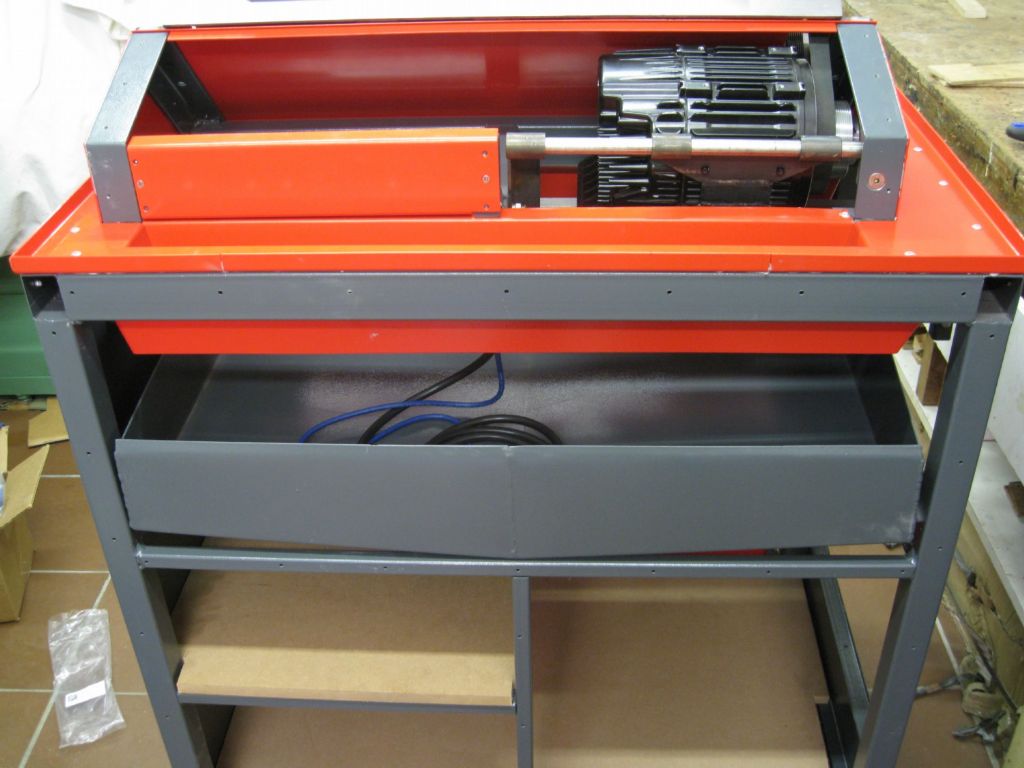

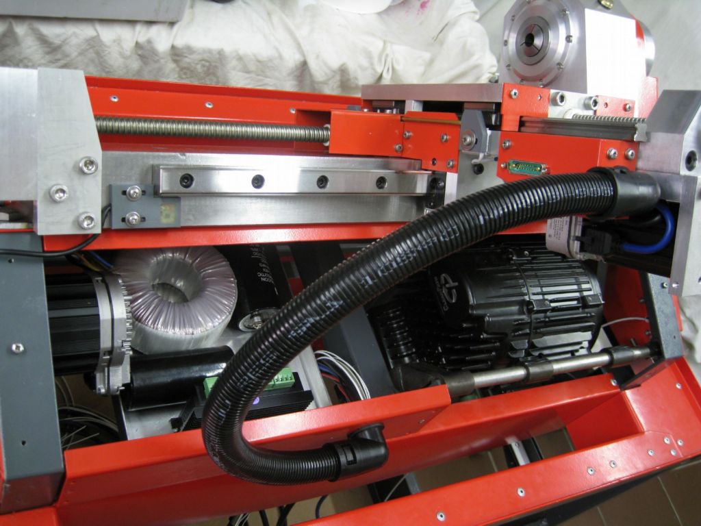

View under rear slant cover showing the Brushless 2KW motor – driven by step/direction pulses, with a 12000 step/rev resolution – will serve as the C axis as well eventually.
View of the rear wall, ( cladding to be fitted still) – shows the swarf drawer and its slope.
Lots to do still – On the cabinets – coolant drain, reservoir, pump, Electrical box and wiring, Upper cabinet sliding enclosure for splash guard,.

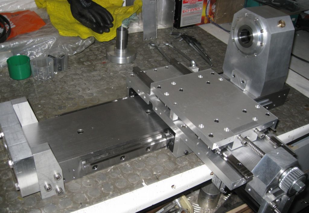

Most of the major part manufacture for the lathe proper is done – some small items left to do – ballscrew to ballnut mating seals, pulley keyway broaching, etc..

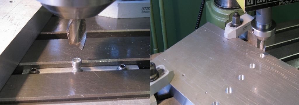

Doing the counterbores on the X axis slide plate / carriage –
Made an under-pin fitting into the mill slot, over which the thru-hole in the carriage plate slips, and then the plate is clamped to the mill table. The endmill, used to counterbore for the capscrew head, is centered over the pin. So, plunge, unscrew clamps, lift plate and slip next hole over pin, clamp and plunge.

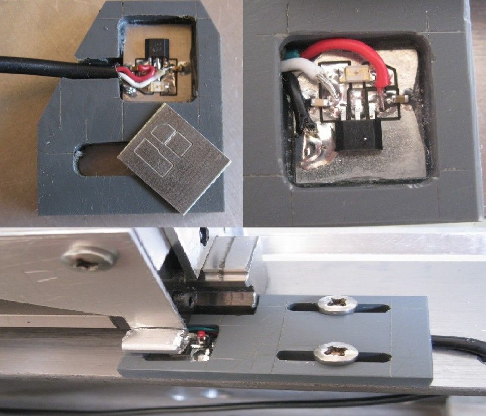

The X and Z axis limit switches where a bit of an issue – all the readily available sensors are rather large – mostly the tubular/cylinder style, and make an unsightly fit – so made up some Hall sensors which work very well, and fit cleanly. – these to be encapsulated in epoxy resin.

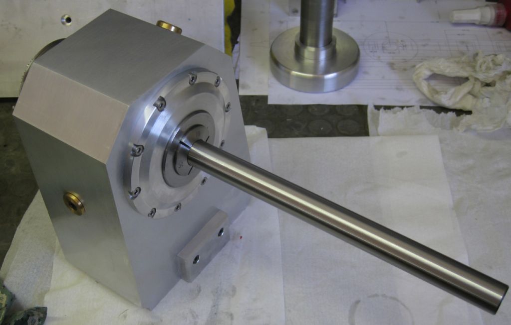

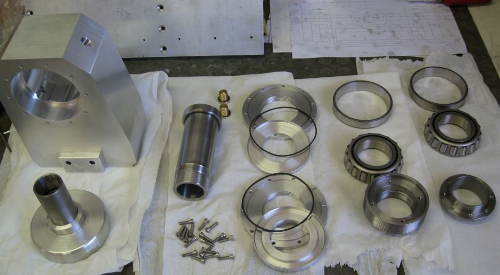

The headstock is all done – pulled the cheap Indian test bearings out and cleaned all parts, inc the final Timken bearings, oiled and assembled – feels soooo smooth!
19mm collet fitted with a 19mm ground test bar fitted to check runout. Bar is 300mm long, 0.005mm runout at collet, .012 at bar end – need to investigate that…
The small square plate at the base of the headstock, below, is the Z axis hard-stop for homing Z.

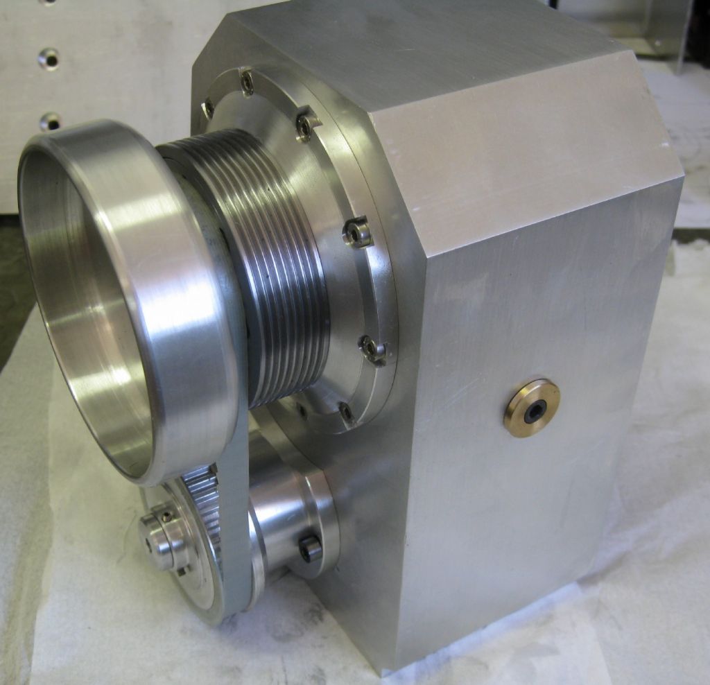

Manual collet closer wheel and drive pulley sheeve. Rotary encoder below
Brass button is oil filler with breather hole

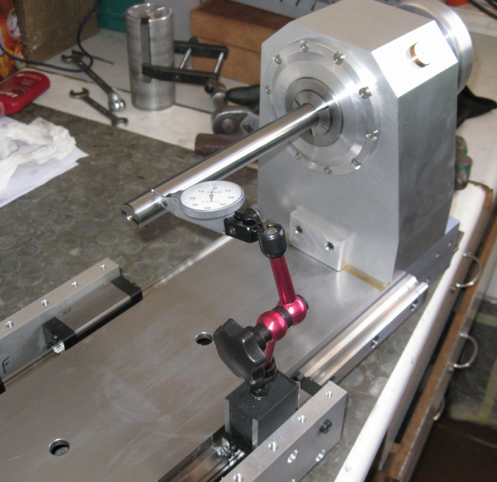

Headstock alignment:
The whole lathe alignment is quite a daunting task.
Headstock nod – to bed in Y and Z = using test bar, with an accurate square ( 70mm diameter x 160mm tall Aly bar, squared off at ends) with feeler gauge to test height to bar at collet and test bar end.
Then Z axis slide rails ( front and rear) height to test bar with dial indicator ( as below).
The headstock rotation – using dial indicator on side of test bar and rotate headstock til parallel.
Z slides are parallel to each other to 0.005 / 0.008mm, ie the steel bed width is parallel.
X axis will be done by machining a face and verifying for flatness.

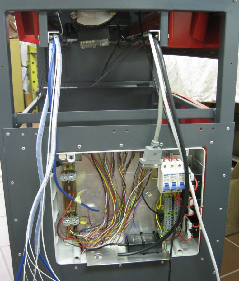

So this last month was mostly spent the wiring, which is 'mostly' complete – I am presently busy buzzing out pin-top-pin against my wiring diagrams.

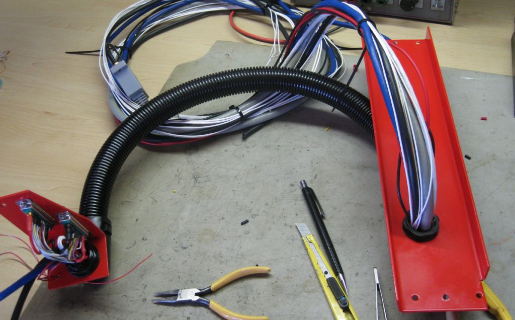

Some photos of the wiring saga:

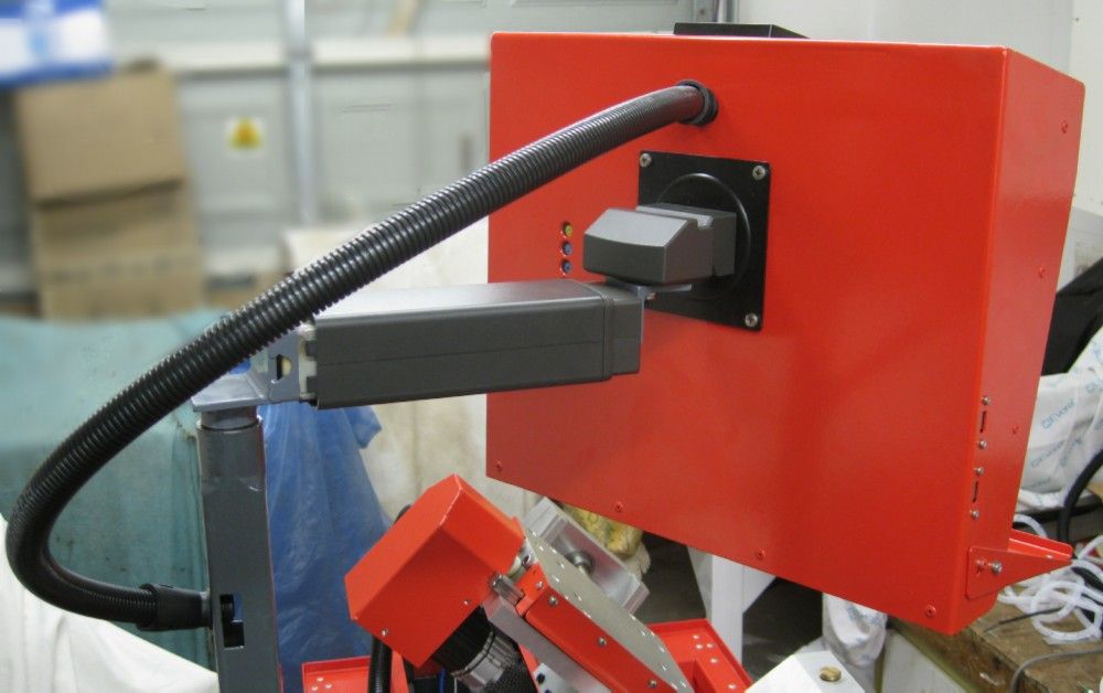

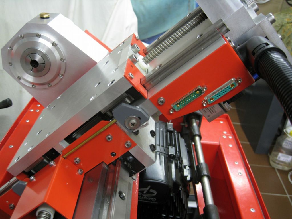

Inside the snake is the Loom to the ATC and Live Tooling connectors on the X axis – carries power and all control signals. Also visible, the power supply feeding the servos and live tooling.
The loom itself:
The ATC/Live Tool connectors:
Connectors to the ATC and Live tooling on the X Axis

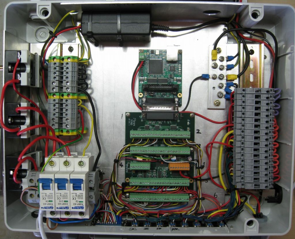

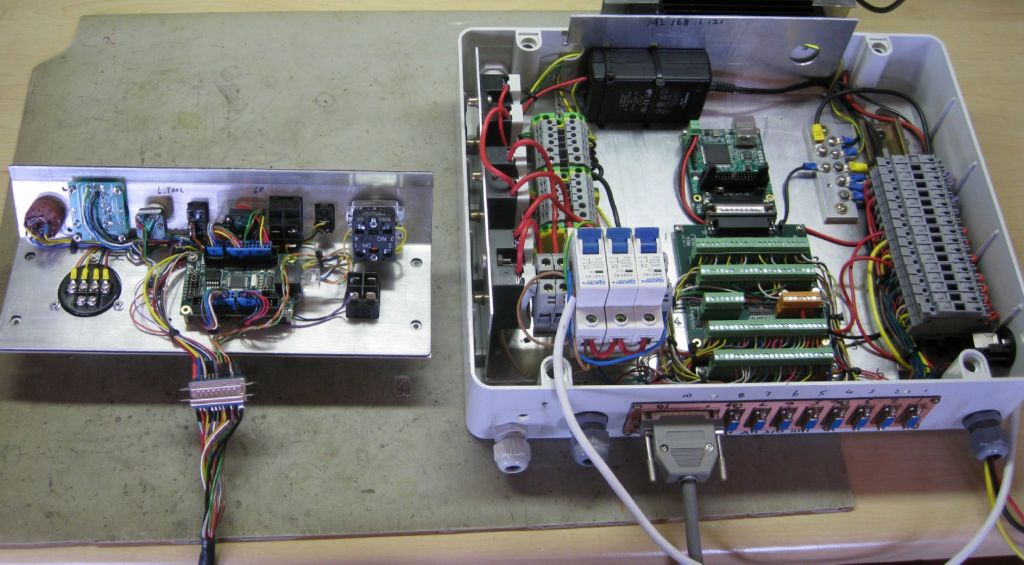

Start of wiring the main Distribution Box..

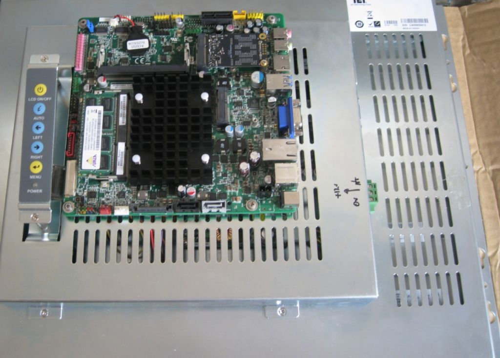

The Mini PC fitted to the rear of the LCD – PC is about 166mm square, 2GHz processor, 4GB ram, 128GB Solid state drive. Connects via ethernet to the MESA controller card

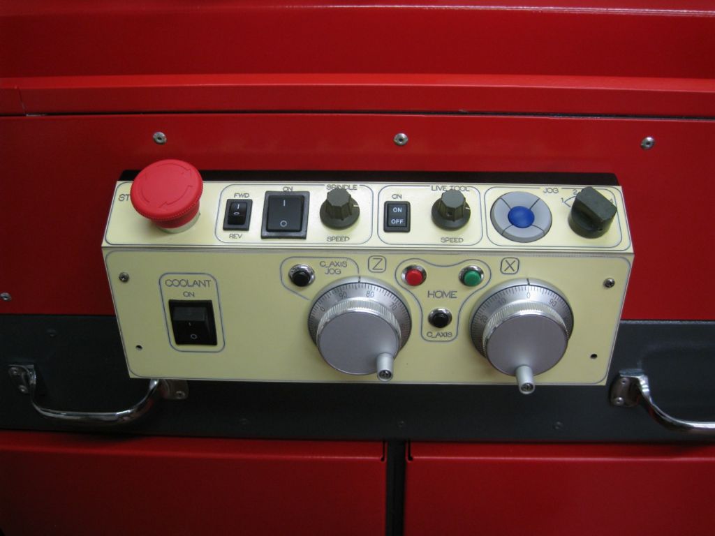

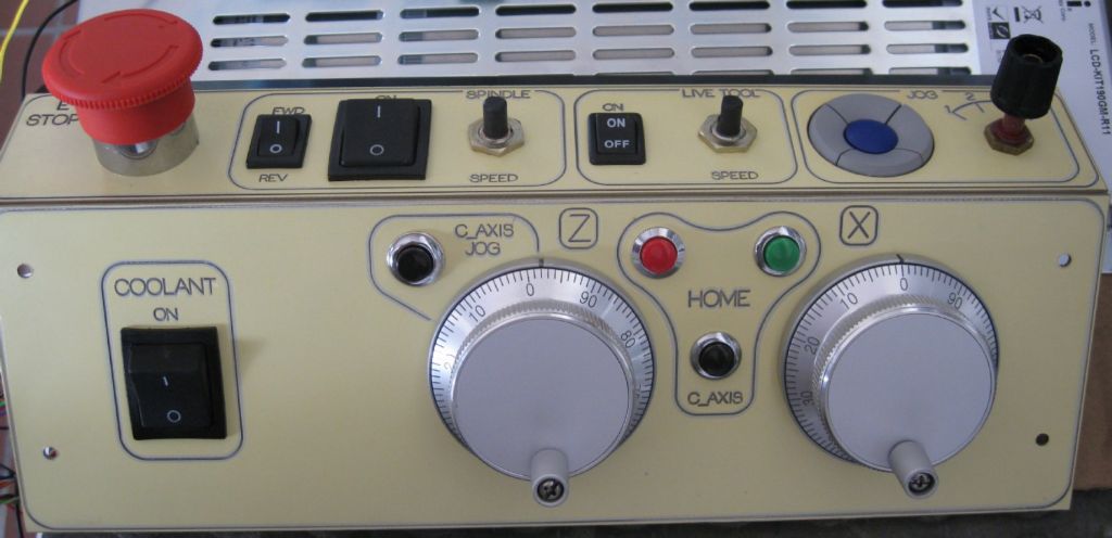

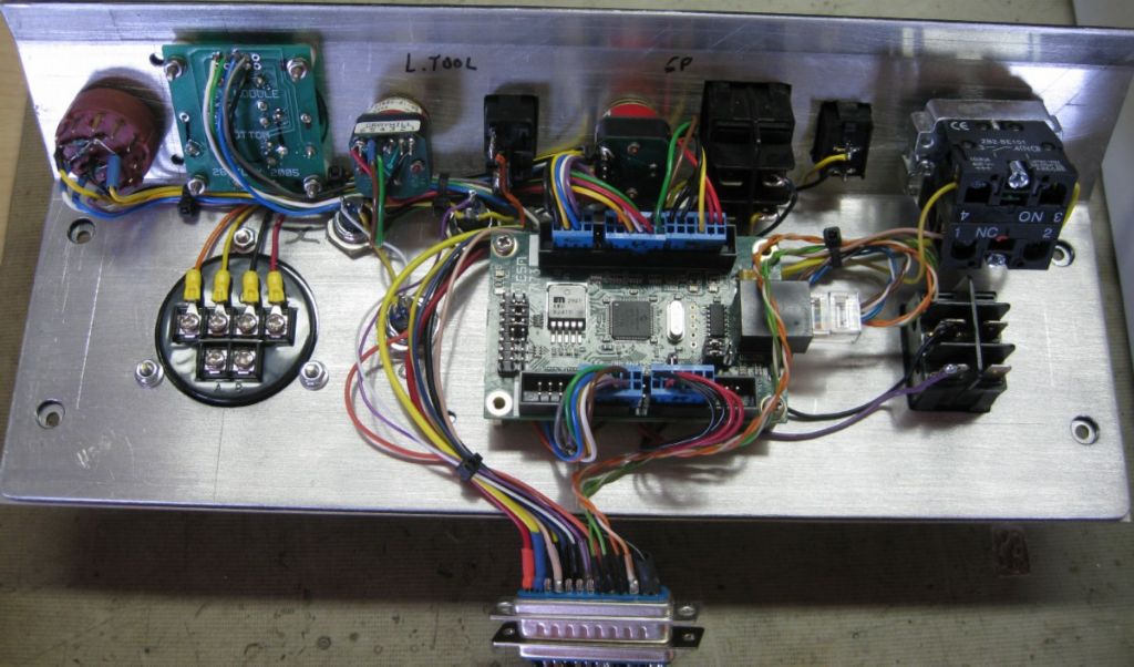

Operator Control Panel ( still short of knobs..)
Distribution Box Wiring 'complete'. The MESA control cards are visible in the central section.

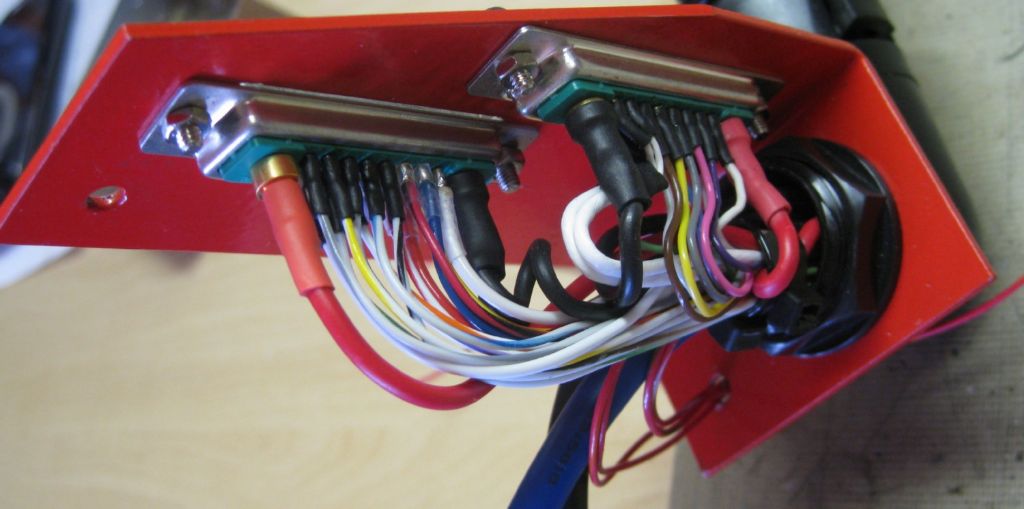

Rear of control panel showing wiring and the MESA 7i73 Module – this module manages all the control panel I/O, jog wheels, etc, and sends the data to the main controller in the distribution box, serially, at 1.2megabaud.
Safety related controls – Spindle/tooling ON/OFF, E-Stop, etc, are wired direct to the main control card in the dist box, or to the Servo and or mains cut for E-Stop.
Dist. Box and Control panel connected and checking pin-to-pin wiring..
When the enclosures are back from the coaters I will assemble the display/PC and connect up to the dist box and control panel and then the fun starts trying to understand LinuxCNC and HAL…..

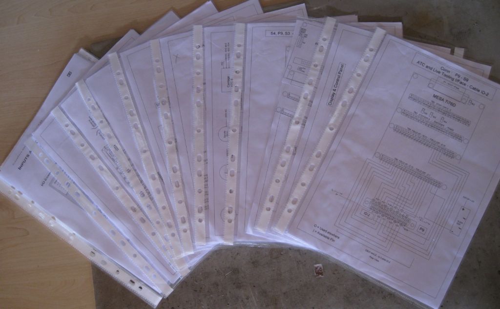

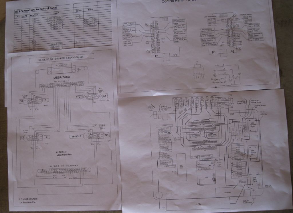

To add a few more statistics;
There are 42 detailed wiring and looming diagrams, and 18 detailed, wire colour coded, pin to pin wiring tables.
There are also 67 mechanical drawings and I have a very detailed , representative 3D model of the lathe, and a useful 3D model of the lathe stand.
sample of wiring diagrams and connection pin lists:

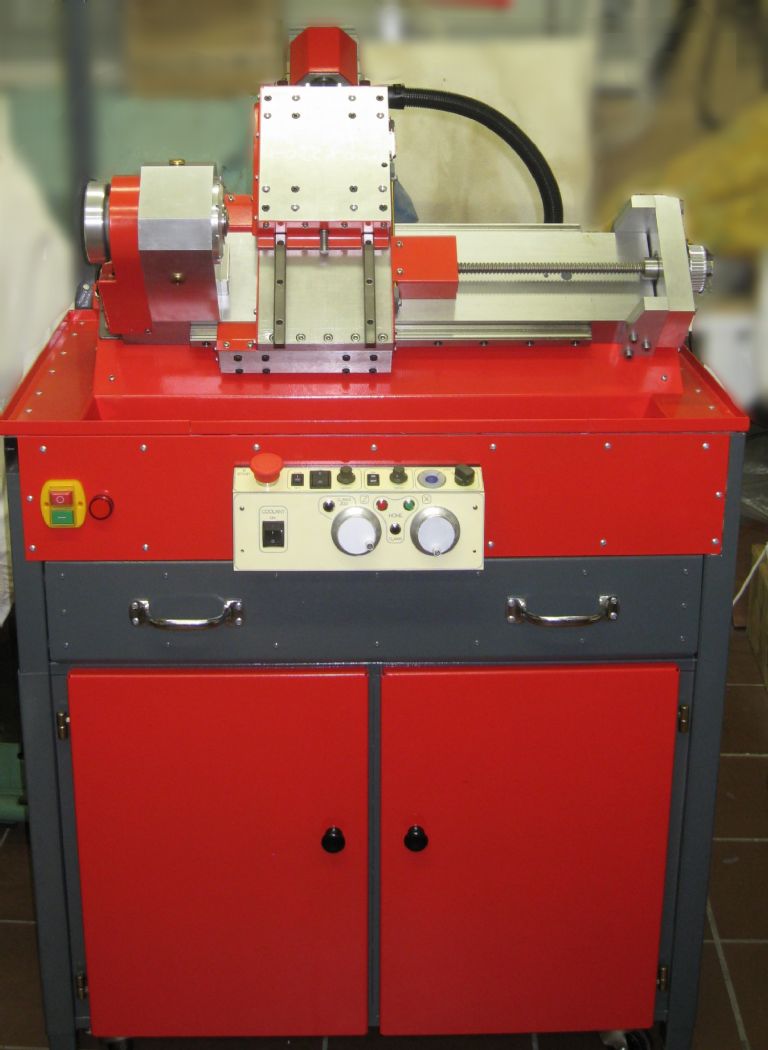

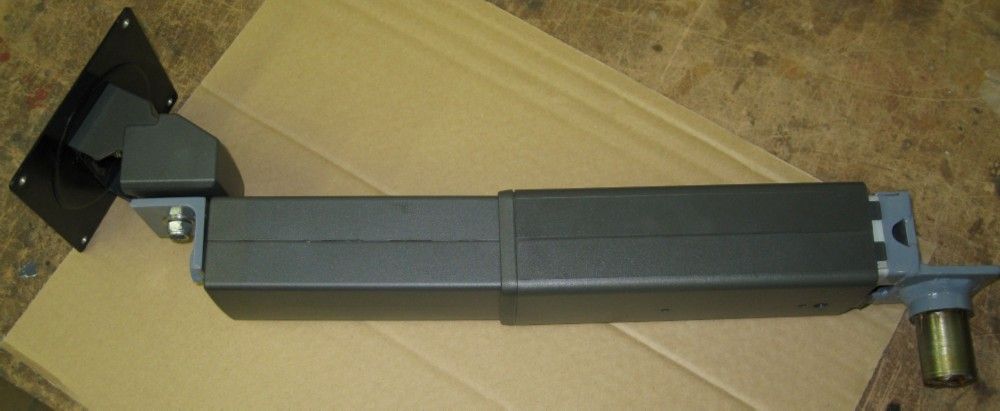

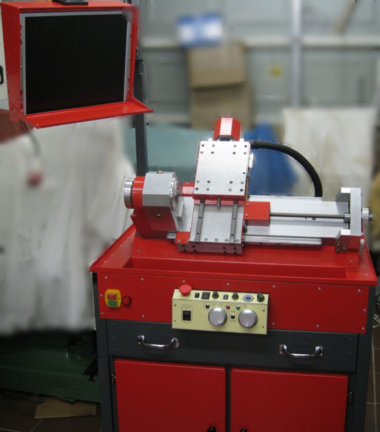

Photos below are now that the machine is in essence together – all mechanics bar the above mentioned are in place, display, computer, etc all done. All the wiring is done, all pins buzzed out, and all controls are seen by LinuxCNC ( HAL_Show) and toggle as required. So now just the HAL file to tie it all together!
Display bezel still not fitted as I need some access still to plug in keyboard and mouse cables..

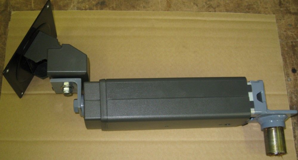

Rear of display – showing the re-purposed LCD desk stand as a support arm
The stand 'bottom' end is now fitted with the rotary joint into the vertical pole, and the stand arm now lies horizontal, extending to the rotary joint now connected to the rear of the display panel. The stand could raise and lower to suit eye height at the desk, and so now extends horizontally instead of vertically, allowing the display to be pulled closer to the operator, or pushed away. The display can be maneuvered left right and all over the place..
The close swivel arm
And extended..

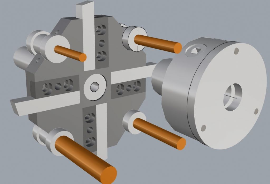

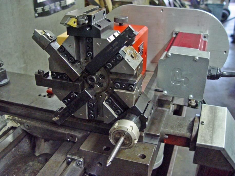

So, having sort of recovered from that project-depression, I decide to begin the ATC design, discussed in the following post..
Joe

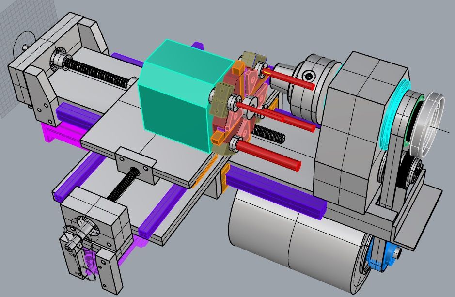

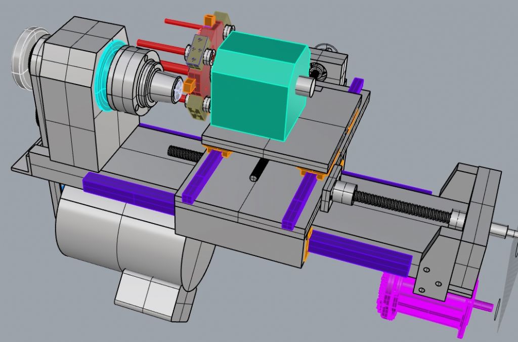

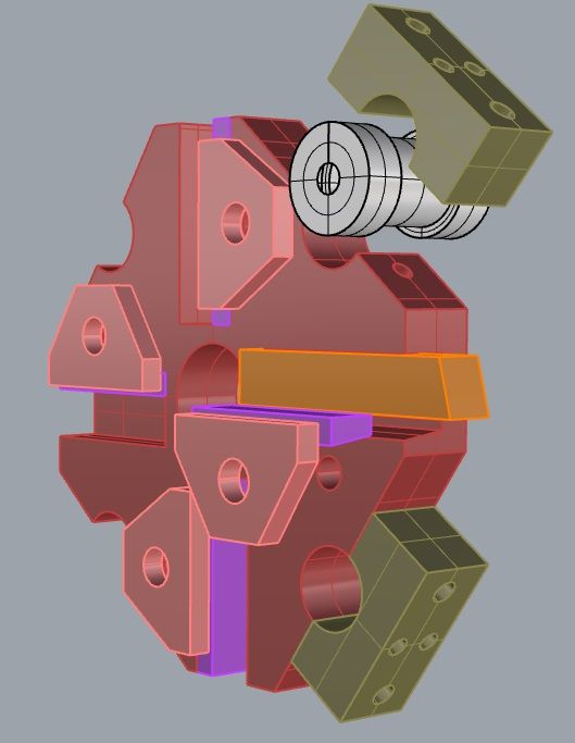

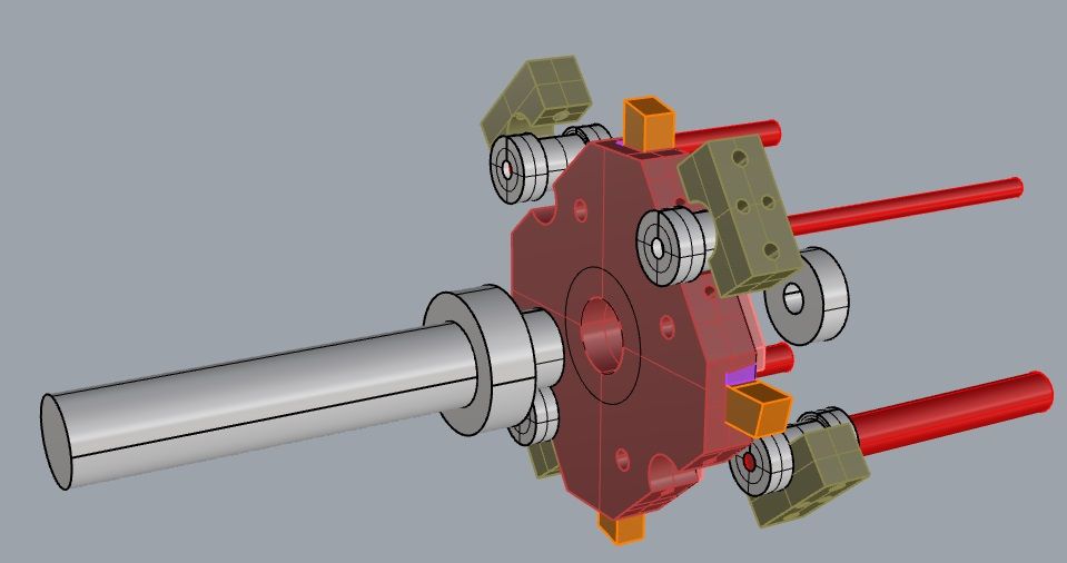

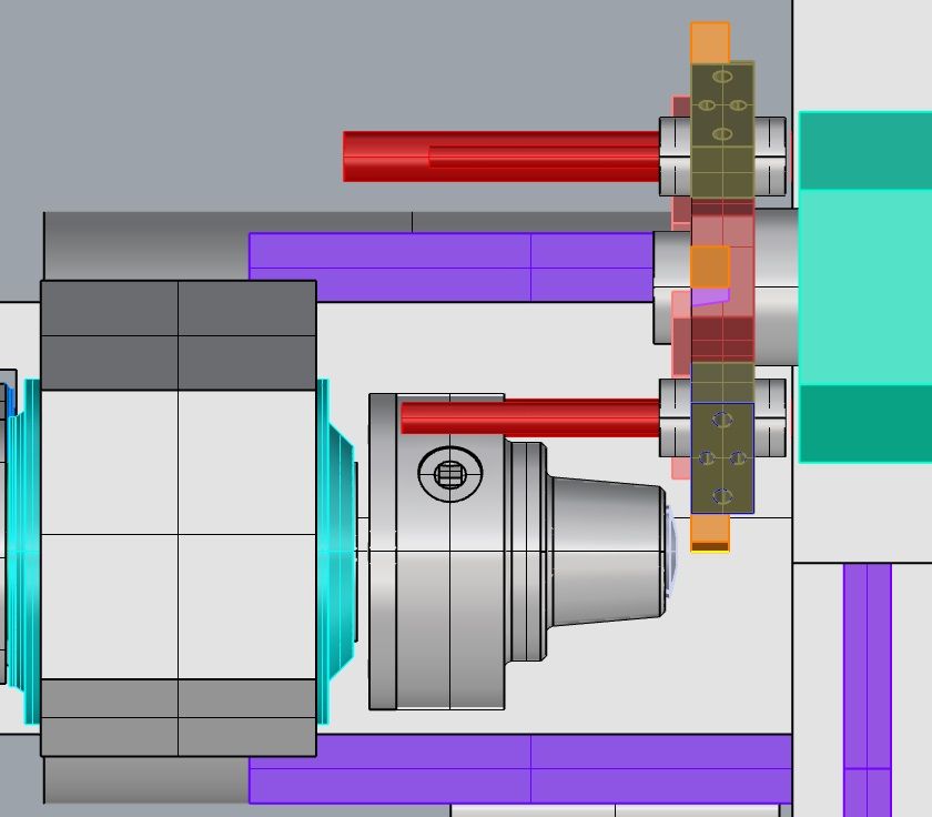

The ATC design is also a juggle of compromises. How many tools to accommodate, Tool clashes with headstock, chucks, etc, choice of inverted or conventional-up tip tooling, etc. Then of course how the changer will actually work – I have not got my head around that part yet!
There are many articles on the internet of DIY ATC's for a lathe, but I fear most of them are, in my humble opinion, simply a hack. The way they are machined, the accuracy of positioning and placement of tooling can only mean misalignment with the spindle axis at the best. I am not sure at all of the route to follow – The positioning and locking mechanism has not a simple solution – it must locate accurately, must lock firmly, have no play which will promote tool chatter, etc.

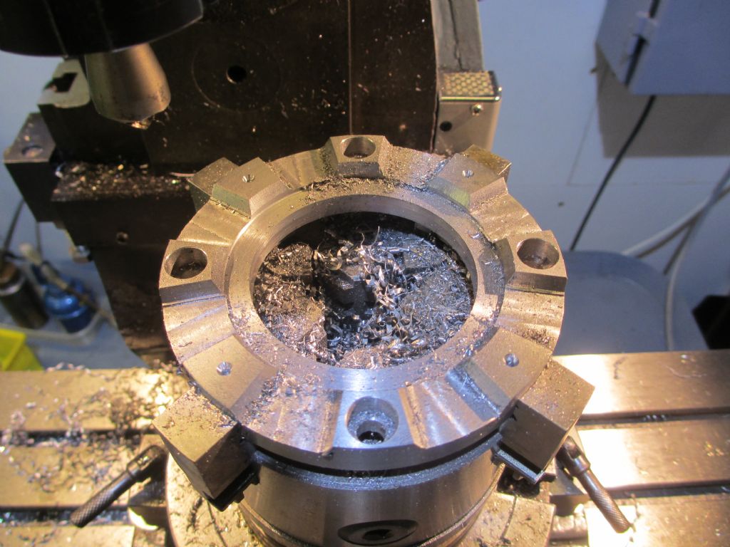

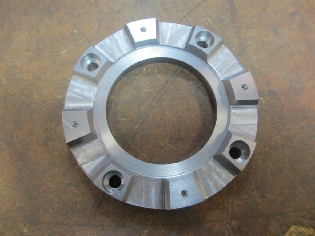

So I started with the simple part – the tool plate..

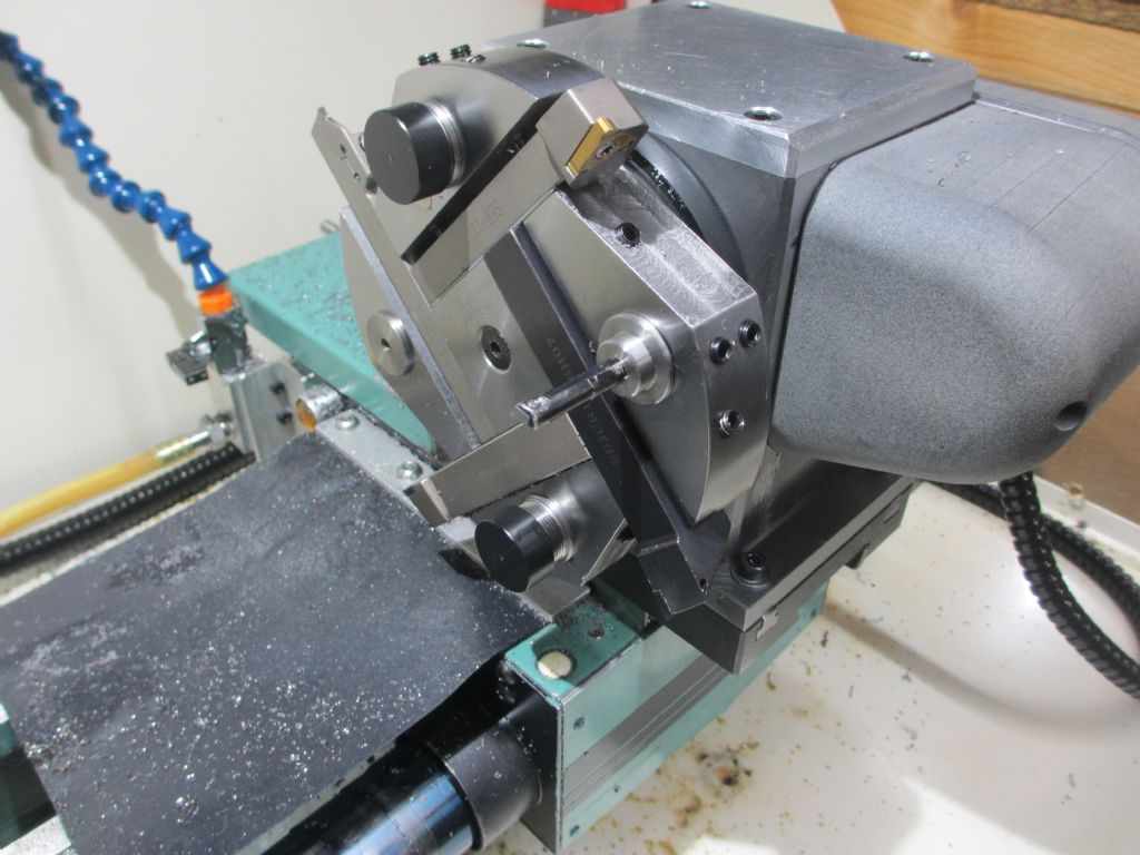

I decided on 8 tool stations, 4 of lathe cutters – normal facing/roughing/profiling tips, as well as threading, grooving and parting tips, and 4 stations to accommodate drill bits, centre drills, boring bars and internal threading tips.
I looked at MANY ATC's out there…
One of the big issues with tool placement and tool plate size, or rather , diameter, is the potential of a crash of axial tools ( boring bars, etc) with the headstock and chuck. Since my lathe has no chuck, that problem went away around the corner, and like LinuxCNC, came around the other way and bit me in the backside! The 5C collet spindle is almost flush with the headstock face, so there is no elongated space for the axial tools to flail about within..They will smack the headstock. The only way to prevent that is to have an axial tool placement radius of nearly 170mm, ie, a tool-plate diameter of more that 340mm – That's Big Haas lathe territory!
Headstock with no room for axial tool bypass..
On top of it, the current spindle implementation leaks oil and all my modifications to the oil well, the labyrinth seals, oil level, etc, have been wasted – it still leaks unacceptably.
So, a new spindle is in the works, with a trial taking place with greased bearings to see how they do for 20minutes at 4000 rpm, etc, etc….And the new spindle will be fitted with a 4inch OD, 5C collet chuck from Bison-Bial..

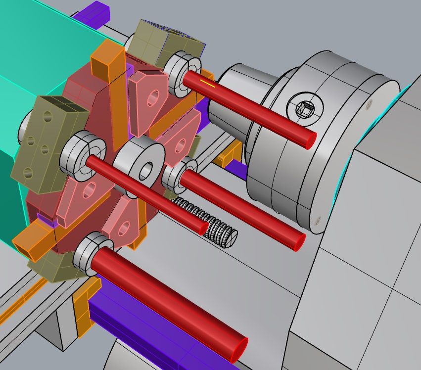

The design of the tool-plate is now a lot simpler, and has worked out nicely. I need to now work on the actual positioning and locking mechanism, but am a little lost – no neat solution apparent at the moment!

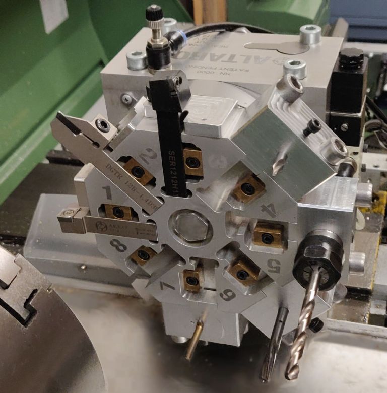

Here are some typical examples of tool-plate layouts – lots of similar to see, but few insights into the gubbins in the boxes..!

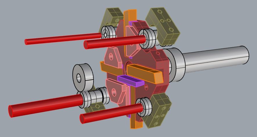

And my 3D models of the present design.( click to see a larger image)
Tools are operated inverted – swarf goes down, not up!
Rear of tool plate with spin-shaft.
Lathe tip-tools are held in place with taper wedges ( lilac below) and clamped with the pink clamps.
The usual method of positioning on industrial turrets is with a Hirth / Curvic coupling between the disc and the body. With that, there are two basic solutions – the disc + half of the coupling moves forwards to clear the body coupling teeth before indexing, or the body part of the Hirth coupling can move axially within the body (but constrained radially) to allow the disc to rotate without "lifting".
Hydraulic operation of clamping is easier, but indexing is a bit more awkward – the Taiwanese all hydraulic turrets on various lathes at work use a complex Geneva indexing method using a hydraulic motor & rapidly "step" between positions. Control is quite simple, though, using a couple of proximety switches to count stations as they pass + a reference position switch & clamp / unclamp switches. A counter in the PLC gives a representation of the disc position, being incremented / decremented by the count switch depending on disc direction. The counter is a "ring counter" preset in the PLC with the number of disc stations that has no zero value. Usually the disc is indexed repeatedly to find the reference switch on the first tool call after powering up – at this point the "ring counter" is preset to the current station number (usually station 1), though some manufacturers make referencing the turret part of the initial machine reference procedure & some others use battery backed registers in the PLC memory to remember the disc position set at the point the machine was powered off, so no referencing required. One Cincinatti machine at work saved the cost of the reference switch by making the operator manually index the turret to station 1 & then confirm the position was set via the operator interface – many ways to achieve the same end !
All electric turrets use one motor to clamp/unclamp using a cam and a belleville washer stack arrangement, then index steplessly after unclamping. This type (variously made by Sauter, Duplomatic, Baruffaldi & Pragati) are mechanically complex and use a lot of precision ground hardened parts + a special absolute binary or BCD encoder for disc position + a solenoid operated plunger assembly for the locking arrangment. They also require quite a fast PLC to run them, as the timing of the locking plunger solenoid operation is critical. Locking is by reversing the motor after the locking plunger engages until a proximety switch actuates. There may also be an electromagnetic brake to lock the motor shaft after the "clamped" switch makes.
It should be possible to do a hybrid – hydraulic clamping with electric indexing – without undue difficulty, I think.
Live tooling drive to rotating tools in the turret is another can of worms to consider ! We have one machine at work with a Sauter all electric turret that has live tooling, but that uses the VDI tool mounting system not square shank tools. I have the manual for that turret that has sectional drawings that I could copy & post if that would help ? I would not like to try and make one, though !
On the turrets here that use a wedge to clamp square shank tooling, there are two counterbored holes & a tapped hole in the wedge rather than the plate you show – the counterbored holes line up with tapped holes in the disc & the tapped hole in the wedge is used to extract it. I think the face mounted wedge clamp shown would be restrictive & prone to collision with the workpiece / chuck. You need eyes everywhere when you have boring bars and turning tools mounted on a tool disc to be watchful of collison risks – you could do without introducing another one.
HTH
Nigel B.
Nigel,
Thank You for the post Nigel – A lot of very useful info there!
WRT your comments on the tooling clamping wedges – This was on of the areas that bugged me – Your proposed method is as on the two turrets I showed at the beginning of my ATC post – The reason I did not go that route ( but have decided to change now..) is simple – its a lot more steel to hog out of the tool plate on my small EMCO FB2 Mill! The wedges and such like are easy – all hogging will be done on the shaper, but the tool and wedge slots are all endmill stuff. But the result is not that elegant. The triangular wedge pressure plate is loose and will flop about when trying to tighten down the wedge, etc, so I decided to go the better route..
The indexing and clamping arrangement is still going to challenge me – There is a good series of article in MEW , by Simon Davies – No's 269-272 – He uses a taper cone interface between the tool plate and base and is rather attractive, but does require the base stock material for the tool plate to be very thick with lots of lathe work!
I favour the Hirth coupling, but I am not sure I will be able to achieve appropriate fit and tolerances – My mill is just on the small side for that size work at those tolerances in steel , if not spending days standing at the mill!
I suppose for this small size of lathe I could get away with an aluminium toolplate, but that just does not seem right..
Live tooling on this lathe is a bit of a misnomer! I intend to have only a single milling spindle, up to max 8mm endmill/drills with the spindle axis at the same height as the lathe spindle axis. The mill spindle will be able to swing so that its axis is either axial or radial to the lathe spindle, ie, you could mill a hexagon on the end of a shaft or a spiral groove into the side of the shaft in the lathe chuck, for example.
The ATC really does not downsize well! It has to have all the features with reasonable rigidity as its bigger brother's do, but fit on a small lathe with much reduced axis motor torque, etc. On top of it, my lathe is a 'slant bed' so the weight of the ATC falls down, affecting the X axis +ve acceleration..At least in my case the workpiece diameter is limited to the 5C collet capabilities, so ATC performance constraints are reduced somewhat.
Thanks again for taking the time to respond in detail Nigel.
We will see where this one takes me!
Regards
Joe
Joe, I have been following your series with great interest and no little admiration of the work that you have done so far. As the author of the articles in MEW, maybe I can add to your comments above:
the taper cone method eventually worked but took a great deal of effort to lock successfully in place. The big chunks of metal were machined on a combination of my Chinese 250×400 lathe and a fully CNC'd BF20 mill. For the tool plate/taper, I think these could be roughed separately and then welded/bolted together to make the finishing less traumatic. The main block could also be a welded plate construction, I ended up with a lot more metal than I really needed at this point.
Locking the taper in position with a fine screw and lots of stepper torque 'just' works- if I revisited it, I would look closely at small hydraulics – derived maybe from classic car brakes or modern bicycle brakes, married to a stepper driving the master cylinder and maybe mounted off the lathe.
If it helps, all of the 3D drawings are available on Onshape in the public area, search for " Toolchanger for Emco 5PC ". Onshape allows 3D to 2D drawings to be derived as well as export in various forms – this includes components such as the toolplate which was directly derived from the Emco original.
PM me if there is anything I can help with directly, very interested to see your project continue to go forward.
Simon
Hi Joe
I built a small lathe ATC a while ago , after experimenting with a pawl and ratchet for a while I went with a hirth coupling design in the end.
I wouldn't be too daunted about making the couplings , mine where made on a Centec mill so not vastly different in size to your mill, while I'm sure there are inaccuracies in my machining of the couplings , due to the self locating nature of a hirth coupling its seems that its still very repeatable to the point where I struggle to measure any deviation in a closed tool position.
In retrospect I think the whole thing is massively over engineered but on the positive side its extremely rigid , I only wish I had made the toolplate to a better design !
I also often use a 4" bison 5C chuck for the reasons you state but still often wish the nose of the chuck was longer so I didn't have to cut down so many stub drills and boring bars etc.
