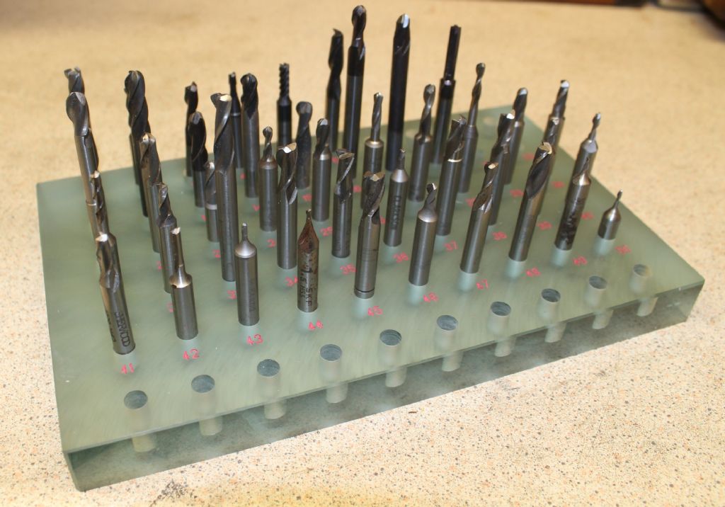

      Just finished making a numbered tool rack for my CNC mill from a “perspex like” material. This was my first attempt at CNC engraving. The “perspex” to my surprise was not flat enough to engrave so I found it necessary to fly cut it flat on the big mill before starting. To give an idea of size the tools are 6mm / .250” diameter.

      Rik Shaw
        @rikshaw
        …….a place for my cutters

          Hi Rick nice job did you cut the holes on same machine.

          Rik Shaw
            @rikshaw
            Hello David – No I did not drill the holes on the CNC. What I did do and what the movie did not show is that the hole positions were spotted with the engraver cutter after the numbers were engraved and were then drilled on my bench drill afterwards. Thanks for your interest.

            Martin Connelly
              @martinconnelly55370
              I am curious to know why you did not drill the holes with the CNC mill. A rectangular array of drilled holes like that looks like a job that really suits CNC.

              Rik Shaw
                @rikshaw
                Martin – Thanks for your interest. I didn’t do the drilling on the CNC as I have not yet worked out how to include tool changes in a machining sequence. The hole positions were just spotted using the same engraving cutter after the numbers had been engraved. This was my first opportunity to do useful work with the machine and I was impatient to see a result.
