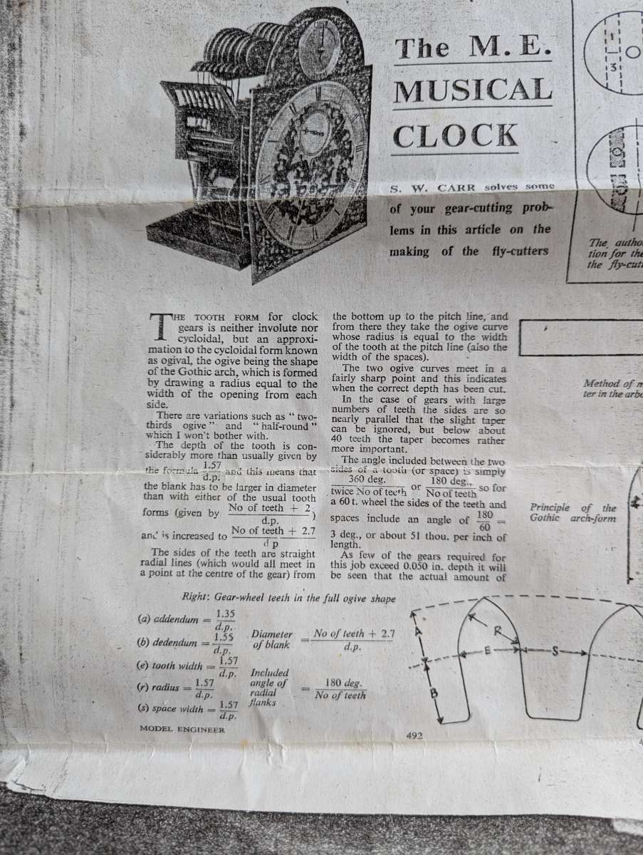

      My main reason for joining today is to discover whether there is an index of past issues of the magazine. I have been asked to work on a hand-built clock (incomplete) that, as far as I can tell, was made from plans published in Model Engineer magazine.
      All I know is that the issue dated 4 April 1957 has a two page article on the clock (pages 492/493). If someone can tell me which issues I might need to buy in order to have the full story, that would be great.

        Could be the ME Musical Clock by Claude Reeve a well respected designer at that time. If so it is quite complex having a music box movement incorporated to play tunes on a set of bells as well as the usual chimes. The articles were also collected together as a book which would be the best route as it covered many issues of the magazine.
        Some photos would be interesting.
        However the date & page number is for an article about fly cutting wheels by S.W.Carr which while annotated as for the clock above may actually be on another.
        There is indeed an index https://www.itech.net.au/modelengineer/

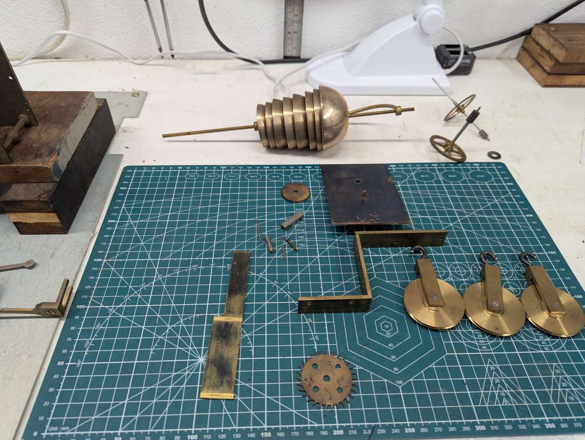

            Bayzle, thank you for your very swift and incredibly useful reply.

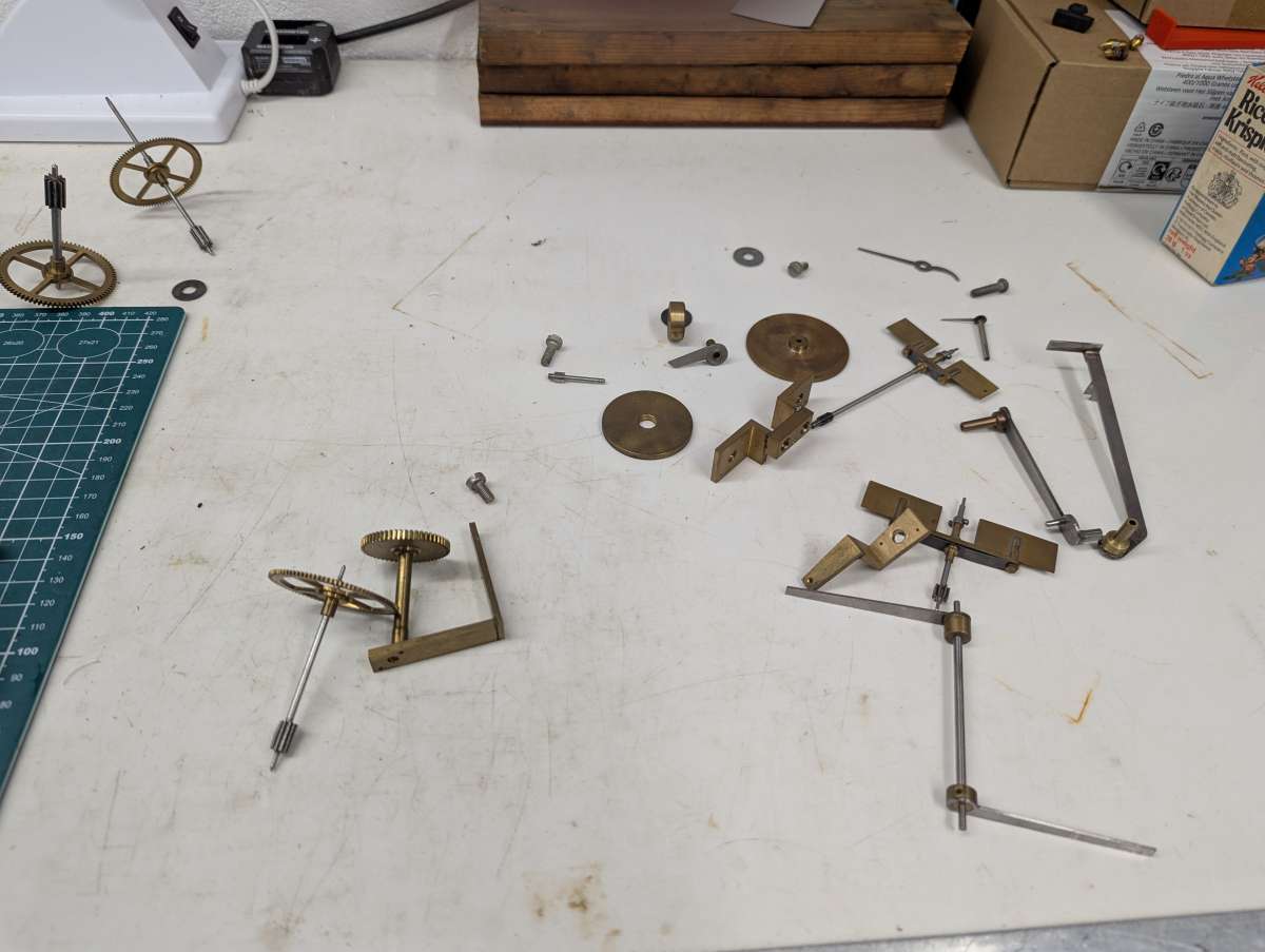

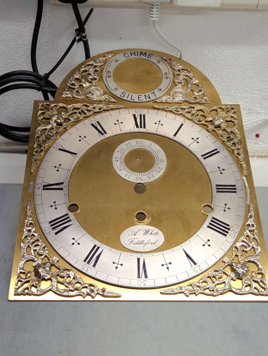

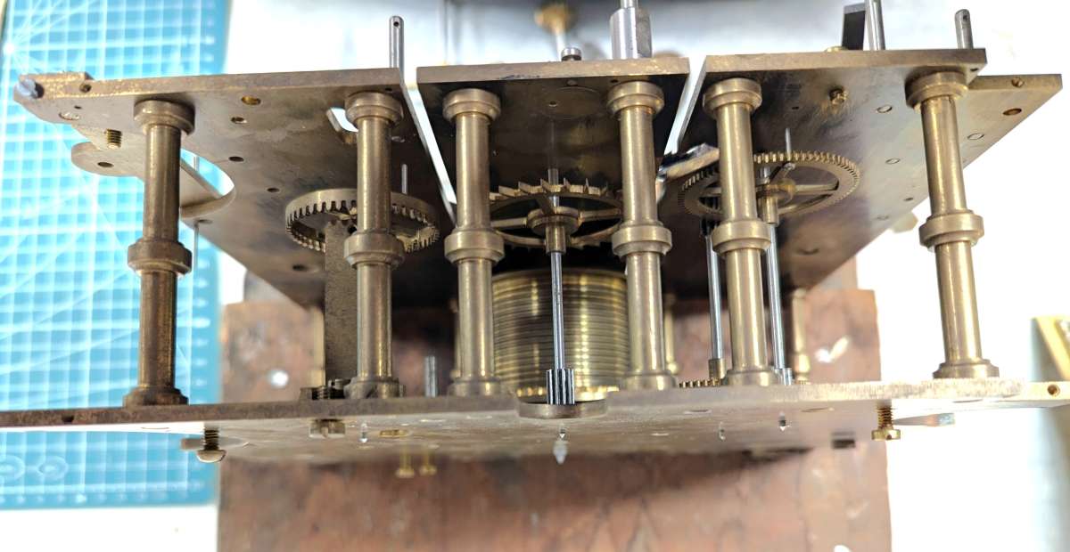

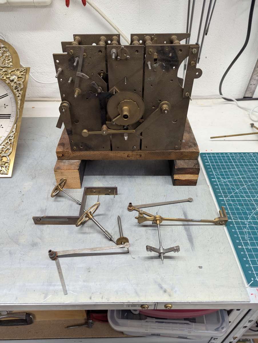

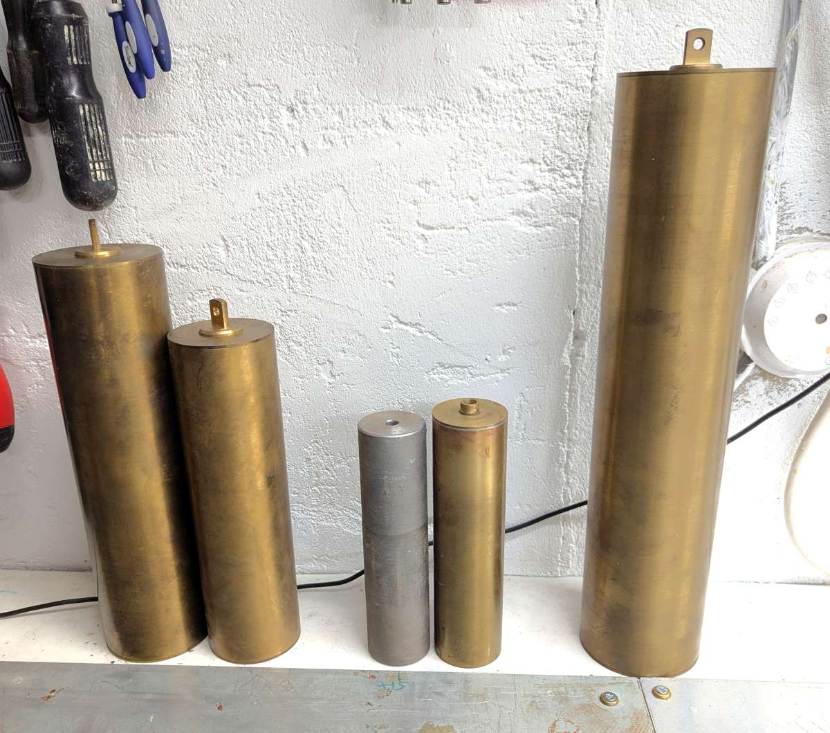

            I cannot be sue yet whether the clock movement in my possession is the one Claude Reeves designed, but there appear to be some similarities based on the picture at the top of the article I referenced.
            Here are the photos of what I was presented with:
            PXL_20250214_101028331PXL_20250214_100746433PXL_20250214_100927425PXL_20250214_100933140PXL_20250214_100939338PXL_20250214_100942726
            There is only one nest of bells, plus one conventional bell for the strike (not pictured) , so it is not exactly like the one in the article I referenced which has two nests:PXL_20250214_110102993
            I know for certain that several components are missing and I am waiting to hear whether the daughter of the (deceased) man who built this can track them down. If she can’t then I will be unable to finish this for her, which would be a shame as she would like to see this running as a memorial.

              That looks very much like claude Reeves Chiming Grandfather Clock ISBN 0 85242 423 X.!!! MInes an ex Library copy bought for a £1
              Abe or world of books have copies

                There’s one on ebay for about £20, it certainly looks the same as your Clock.

                  The ME Musical Clock was described by Claude Reeve  in a series of 12 articles in ME from 1957 onwards together with another 5 or 6 describing a case for the clock. Each article was only 3-4 pages long. There are a couple of additional articles on the gear cutters used and other details.

                            No – I had to admit defeat. Although the family of the deceased clock maker found some of the missing parts, there were some significant pieces still missing. My engineering skills would not have been sufficient to make the missing parts.
                            I suggested to the family that they might contact the BBC to see if the Repair Shop would be interested in taking it on. I haven’t heard back to see what the outcome of that was.

                                    The clock I have is the one that you once had. (The book also came with it which you bought!) It has obviously acquired a few miles/owners under it’s belt!!
                                    Yes, only one next of bells but Alan White who built it did buy the 2 sets back in the 70’s as indicated on an invoice which may have come with the small amount of paperwork.
                                    The chime drum appears to be there and the musical drum is also there but unpinned.

                                      That 38lb weight is quite a monster, isn’t it?!

                                            Yes, it’s a monster! I will start in earnest in the New Year and probably create a blog /post for it.
