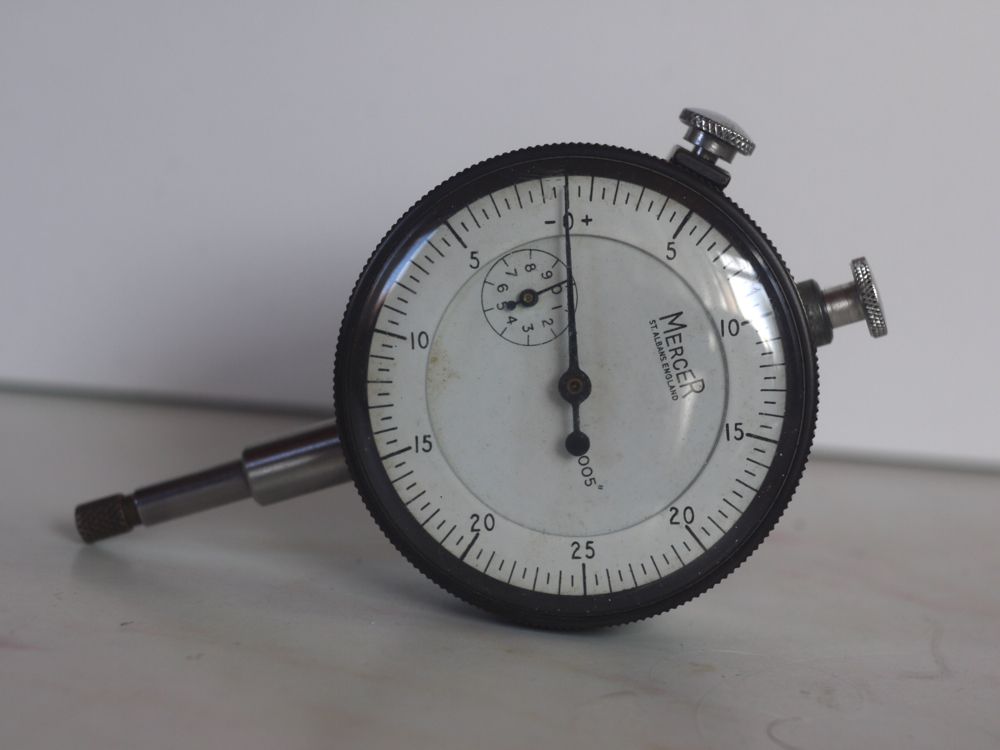

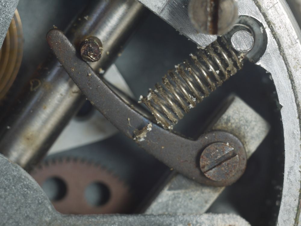

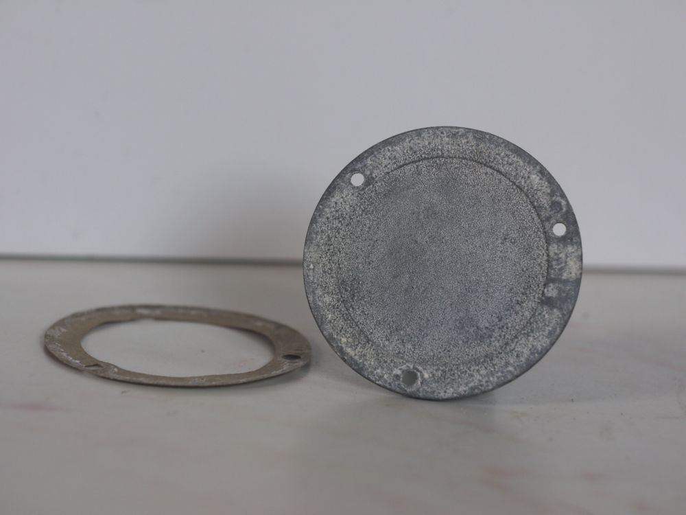

                          No real help, because I've never got around to fixing it, but; here are a few pictures to show how nasty they can get inside … This one felt just a little sticky.
                          Edited By Michael Gilligan on 16/06/2015 22:54:16
