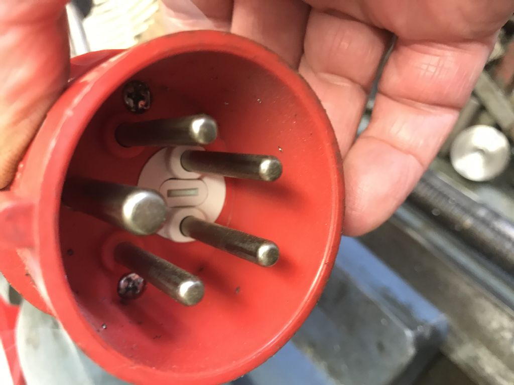

        I was using my Clarkson T&C grinder yesterday to sharpen a 6 tooth shell mill when, just as I had finished the last pass, the motor slowly 'died'. It was as if the speed controller on the VFD had been turned down gradually. I was at first concerned that the VFD had 'blown' – but as I interchange the VFD with one of my lathes by using a 3 Phase 5 pin socket I reconnected the lathe – turned on the power and the lathe ran as normal. This made me suspect the Clarkson motor had died – as an initial check today I Fluked the pin outs of the Clarkson connector and got the following Ohm readings – they were not stable readings though, as they tended to ramp up from zero to between the values of 11.5 Ohm to 12 Ohm. This I put down to flux effect within the motor.
        The readings between the major 'earth' pin (at 12 o clock) and the remaining 4 pins was Infinity and Infinity between pin 1 (clockwise from the earth pin) and all other pins, then the 'ramping/ up to 11 / 12 Ohms between the pins 2, 3, & 4.
        What have I got? a deceased motor? BTW reconnecting the VFD and trying to run the Clarkson motor did not result in any motion, humming, escaping smoke or otherwise.
        Photo of 3 phase 5 pin socket:-

                      Just to reconfirm – I have tried the lathe off the VFD (I use one VFD to power about three machines, all with similar rated motors) the VFD 3 phase output is terminated into a 3 phase 5 pin socket – I disconnect the plug with the remote control for the VFD power to off, swop over plugs and then use the remote low voltage controller to start / stop and speed control accordingly. There is also a jog function for my drill. Both the lathe and drill work as expected off the VFD so I am happy to believe the VFD is not at fault.
                      In reply to John Haine's second post – yes the initial value shown on the Fluke is 0, or at least a very low number (such as 0.7 ohm) and then ramps up to around 12 Ohms within 2 secs. I've tried the lathe motor resistances by the same method and get even numbers across all pins representing U,V, and W (motor connections) but a slightly different Ohm reading, 15.3 to 15.6 Ohms in the case of the lathe (slightly different power motor but still within the VFD rating). Just a note to add that the 'fat' plug pin is the motor earth, and pin 1 is the shielded cable earth connection connected at the VFD end but not at the motor end, this to ensure no earth loop to fool the RGB in the consumer unit!
                      The motor off my mates Clarkson is exactly the same type but his runs 440V star (Y) connections and runs OK – I'll change it over to Delta (|&gt before trying it on my machine.

                        Motor replaced with a Siemens 3phz delta connected unit – everything works as expected. The original motor, an ASEA which was the original fitment I believe, had a minor thermal event deep in its bowels (bit like a curry but more destructive!).
