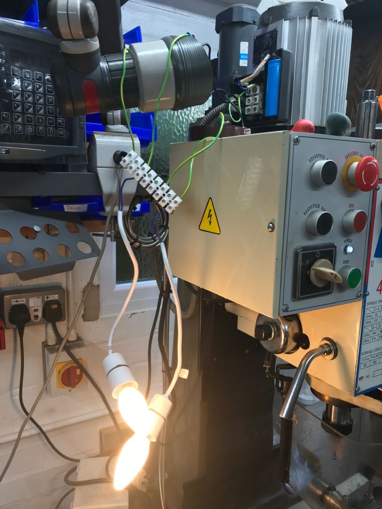

                To make sure I understand. The bulbs should be connected to the wires that I have disconnected from the connection block on the motor?
                Colin
                PS Many Thanks for your assistance with this.
                #384965
                Les Jones 1
                  @lesjones1
                  Yes, One bulb to U1 and U2. The other bulb to V1 and W2.
                  Les.

                  Colin Heseltine
                    @colinheseltine48622
                    Les,
                    Both bulbs power up
                    Is the final concensus that it is the centrifugal switch that is faulty even though the capacitor gives odd readings.
                    Colin

                      Les Jones 1
                        @lesjones1
                        Hi Colin,
                        You have now confirmed thet the fault is in the motor. While you have the lamps connected up connect the start capacitor in series with one of them. (As I suggested in my post on 25 Nov at 20:01.) The lamp it is connected in series with should light at almost full brightness as a 150 uF capacitor has a reactance of about 20 ohms at 50 hz. If the lamp lights at near full brightness than the capacitor is probably OK. This is the only way I can suggest testing it without test equipment. From yesterdays tests I am allmost certain that the centrifugal switch is faulty.
                        Les.
                        #385052
                        Colin Heseltine
                          Just connected up with capacitor in circuit with V1 and W2 and both bulbs equal brightness.
                          Will now try and take the back of the motor to get to centrifugal switch. Hopefully the back end platewill remove without me having to unbolt the motor of the geared head as I have no idea how it is connected internally.
                          Colin

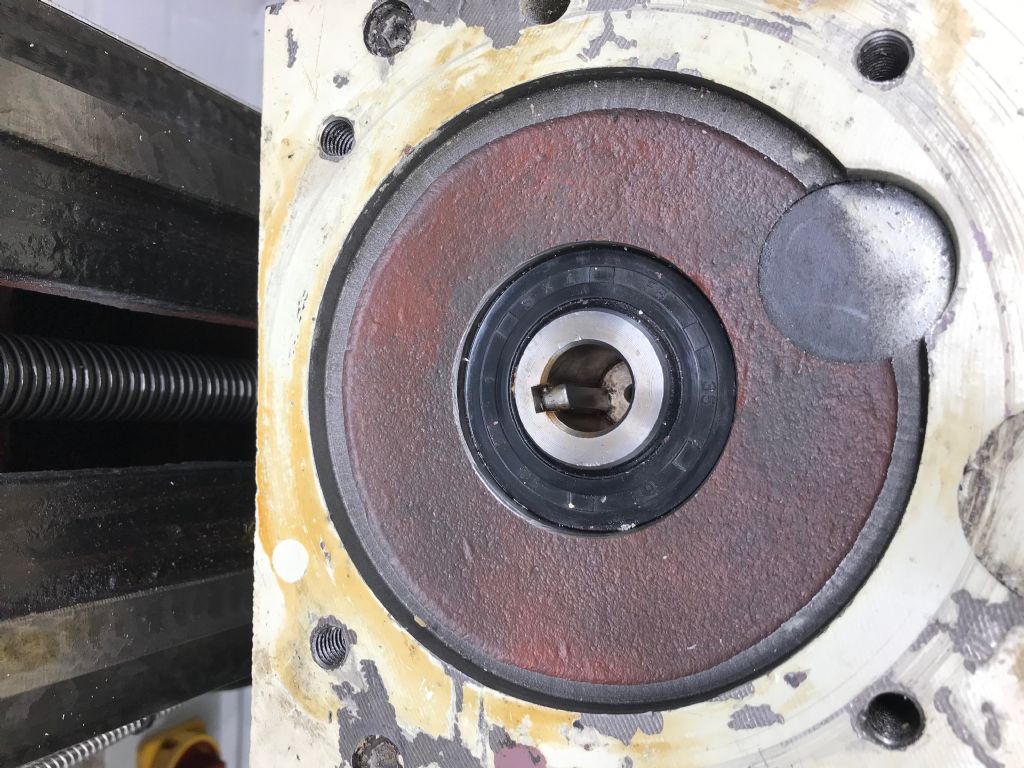

                              Rear End Casing removed. No centrifugal switch??
                              Where now:?
                              Colin
                              #385061
                              roy entwistle
                                @royentwistle24699
                                Its probably at the other end as there doesn't appear to be any leads at the end shown
                                Roy

                                  Colin Heseltine
                                    Oh well. Had a horrible feeling that might be the case. Not sure how the motor shaft integrates into the gearbox. Whether it is splined/keyed onto a gear fixed in gearbox or whether it has a fixed gear on the motor spindle. Will take photos for future reference.
                                    Colin

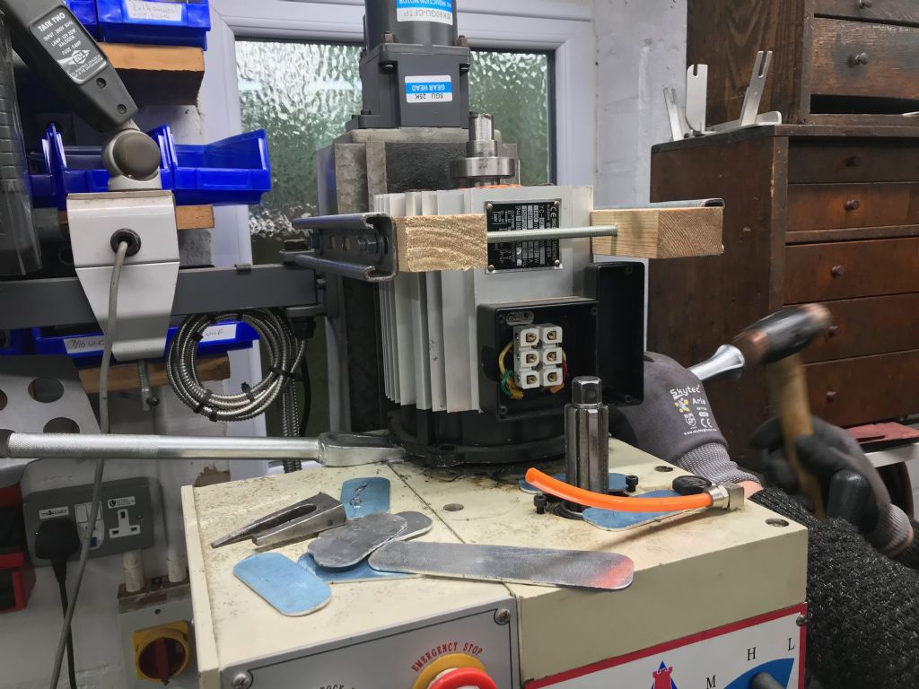

                                      Colin Heseltine
                                        I have removed the 4 cap head bolts holding motor to the head/gear casing. The motor and base plate will spin round but I do not have the strength to lift it up. The flange is completely flat against the head and cannot get a screwdriver in to ease it up and out.
                                        Any ideas, I do not want to break a lug of the flange.
                                        I will put up another post re removal of motor to see if it triggers any responses.
                                        Colin

                                          I have a Chester Super Lux bought in 2005, checked today and when i switch it off you can hear the centrifugal switch operate. The motor on mine just slots into a coupling with a nylon key, no other fixings except 4 cap heads through the motor flange.
                                          #385155
                                          Colin Heseltine
                                            David,
                                            How did you lift the motor out. I am struggling to grip it. I can lift it about 20thou using a screwdriver under the fixing lug and located into one of the fixing bolt holes for the gearbox top. I do not have any way of aligning it from roof as all joists boarded over and also not enough clearance.
                                            Colin
                                            #385181
                                            Jon
                                              @jon
                                              4 screws out, 2 by your screwdriver.
                                              If you can lift it 20 thou thats enough to get it going just prise it up 180 degrees apart. If cant get under prise off something else and use blocks.
                                              Mine i had to line up shaft with woodruff key and position before lowering.
                                              #385189
                                              david homer
                                                @davidhomer12226
                                                Hi Colin, I manged to lift mine staight up by standing on an adjacent bench, mine was cast iron where yours looks like ally, guess yours is a later version than mine,it was heavy. As Jon says I think you need get some small wedges in around the flange to get it moving.
                                                Have you tried a new capacitor, I managed to find one on e-bay. Trouble with capacitors on 1ph motors is they dont like too many starts per hour, which if you are like me its off and on allthe time.
                                                if its the centrifugal switch you maybe able to prove that by spinning the spindle and switching it on, try it in one of the slower speeds as that will result in the motor turning faster, just be careful though. If the switch if faulty and you cannot repair ir you find a solid state one to replace it, these are used on 1ph hermetic refrigeration compressors where you cannot have the switch inside the casing.
                                                David

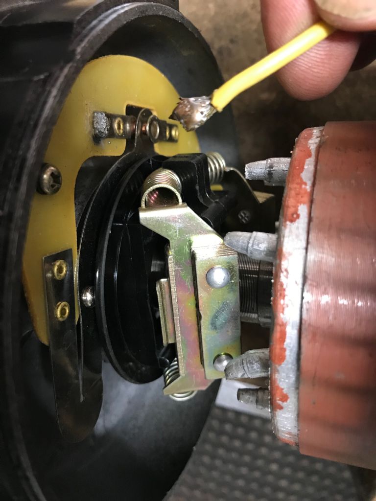

                                                Colin Heseltine
                                                  It took two of us, plus three large H/D flat blade screwdrivers, two of the old fashioned wedge type taper breakers and a couple of copper headed hammers and half hour of hammering and levering before it came free. It was absolutely solid in the spindle in the head.
                                                  The centrifugal switch was at the spindle end of the motor. AS soon as the end case came of the problem was easy to see. No fault with the centrifugal switch per se, just a distinct lack of an electrical connection to it. A very dry solder joint had parted company .I only had a 40 watt soldering iron and to be honest this was a bit low powered, but with a good clean and a good dose of old fashioned soldering flux (Fluxite) the connection was remade. The pictures below show the effort to remove the motor, the faulty joint and motor location on the gearhead. Hopefully if anyone else has this problem these pictures might help.
                                                  All reassembled and works.
                                                  Many thanks to all those who made suggestions and particularly Les Jones 1 for his help in diagnosing the issue correctly.
