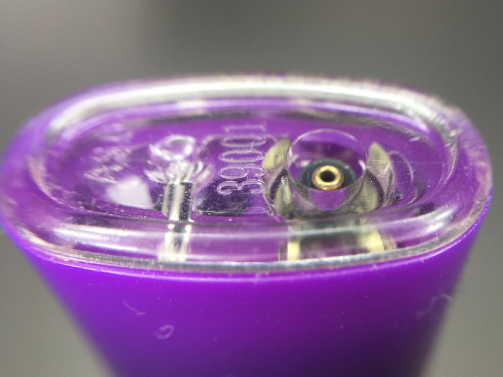

      I have the need to connect a larger fuel tank to a cheap refillable Gas Lighter.
      The standard type of refill canister would be an adequate size, but the ‘push’ connection is too clumsy, as both lighter and canister have plain tubes with spring-loaded valves.
      Before I start over-thinking this … does anyone have a bright idea ?
      I need connections to one brass and one plastic tube, with the facility to open both valves, and a small in-line gas tap !

                      Before anyone asks …
                      Yes, I have tested the burner
                      … and yes, the shape and intensity of the flame is suitable for what we are working.

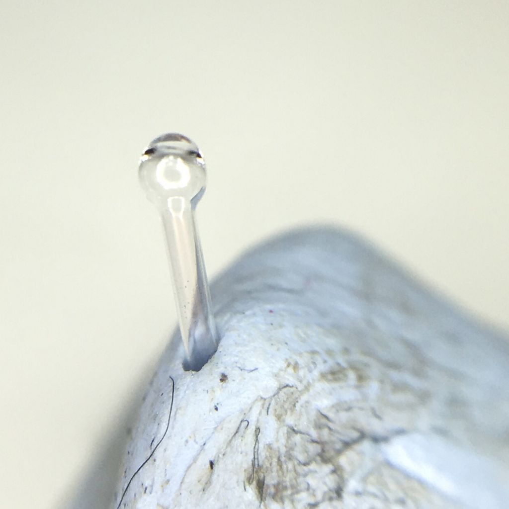

                          That’s fine for what you are doing, Jason yes
                          But we are working on a slightly smaller scale and an appropriately scaled Blue-cone flame is desirable.
                          The capillary tube in my photo is 0.8mm outside diameter.
                          Having now seen your edit … yes, that’s basically what I’m trying to do … but the Lighter-refill canister is very cheap and a suitable capacity, so I hadn’t considered the Camping Gaz option.
