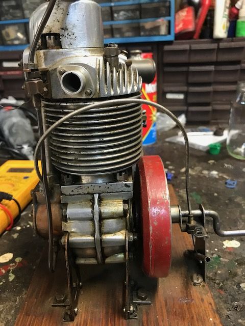

      Hi
      This engine was found in a rubbish pile on a nature strip, .
      I would guess the fellow who built it had passed away and either had no family or they did not value his work. Luckily it was found by someone who could see the work that went into it. He asked if I would have a look at it and see if I could get it to run. I have managed to get some spark., but I don't think I could spin it fast enough to get it to run. I am not sure it has ever run as the piston looks very clean.
      Has anyone seen any thing like it before? it appears to be completely hand made.
      Regards
      Brendan

                Not sure what is supporting the fuel tank, but it looks like the head may be too low. Try a spray with easy start or other flam gas.

                    The angle of the fins on the head suggest it is meant for a tether car rather than a boat but looking through my usual site for engine ID does not show anything to match.
                    Usually turn anti clockwise when looking at the flywheel end.

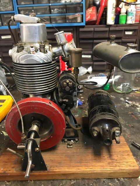

                      My advice would be to take the mag off and leave it somwhere warm for a week to dry the insulation out. Old magneto insulation absorbs water from the surroundings and then can go short after a little running . When you have a decent spark . Then try the engine with a whiff of easy start. If you have a spark it will at least go pop.

                        If it is completely home built and home designed you can't be sure that no showstopper errors have crept in somewhere in the process. Doesn't take much to stop a basically sound design from running. Hardest part is to make a well behaved carburettor. After you have done all the basic timing, cam lift and duration checks to ensure the basic design and assembly is reasonably sound easy start spray would be best way to confirm that its capable of running.
                        Looks to me as if the carburettor is Amal style. Probably along the lines of the old "standard" type. If so the float chamber and main jet both look to be too low relative to the venturi so the mixture will be all over the place and almost certainly too lean for it to start. if you can beg or borrow a modern appropriately sized carburettor that might give you abetter chance of getting it going.
                        Carburettors are hard.
                        Crude option would be to find a Wal Phillips fuel injector, basically a drip feed jet on a venturi with a throttle plate. Just adjust the gravity feed head until it runs! Brutally crude but they do work quite well and, so long as the jet size is within reason, pretty much anything that can run will run. Look fairly easy to make if you had basic dimensions.
                        Fair bit of work involved but rewarding once its going.

                              Unlikely to run with a stub exhaust, about a foot of pipe on the exhaust port might help.
                              The tank should be above the head.
                              last years lawn mower fuel might not be any good
                              You can choke it by partially blocking the carb inlet with your palm.
                              If it still wont go
                              remove the plug if it's dripping wet wave it in the blowlamp flame till the secondary 'candle flame' stops and try again. If it gets very wet very quick it might be an alchohol burner.
                              while the plug is out stick your finger / thumb over the hole and crank it over on your starter. it should blow the digit off with a nice phutt.
                              if it doesn't check the rockers / pushrods have some rattle in them on the firing stroke.
                              If they have the rings could be stuck or the valve seats are stuffed
                              If the plug is dry and it phutts dribble a couple of drops straight down the plug hole and try it again.

                                    Jason, It is unlikely to be a tether car engine usually max engine capacity is 10cc and a two stroke. The current rules allow the use of four stroke engines at twice the capacity of the two stroke engines. It would be a challenge to build a car that complied with the weight limits. It is more likely to for a tethered boat they allow engines up to 30cc.

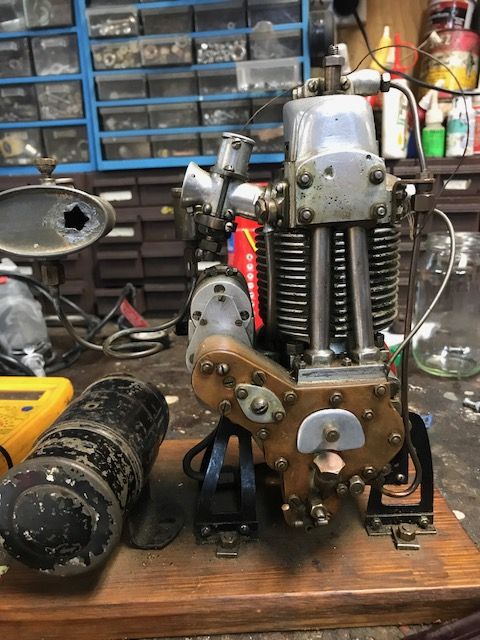

                                      Looks a lot like a Norman with that overhead valve system. See if there is a serial no stamped anywhere on the crank cases.

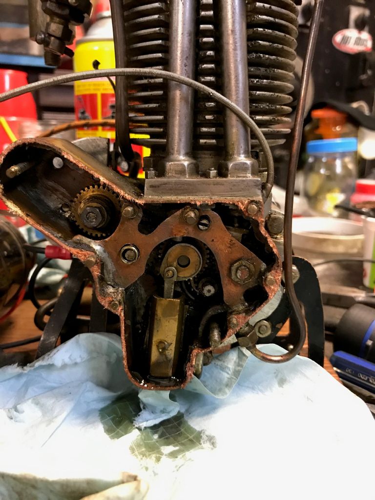

                                        #295582
                                        Brendan Maloney
                                          @brendanmaloney55697
                                          This where I am at.
                                          The timing was way off so I had to open the engine.
                                          I cant see any numbers.
                                          I don't know the capacity be could be 30 CC at a guess.
                                          The mag is faux it hides the points which are a bit sticky I am hoping not to have pull them to bits, with no plans I am treading softly, trying not to break anything.
                                          Discovered the little lever operated cable is a decompressor, I thought it was an oil pump.
                                          Currently cycling the NiCad pack that powers my model aeroplane starter, has not been used for years as all my planes are now electric.
                                          Brendan
                                          #295589
                                          Hopper
                                            @hopper
                                            Awesome! That little reciprocating oil pump looks simlar to the way Triumph motorbike engines did it in about the same era.

                                                Hopper
                                                  @hopper
                                                  Only if it shrank in the wash! But it certainly has that Brit motorbike look of the 30s-50s (or early 70s in Velo's case!)
                                                  Interesting that the builder hid the points in a very convincing scale model of a Lucas Magdyno as used on Brit motorbikes for decades.
                                                  Whatever it is, there certainly must be an interesting story behind it.
