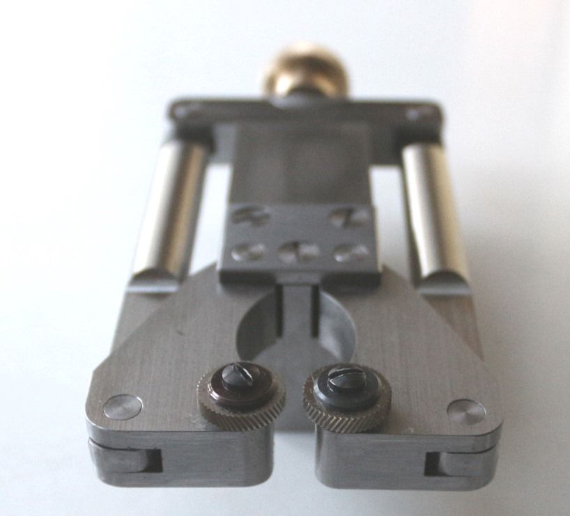

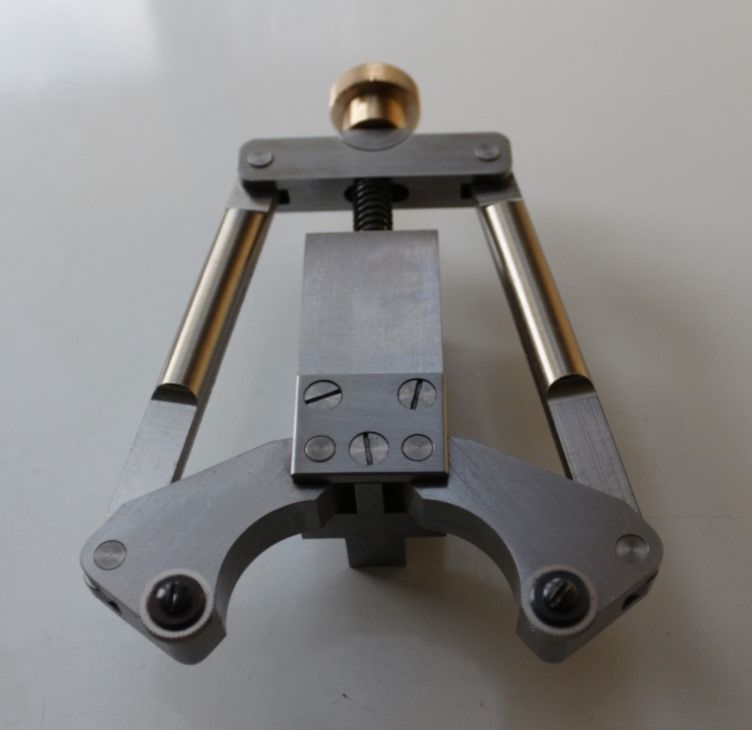

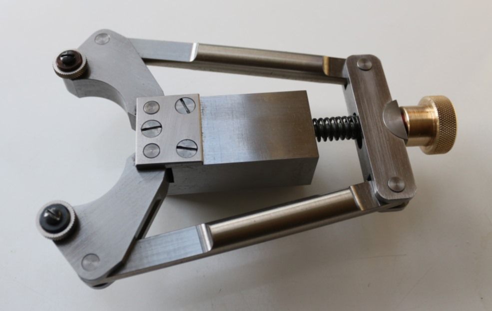

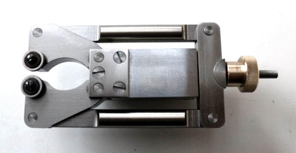

        I saw Graham Meeks design for a calliper knurling tool in one of the mags. a few months back and decided to make one for myself based on his design. I made a few changes – the arms were made from stainless steel door handles (thats all I had) but the main departure was the knurl wheels themselves.
        These wheel assemblies made by QUICK are superbly made and razor sharp running in their own hardened and ground collar/guide assembly all secured with a 3mm screw so as I was given an assortment of straight, diagonal and diamond wheels it is a simple matter to interchange the wheels when needed.
        Apart from that I beefed up the size of the keep plate – just in case!!!
        Does it work OK? Its first job was to knurl its own adjuster knob using a temporary wing nut to do the adjusting. Using Grahams advice as a guide I found that a half turn on the wing nut gave a lovely diamond knurl – with points – and a final tidy up on the chamfers to bring a smile to Grahams old mentor.
        I fully expected that having the knurl wheels in the "outrider" position might cause problems and was prepared to re-machine the jaws to bring the wheels back inboard and nearer to the centre line of the tool. However, it looks like they will do nicely just where they are.
        I'll not boast about how quickly it took me to make – lets just say months rather than weeks. I just look at the average civil engineering contract in this country and when I see how long they hang it out for I say to myself – if they can do it then so can I wink (I'm joking really – I'd never take THAT long
        Rik
        PS Tool is 17cm long with jaws closed and weighs 1kg exactly – quite a lump.

          I thought the Quick knurls were meant to be mounted at an angle so the edge cuts the knurl rather than the face forming the shape. Have you got a close up of teh knurl it produced.
          Nice job on the rest of it.

            Yes that looks a very nice tool
            Have you any pics of a knurl that you have done with the tool.

              I wonder if I could ask Gray what advantage, if any, his design has over the design as shown by Roderick Jenkins in the thread "Knurling Tool Shank Size".
              I'm not criticising, just genuinely curious as my own device, done to a design by Stan Bray and similar to Roderick's appears satisfactory to me in that it has variable width jaws and can float up and down thus allowing for any mismatch between tool centre height and lathe centre height. Now ok, my workmanship isn't that great which is why there isn't a photo, and I have wondered at odd times in the past about re-building it. So, Gray, your thoughts please?

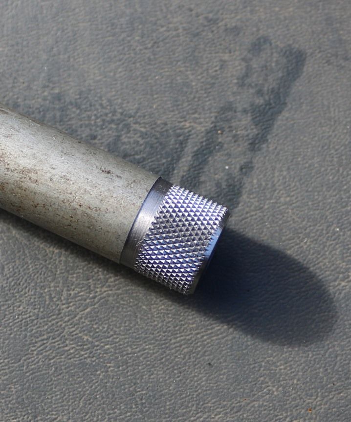

                …….. and one in steel for those who requested a closer view. (I know it LOOKS like ally but its been anodized/plated).
                Rik

                  Well done Gray, you've managed to explain all the problems with the one I've made – the slack pivots, the out of line knurls, the contact with the chuck jaws…. Fortunately, I don't do that much knurling so other than the desire to improve matters, it probably doesn't matter that much to me.
                  Now if I had an interchangeable tooling system, life would certainly be easier…
                  Thanks a lot Gray, food for thought.

                            Gray's advice on straight knurls is sound. Following his advice ontechnique I made a simple holder for a single straight knurl and was able to produce a 2 1/2" diameter knurl on mild steel a mini lathe (It isn't 100% perfect, but I was pleased with it).
                            #145565
                              Here you go:
                              #145567

                                  Posted by Neil Wyatt on 28/02/2014 22:28:26:
                                  Here you go:
                                  Neil, did you produce this on your C3? (if so there is hope for me yet!)
                                  That really does look very good.

                                    That is a very neat knurl – you should be pleased with yourself!

                                        Thanks for the compliments; that's one of my better jobs!
                                        P.S. I needed a small adjustable wrench to tighten up a plastic tap nut. I found one in B&Q for 2.99 and even it has a laser-etched scale on the jaws.
