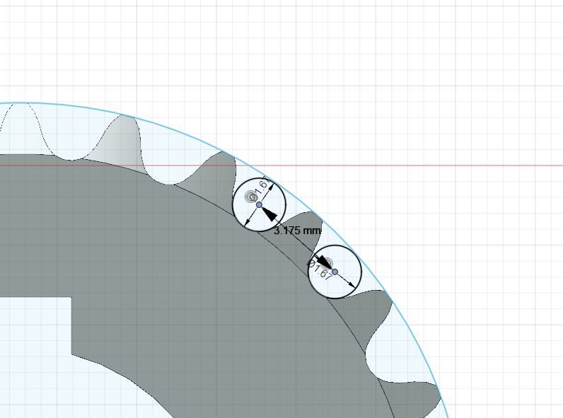

                  Easy way is to import a cad file from a sprocket supplier and if they don't do 1/8" pitch then scale to suit.
                  this is a 28T 1/4" pitch Macmaster Carr sproket scaled 50% and I have added the two 1.67mm pins and measured the distance to show it works.
                  Edited By JasonB on 05/01/2020 20:08:29

                    A big thankyou to Bill, Ian, Michael and especially Jason, 👍. I really appreciate your answers, I had no idea. I look forward to experiment…
