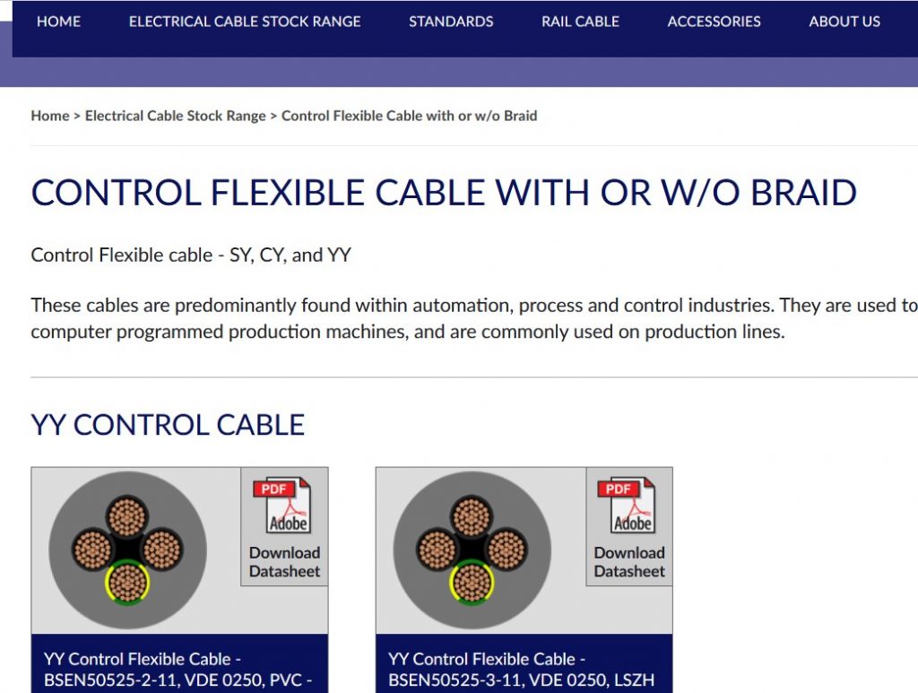

      Spec from Cleveland cables for SY CY and YY instrument/control cables at the following link.
      For clarity SY is NOT cosidered an armoured cable, in fact some of the braided screening leaves much to be desired, it can be very widely spaced, unlike SWA where multiple steel wires cover the full circumference of the cable.
      **LINK**
      Emgee

          Emgee
            @emgee
            Robert
            Definitely not classed as an armoured cable and I have fitted hundreds of the correct glands to secure the braiding, how many have you fitted. ?
            Emgee
            Better description here:
            Edited By Emgee on 19/09/2022 12:28:54

                  Robert Atkinson 2
                    @robertatkinson2
                    Posted by Emgee on 19/09/2022 12:26:24:
                    Robert
                    Emgee
                    You are being obtuse.
                    Look at the datasheet https://www.clevelandcable.com/electrical-cable-stock-range/control-flexible-cable-with-or-wo-braid/SY-control-flexible-cable-pvc-up-to-95mm/
                    It clearly states: " Armouring: Galvanised Steel Wire Braid Armour "
                    That is also only one supplier website, I'm not going to bother linking all the ones that say armoured on the first page.
                    While it is not my day to day job I have installed plenty of cables including SY, CY. YY. SWA, MICC etc etc. This does of course include fitting glands.
                    I have also designed installations and equipment using CY, SY & YY cables. That included certification to international standards CE, UL ULc Ctick & CSA for starters.
                    Robert G8RPI.
