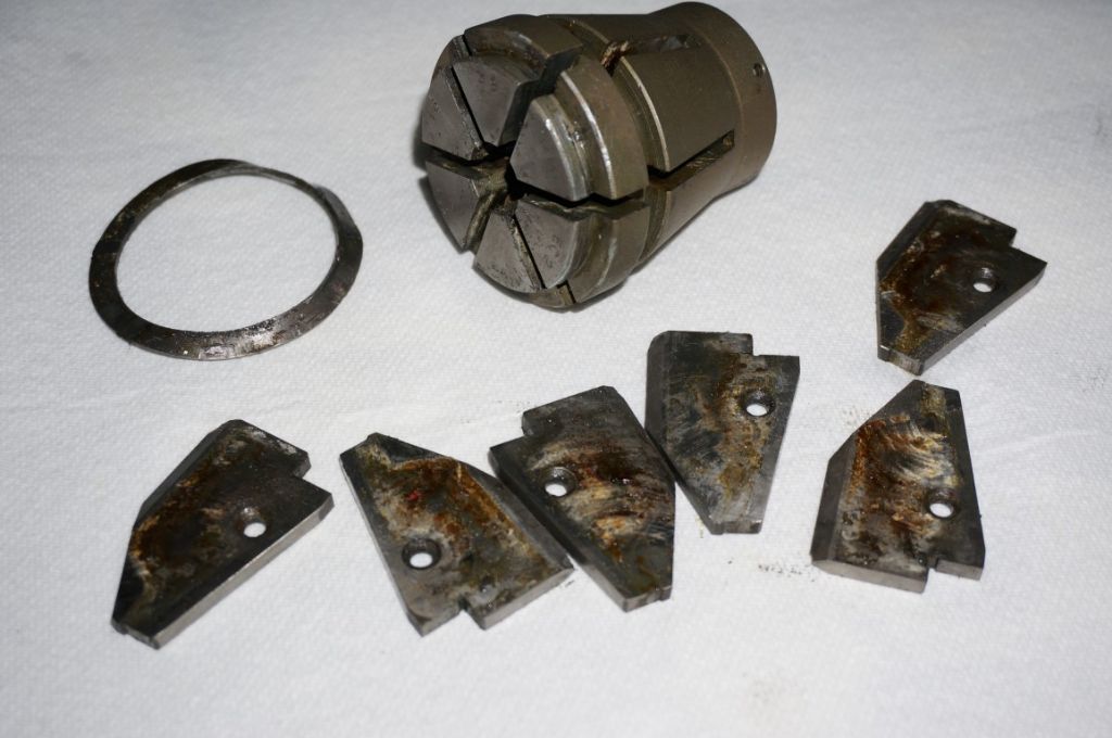

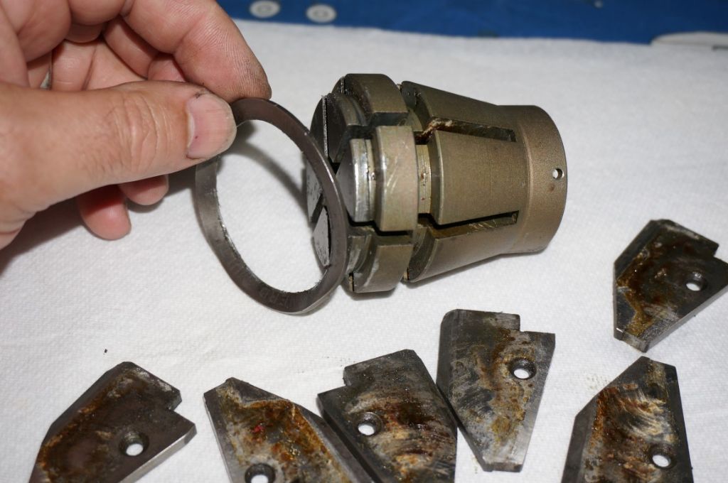

                    dsc00564 (medium).jpgWell i sacrificed a collet that had broken blades and i'm still not the wiser how to get it to bits
                    I removed the springs first thinking that one blade might slip in and pull through the middle
                    But then had to remove the washer with a big screwdriver and hammer…it does fit into a groove
                    The blades were really gummy I dont think any amount of solvent would have got these clean
                    The washer does fit into a groove in the collet body without the blades the washer would possibly spring the body inwards letting the washer slip into the groove but then I cant get the blades in
                    anybody any idea's

                            I think I've sorted it now
                            I've flattened the washer and by compressing the body the washer slips on…it wont compress when the blades are in
                            3 blades slip in easily into say 1,2 and 3 position
                            the others have to go in cock eyed but they eventually slipped into place
                            then replace the springs and its good to go
                            The blades are such a good sliding fit and very limited movement < 2mm that i'm not sure that solvent will get in and remove the varnish like substance
                            But now I know how to take them to bits so alls well

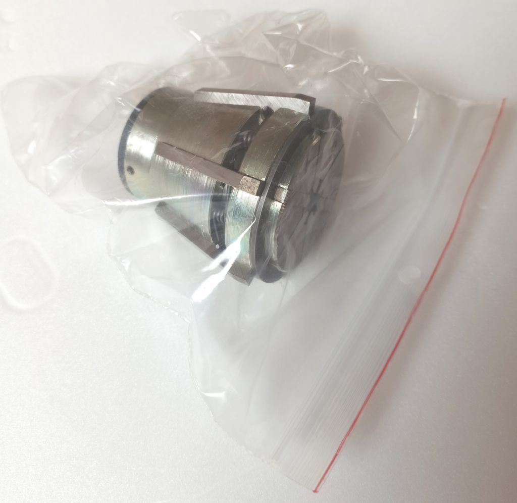

                                      Having used this old discussion as reference, I'd like to add how I was able to move a lot of stuck multisize collet blades again, after having bought two sets (really old and old stock):
                                      I applied pure acetone with a paint brush and put the collet in plastic zip bags to keep the solvent from evaporating. The blades start moving under finger pressure after about 30 minutes or an hour, with little use of acetone.
                                      The idea is a combined form of:
                                      – Nick's method (this thread) "…into a bowl of cellulose thinners of nail varnish remover".
                                      – A 2012 document "WD-40 Alternative: Final Design Report" testing and suggesting oil mixed with acetone as penetrating oil. (But the figures in the report tell that pure acetone works even better.)
                                      https://www.engineeringforchange.org/wp-content/uploads/2015/12/ENGR103-WD40Alternative-FinReport.pdf
                                      – "Cuisine sous vide" techniques, where you keep meat juice close to the meat in plastic bags, while cooking slowly at low temperature.
                                      – The technique of using small recipients with special solvents in big ultrasonic cleaners:
                                      https://mb.nawcc.org/threads/best-way-to-use-larger-ultrasonic-cleaner-for-tiny-parts.53026/
                                      Hope that helps someone!

                                                  Ah, I think I see now, I need to squash the main collet body to allow the retaining ring to come off. A 6-jaw chuck would be handy for that. Which I don't have so I'll have to make something.
                                                  I think that the larger sizes have room to take the blades out by pushing them into the middle but not the smaller sizes since each would collide with the opposing blade.
