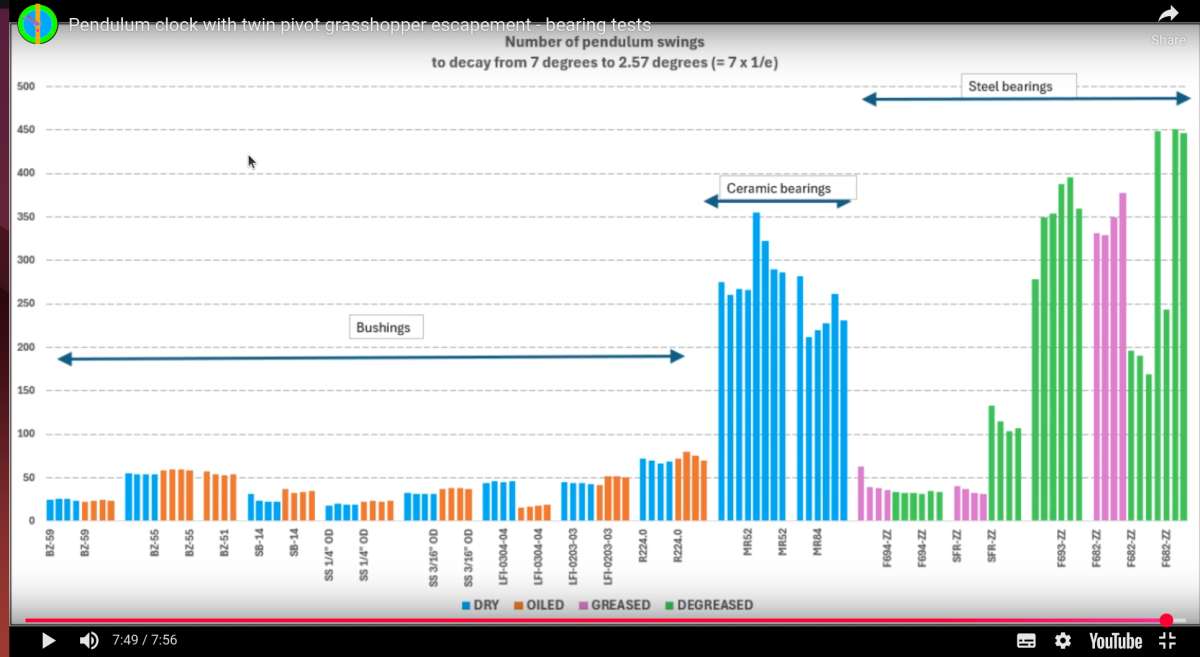

        There has been some discussion on bearings in this thread and whilst I’ve been asking the question, I’ve not got involved as I don’t know enough to comment. Whilst the traditionalists are strongly against them and seem to argue that a brass bushing or jewel is the best way in clocks, I can’t help but go off the evidence. There have been a number of links posted in this thread and then this simple test looks to be undeniable – even out performing jewels. I was all set to spend my money on jewels and whilst they certainly look the part, if they are out performed by cheaper bearings, I don’t think they can be ignored….
        I’m going to go ahead just like in Bernie’s plans and use bearings!

            On Chris Raynerd 2 Said:
            There has been some discussion on bearings in this thread and whilst … the traditionalists are strongly against them and seem to argue that a brass bushing or jewel is the best way in clocks, I can’t help but go off the evidence. …
            Going with the evidence is always best, but slow down!
            The video documents an unusually good experiment.  Not because it delivers conclusive proof, but because it’s well described.  The detail lets us test the apparatus, method, results, and conclusions. Always necessary when seeking proof, because even small mistakes in a really good experiment can mislead.
            There are several issues in the experiment, not unusual and it’s honest:
            1. The discussion relates to the use of bearings in a clock’s counter, that is the escapement and gear-train that turns the hands.  This experiment tests bearing friction with a pendulum, not the same thing.
            2. The method is dubious. A pendulum is a somewhat heavy swinging object, not typical of what happens in a gear train.  For example, as tested with a pendulum, the experimental bearings never make a complete rotation.  In a gear train the same bearings rotate many times.
            3. Best results in the experiment are achieved with de-lubricated steel bearings.  Not a surprise, nor is it the answer! De-lubricating reduces friction because lube is sticky as well as slippery.  Has to be, otherwise it falls off!  Problem is that removing lubricant causes rapid wear, so the improvement gradually disappears as the bearings grind.   Not good in a clock.  Beware of ‘improvements’ that look good on the bench; they may not stand the test of time.  Note that jewelled pivots can run for many decades.
            4. The experiment tests many different types of bearing, which is good.  But all these bearing types exist to satisfy particular use cases, probably not swinging pendula!   I hope no-one believes the experiment proves that steel bearings are best for everything from big-ends to chronometers!   More to choosing bearings than measuring friction as demonstrated in the video.  If there was one type of bearing that did everything, all the others would disappear.
            5. Bearings are rarely used to support the pendulum in a high-precision clock.   Far easier to get good results by suspending the rod from a leaf spring.  Springs store and return energy to the bob, a simple way of ensuring reliable long-term low friction.   Lower than spring friction has been temporarily achieved by swinging the pendulum on a razor edge resting on agate, but this type is vulnerable to dirt and wear.  Over time the razor goes blunt, dirt gets in, and the agate grooves. The initial high-performance doesn’t last.  Hero to zero after a year or two!
            6. Though the experiment keeps it simple by not measuring ‘Q’, it could have done without much extra effort.  As a comparison I suggest the experiment should have tested a spring suspension too, as the control.  Judging by the table (repeated below), the Q of the bush-type bearings are very low, and the best result feels poor too.  (Haven’t attempted the maths:  300 swings to decay 6° ain’t good though.  A home-built pendulum should aim for Q of 10,000 or higher.)   This comparison would have highlighted frictional orders of magnitude.
            The results:
            q
            To be clear, I’m sure bearings will work in a clock.   The problem is they may not be better than the alternatives, particularly over a long time.  I’m all for challenging traditional methods and keeping up-to-date, but pivots running in jewels work extremely well in clocks.  They’re light and low friction.   Main disadvantage is they can’t take heavy loads or transmit much power.  Other bearings are better for power applications, but the cost is higher friction and inertia.
            Gut feel, the choice is to do with size and weight, with a point at which advantage flips from pivots to bearings.  Daft to put conventional bearings into a wristwatch, equally unwise fit a tower clock with jewelled pivots.  Bernard Tekippe’s clock is somewhere in the middl; is the gear-train power hungry or light-weight?   Not knowing suggests further experiments:  how much power does it take to drive a bearing fitted Tekippe compared with a pivot and jewelled Tekippe?
            Bearing inertia is certainly a problem.  In addition to losing energy due to friction, work is done moving mass.  As bearings are much heavier than pivots, this can’t be ignored.  Clockmakers go to considerable trouble to reduce the weight of moving parts, all the big gears being thin and much pierced. Inertia matters.
            By all means build with bearings, just don’t do so on the basis of this experiment.  Though ten-out-of-ten interesting and informative, it’s not conclusive.   Bearings in a Tekippe might work well or they might not.  Measurement not opinion.  Please report back – might include a confession that the clock worked well for a year before becoming sticky and then seizing up.   Many beautiful clocks don’t work particularly well!

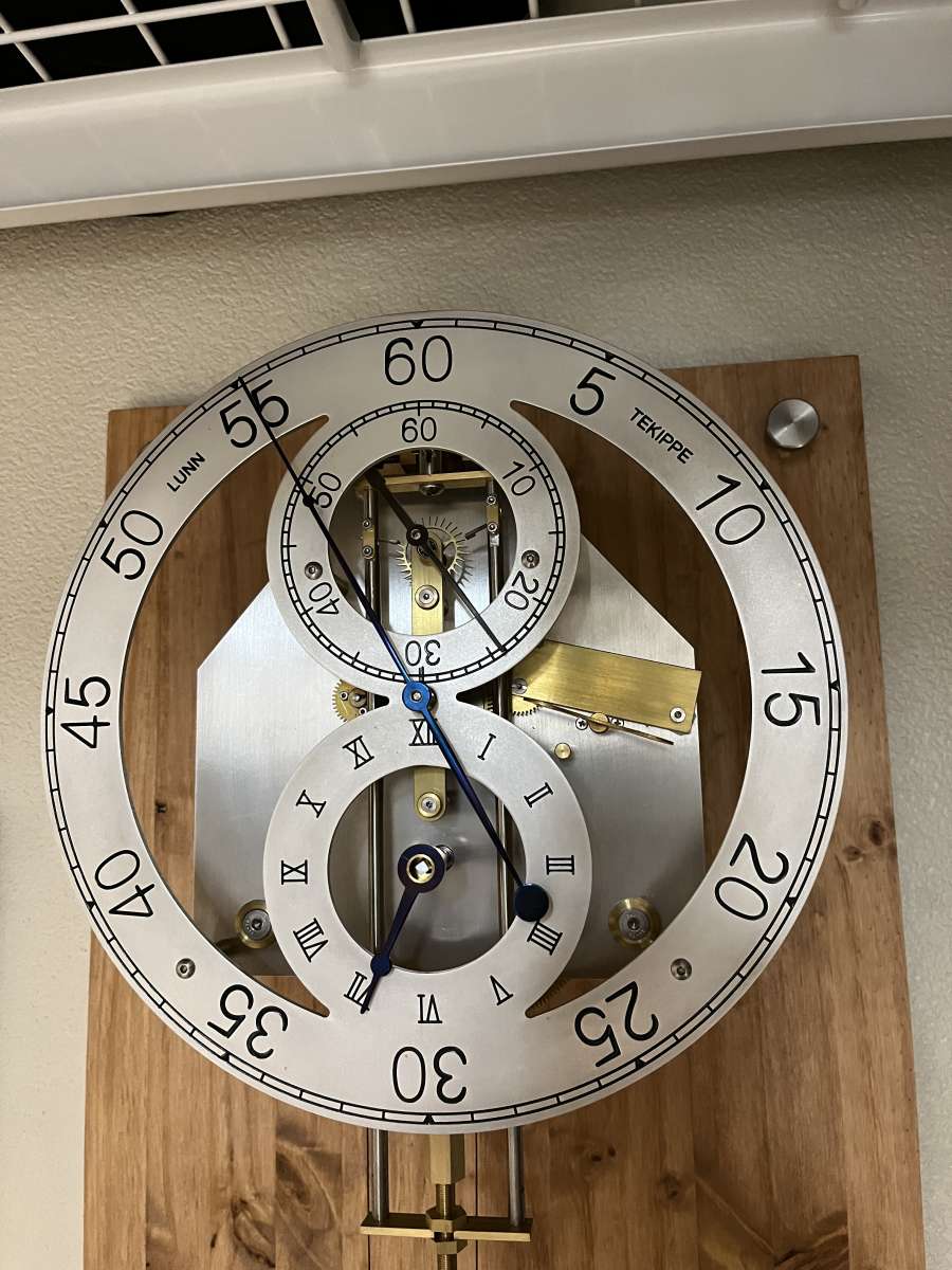

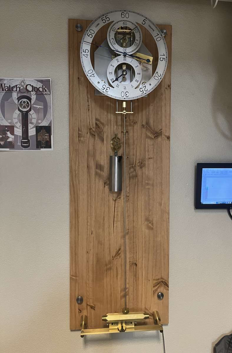

                                            Hi Chris, I couldn’t resist contributing a little to this thread.  For those watching this one, here’s our Tekippe so far, but it looks like there are a few more builds that will soon catch up and hopefully overtake.
                                            IMG_4627IMG_4612
                                                    That looks impressive, Steve.  I particularly like the silvered front plate.  It highlights the mechanism well.
                                                      IMG_4627IMG_4612
                                                      Hello Steve and great to see you on here! I think we were posting at the same time and I missed it.
                                                      your clock is looking great!
