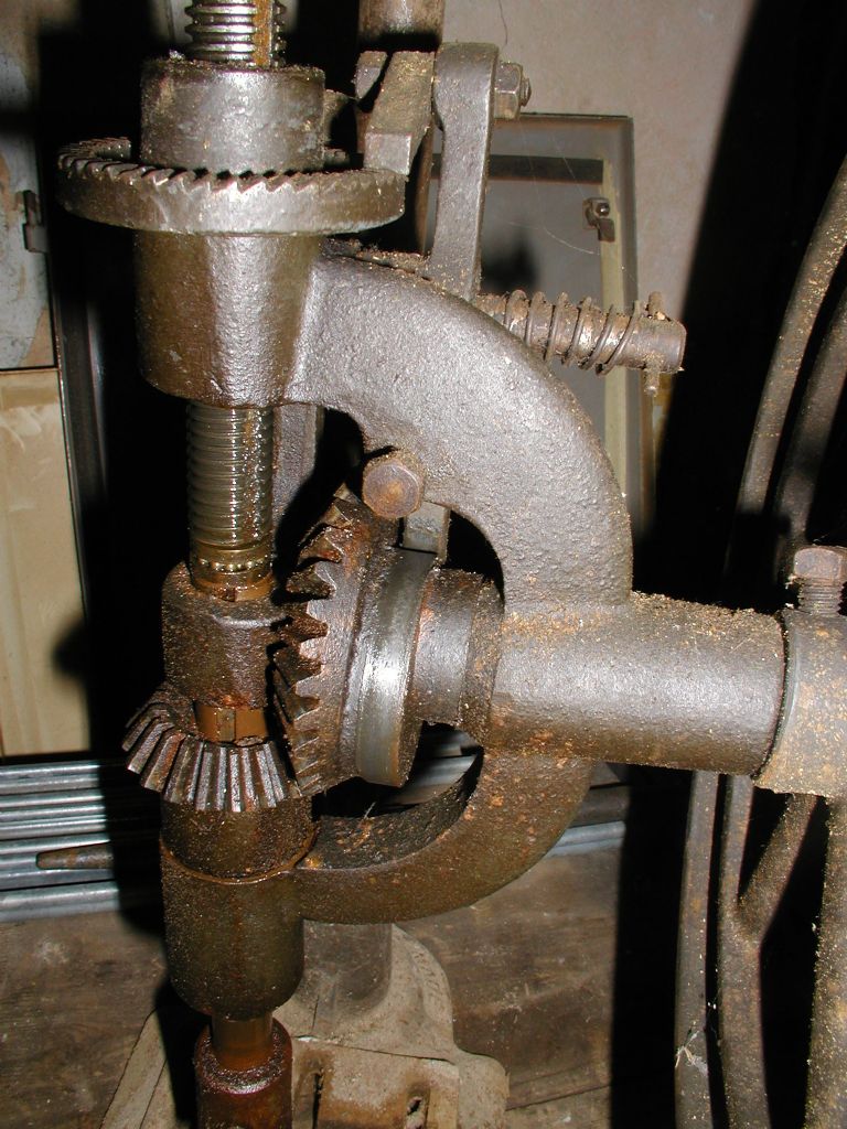

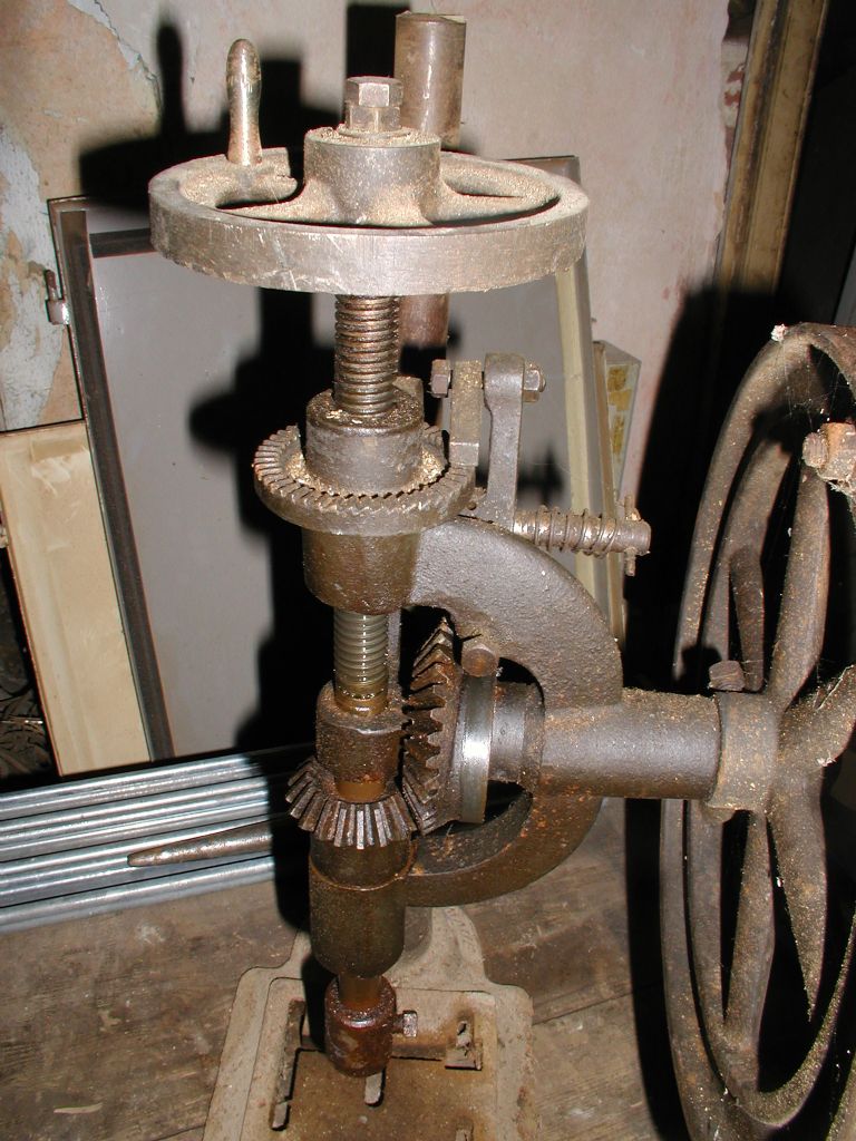

          Steve The automatic feed on the hand driven pillar drill is fairly simple. There is a feed screw which is rotated by hand (manual feed) this pushes the drill down wards. The feed nut is part of the frame. The feed screw has a long key-way which engages with a key inside a ratchet wheel which has its teeth not on the edge but on its face. An eccentric is mounted on the main drive shaft which moves a lever back and forward. This lever carries a pawl at the other end which engages the ratchet wheel pushing round. This screws the drill head down.
          Dick
          #67926
          Nicholas Farr
            @nicholasfarr14254
            Hi Steve, the two pictures below show what Richard has explaned, although this is only a single speed version. The pawl is lifted and swung back when you wish to back off the drill or if you just use hand feed.
            Hope this helps
            Regards Nick.

              Hi Richard and Nicolas
              Thanks for the great help! With Richard discription and Nicolas photos I can grasp the picture. Nicolas – possible to send a few more photos with a white paper behind so that I can see the keyway, ratchet and pawl? Better at different views…sorry to bother you here.
              Wanted to make this devise a long time ago. I have no problem with the handwheel and bevel gears. It’s the auto feed design above it . You could post the pictures here for all to share or email me: stewan@gmail.com
              Thanks a million inadvance to both of you
              Steve

                            I think I see light at the end of the tunnel! The eccentric shaft is the driving force for the pawl and ratchet auto-feed and rotate the drill chuck below…one last question:
                            The threaded feed screw and the lower drill shaft both have key-ways for the ratchet plate above and the bevel nut below respectively. Are these 2 rod connected? There’s a thrust bearings inbetween…if they’re in 2 pc the driving force down is ok what about withdrawing upwards? How’re they linked?
                            Thanks inadvance.
                            Steve
                            #68005
                            Nicholas Farr
                              @nicholasfarr14254
                              Hi Steve, the drill shaft and feed screw are two seperate items. The screw thread is hollow, and the drill shaft from the thrust bearing upwards is reduced down to a sliding fit inside the hollow of the screw thread, it terminates on top of the feed screw handle with the double nuts, as seen in the last photo.
                              Regards Nick.

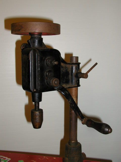

                                    Hope to see any photos you have more importantly if the gears are enclosed, possible to remove the cover before you take photos?
                                    This is the bench hand drill which I’m looking for, a smaller version of Post drill with similar principles. Though China-made this design was originated by the German in early 1900.
                                    Please alert me if anyone out there have seen this machine on sale in hardware stores.
                                    Wish to mail-order one. This machine is very suitable for light and hard to drill places as it could be swung around 360 deg. if the job is clamp on side of the workbench.

                                      Nicholas Farr
                                        @nicholasfarr14254
                                        Posted by Ian S C on 06/05/2011 14:59:07:
                                        The machines I am thinking of come from a period between the end of the 19th century, and the 1930s, the one in your photo is modern by comparason, it looks like a useful tool. The old ones have exposed gearing, although my one has a rather crude gaurd over the gears. Ian S C
                                        Hi Ian, Steve picture may seem to be a modern one however, the drill in the picture below is not unlike the advert from S. Tyzack and Son Ltd., London, placed in Model Engineer & Practical Electrician July 5th 1934.
                                        Regards Nick
                                        Edited By Nicholas Farr on 06/05/2011 22:14:24

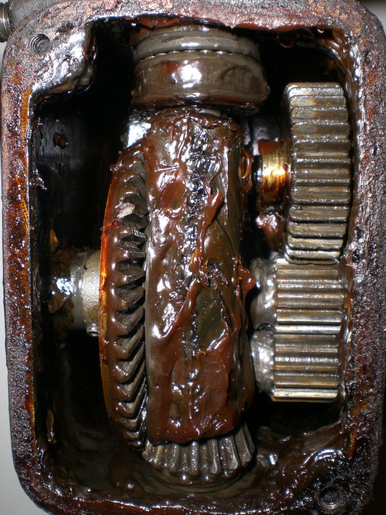

                                              #68137
                                              Nicholas Farr
                                                @nicholasfarr14254
                                                Hi Steve, please give me two or three days for more photos, as I’ll be a bit tied up, if I get the chance towards the middle of the week, I’ll strip this one down and clean it to get a better view of things. However I have taken the front cover off and taken a photo of the inside.
                                                The driving mechanism is fairly straight forward in that the drill spindle is driven by the bevel gear at the bottom which is driven by the crown wheel on the left hand side, this in turn is driven by the middle shaft running left to right, which has a small gear on it on the right hand side. The bottom shaft on the right hand side also has a small gear on it with which it meshes with the middle shaft. This bottom shaft extends out of the right hand side of the case, and is the slow speed one that the operating handle is attached to. The top shaft on the right hand side has a larger gear and is like wise extended out of the right hand side, and is the fast speed one that the handle is attached to.
                                                The drill spindle is all one piece on these type of machines and a threaded portion passes through the fly wheel at the top. They work on a kind of differential friction, and a sort of feedback pressure from the piece that is being drilled. They have, apparently. got the tendency to break small twist drills, because it isn’t possible to reduce pressure enough to stop the drill from pushing downwards during drilling, However, a guy by the name of E. J. Szlumper came up with a solution to this problem, in which he wrote an article about with a design that he describes in The Model Engineer April 1939.
