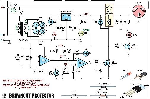

      Hi,
      This came up in a recent EPE magazine, a brownout protector for induction motors..
      So, it explains on the page briefly what it's all about..
      "Brownouts occur when the mains voltage drops to a very low level, say below 100 VAC and this causes incandescent lamps to be very dim (hence the term) or "brown". But as well as making your lights go dim, brownouts can cause induction motors to burn out because they cannot start properly."
      They go onto explain that these used to be quite common in rural areas when power lines had very long runs and a happenstance falling tree or animal might cause a drop in voltage, and end up putting too much amperage through your motor, however they have become more common in urban areas now where the electricity grid runs close to capacity.
      Anyway, i'm wondering how useful a device could be to protecting an induction motor in a suburban workshop, or even an inverter-fed 3 phase motor?( I presume an electrical reactor here would be more useful for stabilizing mains AC single phase supply.)
      I occasionally notice lights flickering in my house, but I presume this is due to an intermittent drop rather than a full-on brownout so to speak. Which I have no memory of ever occurring.

                it looks very like the circuit from Silicom Chip Magazine in December 2008 !!
                silicon chip magazine brown out protector  issue 243  published 8 december 2008.jpg

                        This project originated in the Australian magazine 'Silicon Chip' a few years ago, and was updated recently. The main worry is burning out the start winding of induction motors if the voltage is insufficient to allow the motor to speed up enough for the centrifugal switch to disconnect the start winding. This type of motor is usually rated for so many starts per ten minutes (or similar) for the same reason – to protect the start winding from overheating.
                        In NZ, and the primitive offshore island to the west, power lines, especially in the rural areas (rather a lot of them…) are above ground. Whenever we have strong winds here, trees come down, often across power lines. We had an impressive brown-out here, a few years ago. One phase failed. Unfortunately, that was the phase supplying the power to the house. Because of parasitic coupling, there was a variable voltage on the live line, between 90V and 130V, if i remember correctly. Freezers, 'fridge and water pump didn't like it at all, but I don't know whether any of them were truly at risk – I don't know what type of motors they have. The really impressive thing was the strange strangled squealing noises coming from the electricity meter(s). I pulled the main fuses.
                        After that, I thought I'd make up a couple of Brownout Protector kits. They are kitted by Altronics, in Oz. Perhaps unsurprisingly, they are not stocked by the NZ distributor of Altronics kits. Kiwis are risk-deniers… I'm not, so have a stand-by generator!
